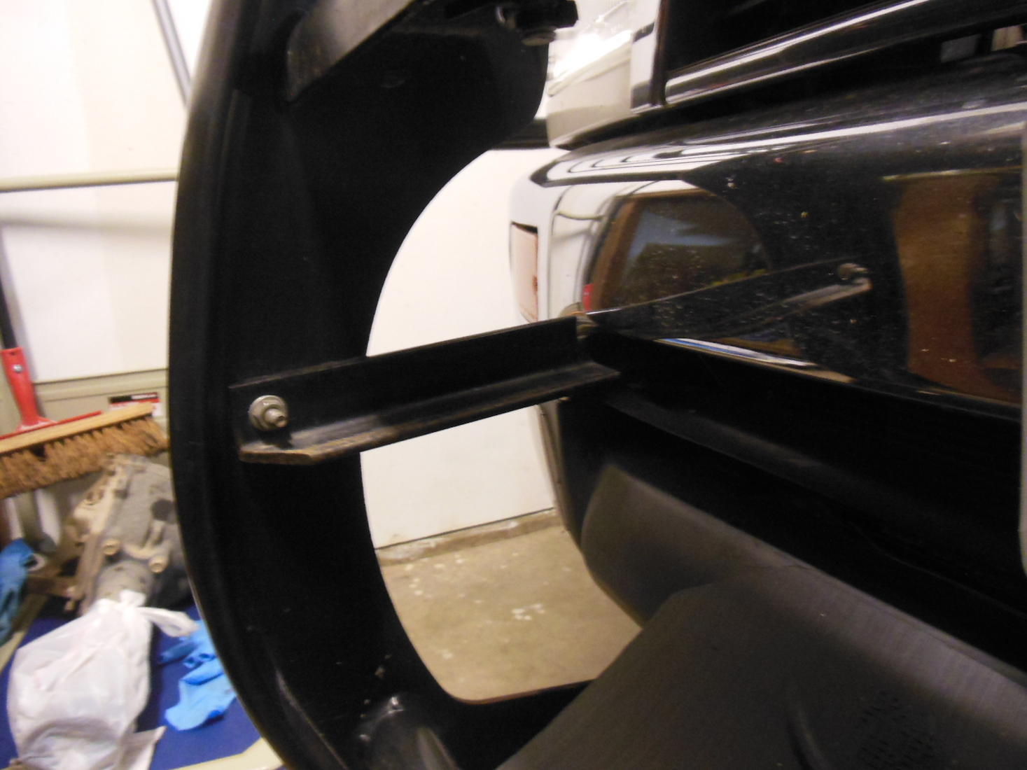

I ran two 1/4 inch thick 1.5 inch wide L-shaped metal bars through the lower valence to the front body mounts. The thing won't shake a bit after that.

Here you go
Could you post some pictures if you have any? It would really help
Pictures
2nd: Notice the metal bar that is running about 10 degree angle to the frame. I have two of those going to hold the grill guard.
Ohh so you got new brackets and replaced the other thin and bad ones? So you didn't mount a total separate new bracket. People say I could weld and stuff but I'm looking for a cheaper alternative
All I did is took two 18 inches long metal bars and attached one end to the body mount and the other end to the guard.
