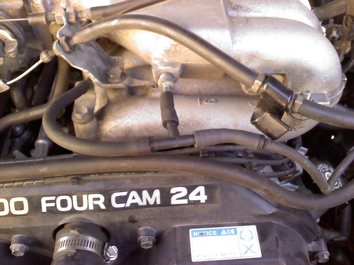

I didnt think that picture posted. I recently did the ISR mod, and wanted to make sure I re routed the hoses correctly. The instructions left me somewhat unsure. How does that look?

Brian2sun, ya the hose off the t isnt pushed all the way back cause it wasnt long enough and i didnt wanna buy any more hose haha. The t is butted up against the valve coming out of the intake plenum. But it is tightly sealed on every connection. I'll probably end up getting some hose to make it look nicer anyways. But my concern is if I placed the hoses correctly.
