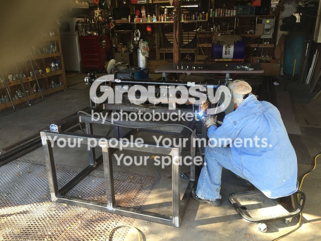

Looks great, how many hours has your uncle put in?
Just as many hours as I have. He has been super helpful with the welding and letting me use his shop.
We have been working for almost 3 weeks with about 3 hours a day, 4 days a week give or take.
