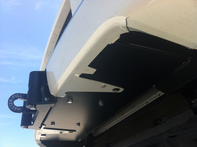

I didn't post on this earlier because mine was the original prototype and attaches completely different then what is being sold now and wouldn't have helped. On mine,I had to drill holes vertically thru the bumper using 12" long 7/16"dia. drill bits stepping up from 3/16" dia bits in increments for the bolt holes.Bolts up thru the aluminum bumper in 4 places plus bolts up thru to the winch.
Bud and I both felt this drilling is outside the realm of the typical shadetree mechanic as I had a extensive sheet metal background and it wasn't easy, even for me.This extruded aluminum bumper is pretty hard to drill and keep a straight hole thru something that thick.Thus he came up with the U bolts.
Mind you ,that it still bolts to the end of the frame besides the aluminum bumper to get it's real strength just like all the aftermarket bumpers.

what rating or those damn ubolts?:lol: that winch is gonna rip right off first pull
Ahh.....The winch is bolted to the plate which is bolted to the frame down in behind it also.
I guess you didn't read the post and just looked at the pictures.

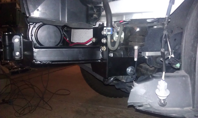

I was looking at going the BB option but decided to work with a company called UndercoverHWMS, they have built hidden winch mount systems for Fj's and tacoma's for a while and I heard some great things about them. The did some mockups over the last few months and I got it installed last night.
The install process was pretty easy, the concept is awesome looks very strong and reliable!
According the the guys they will be for sale in the next week on their website. Sorry for the crappy pictures, I plan on taking some better one soon.

It looks good, but does it really replace the stock aluminum bumper that is (im guessing here) approx 5 ft long with a winch plate that is like 3ft maybe,and leave you with no real bumper protection outside of the frame dimension?
