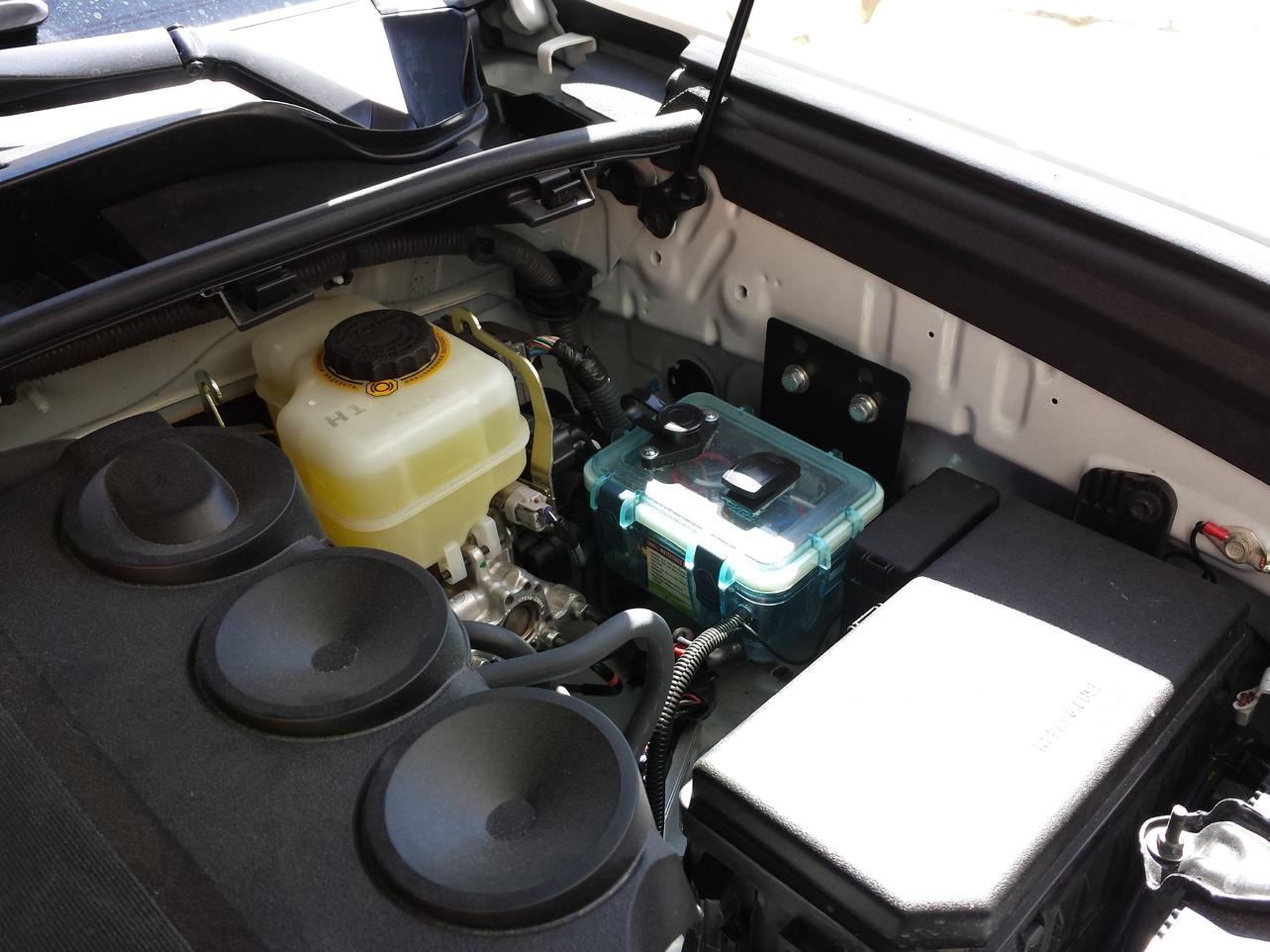

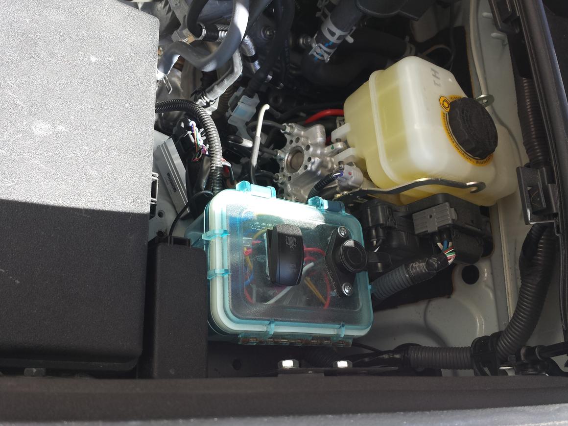

Not specific to the bumper, but it's very easy to remote the control plug to somewhere inside the hood or anywhere else you'd like. You don't need to extend the heavy cables. Just the signal wires. This is where I put mine - I used a waterproof box to house a master on/off switch, the remote plug female adapter socket, and the wireless control box with relays for wireless operation. It mounts to a small bracket I made that bolts to the inner fender welded nuts that were available.
151561d1427756684-2015-tep-hidden-winch-build-install-img_20150320_123817-jpg
151560d1427756670-2015-tep-hidden-winch-build-install-img_20150320_123824-jpg
Dude, very clean. Thats a cool idea. I have a quick connect plug on the power cables so no need for a switch. If I can find a simple way to relocate the connect, I'd just do that. Your idea is pretty clean as far as getting the plug to sit in that box. As far as location, my air compressor is in that space near the booster. Since I may get away with just using a little box, find a location should be pretty easy. Thoughtful. Thanks
