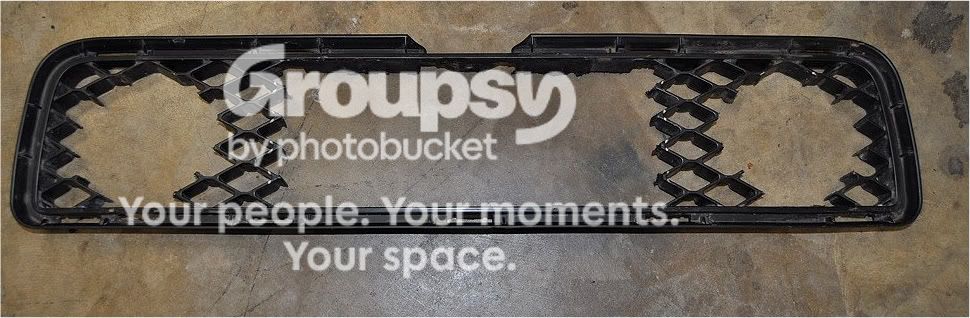

It ties into the front of the frame on each side with existing bolts and will also bolt to the front aluminum bumper. The lower grill itself (not shown in the pics) will have to be cut out of course to fit the fairlead.I have a roller fairlead on mine because I'm attaching my front license plate to it ,for a stealth look,but he will have a version set up for a Hawse style fairlead like the Master Pull fairlead in one of the pics below. I have polyurethane rollers on my fairlead for a synthetic rope.

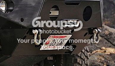

I agree, it would be nice if a version of the budbuilt winch plate would have 2 recovery points sticking out of the side of the grill to install shackles.
I was thinking of that too but it's going to be a separate mod.Too complicated to do it with the winch plate now. I want to have steel recovery points coming off the main frame coming thru the front bumper plastic that we can hang shackles off of for recovery points.It is going to take some intricate custom work for the holes to be cut out in the bumper plastic. That ABS plastic is some tough stuff and pretty hard to line up exactly where you want to cut out.
Like MrGrimm's Taco recovery points here but just have them coming out holes cut in our bumpers going back to the frame... and then attach shackles.

Trimmed lower grill
