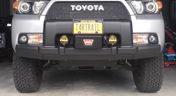

Budbuilt makes a mounting brackets that attach to the winch mount for lights. I'm running an Odyssey 34R Extreme Series Battery. Control box is mounted on the top side of the winch, but I also have warn's wireless remote that I attach for use days. This is control box is installed the same way as it looks in [MENTION=6163]phillyd2[/MENTION] pics above.
To clarify, the first picture above was the original BB mount with a 8K winch. The others are the newer version with light mounts and I also upgraded to the Zeon.
This is how it sits today
Instead of separate light mounting brackets, it comes with holes to mount the lights.

Why did you remove the hook from the line, any advantages/disadvantages? And did you paint your fairlead black?
