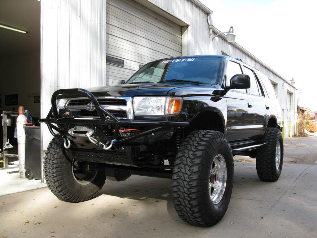

It was Scotts old rig from Addicted offroad. He mentioned how it only had a 4" total suspension lift on the 37's for a low COG. You can see from the pictures not much lift on the rig. Not sure on the up travel but from what he said it performed great offroad.
Thanks for the info. Wonder if he meant 4" of lift and then 2.5" of height from the 37s vs. factory 265s. That would make sense as a 22" frame rail height equates to exactly that.

The thread he mentioned it was a thread about how much lift is needed for 35's and people questioning COG. He chimed in stating he only had 4" suspension lift. I never heard of someone accounting for tire lift when mentioning suspension.
That being said here are the specs. He sold it long time back but recently posted that the truck will be for sale again.
