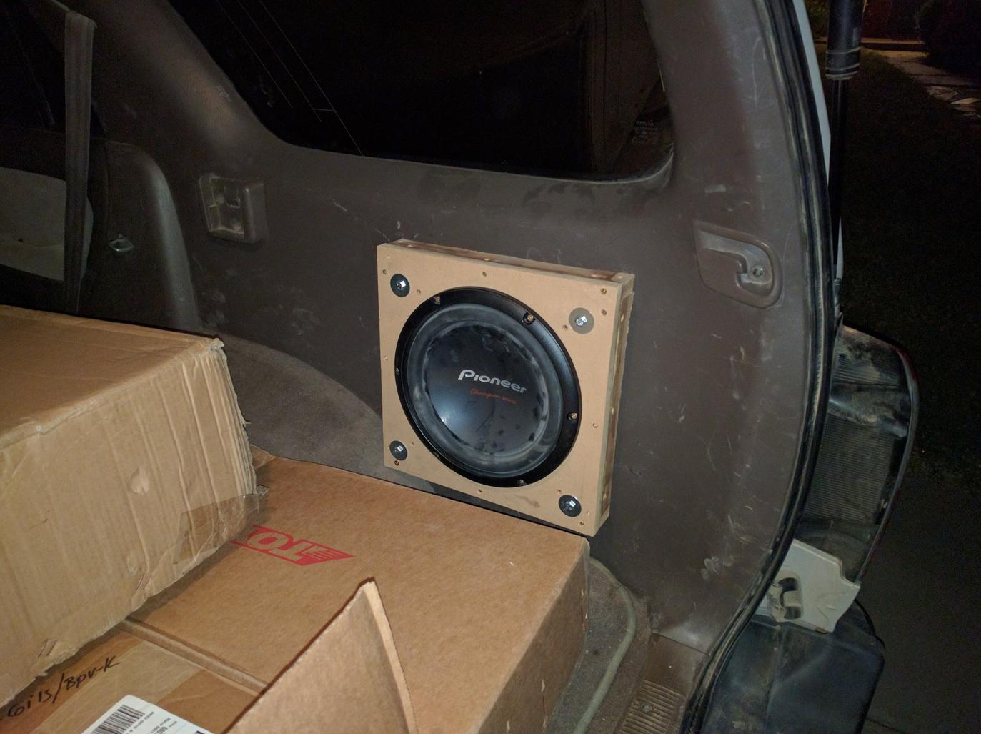

Regarding your audiophile status - maybe some advice? I'd love to get some more bass going on but don't want to sacrifice a ton of room in the back for a sub (planning a bed buildout). Are subs under the front seats a good option? What should I be looking for/at?
Thanks in advance [emoji1365]
There not a bad option. Lots of guys here use them. I don't and never have so I can't really comment on what ones to look for but I'm sure some other can. Here's a shot of where I placed my 10" Pioneer. It protrudes about 1 1/2" and I could easily build a sleeping platform around it. That sub SHOULD have the grill but I lost it in a move. Since your doing a lift tomorrow look closely at the brand name on the boxes in the photo. I've been exactly where you are now a little under a year ago. lol
