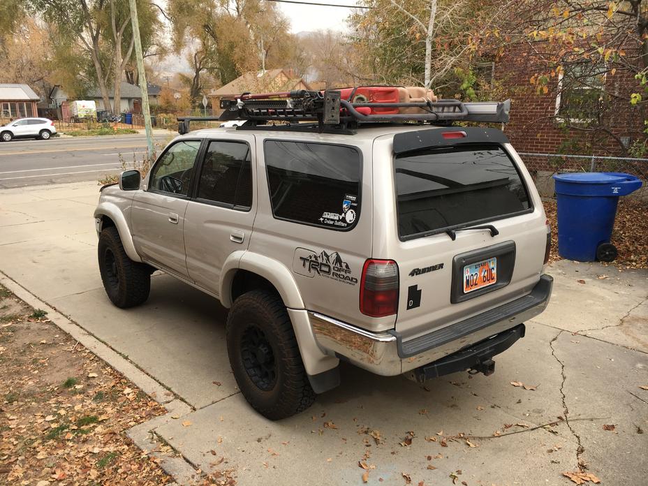

RACKTION. Check this out - sold my cargo area cover for 70 bucks and picked up the bike rack for $75. Grabbed the Rola Rack off of a local high schooler with a dope 2000 SR5 (go figure) for a steal as well. Did some sticker removal and application.
Already had some bikes on there (forgot to take pics) but dang it looked badass.
Stoked on the cargo rack because now I can get my jerry can and firewood out of the back and keep my interior smellin' less like a gas station and lookin' less like a lumberyard.

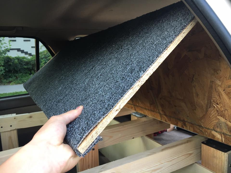

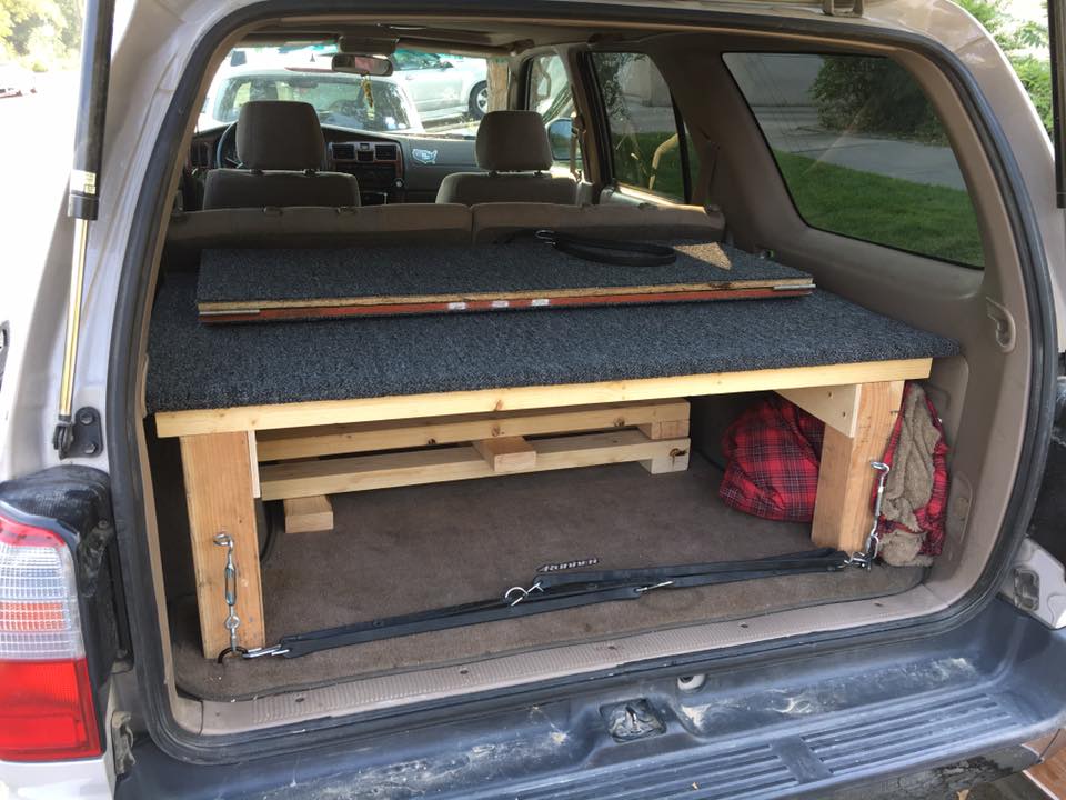

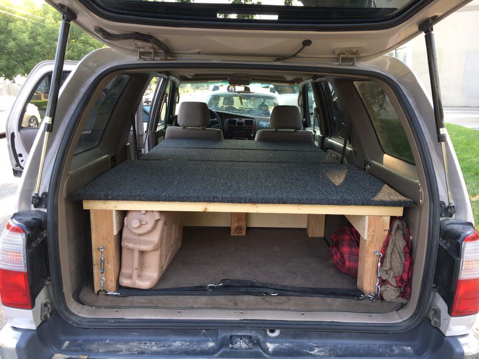

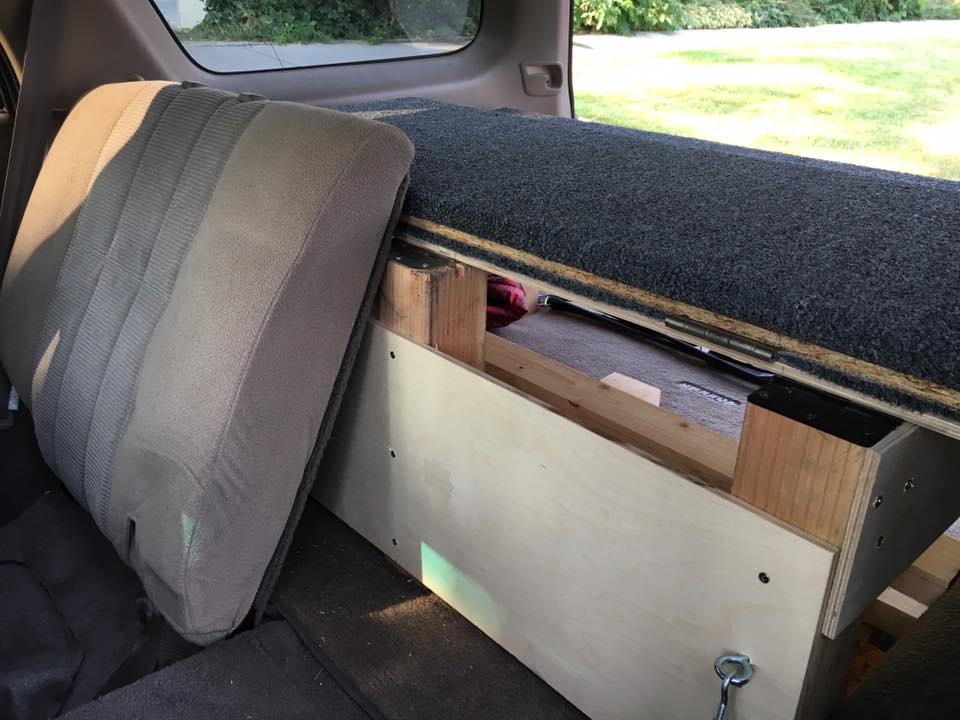

Bed Build

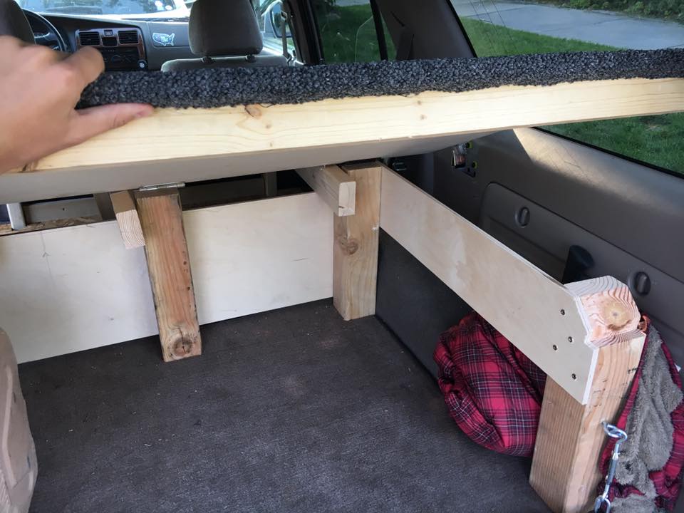

Had access to free wood and a table saw for the weekend. Dropped $17 on hardware and now I can sleep in the back of the 4runner!
Requirements:
-Still need my back seats to carry the homies
-Can't be too heavy
-Needs to be longer than I am tall (6'3")
-Needs to be secure

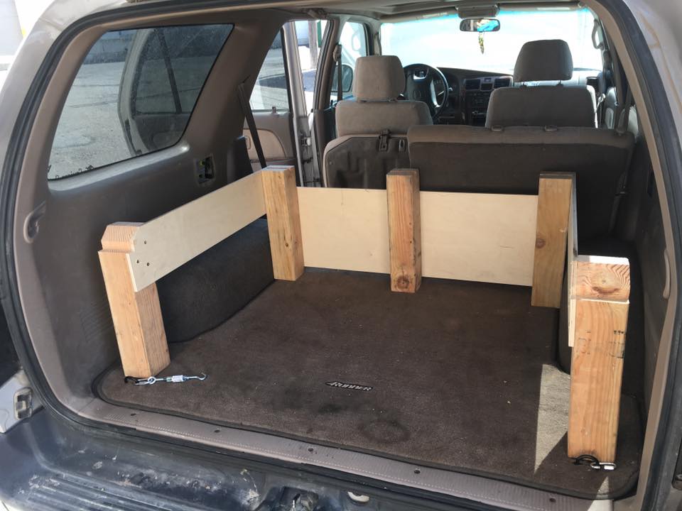

Those things in mind I got to work.
Basic frame - 4x4"s for maximum support.
Hinged lid because I don't want to have to dig around stuff to get to the deeper goods
Fully folded out

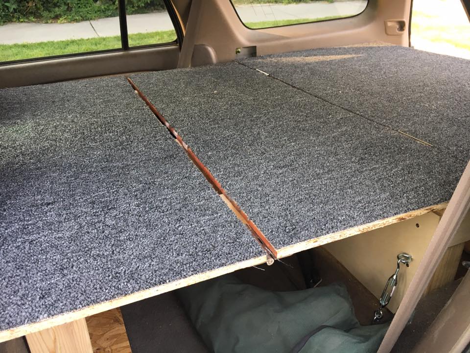

Fold action here (basically makes a Z shape as it folds back) You can also see here that I have some arms that come out for the folding piece to rest on. These are removable and just fit the tolerance between the back section and the flat divider there. They are modular and stored in the back when not being used. Albeit not the most elegant solution but it works so far.
All folded back and tidy
All in all pretty simple build... not worried about making some big fancy thing with a fridge yet, just nice to be able to sleep in the back for quick trips and pit stops.

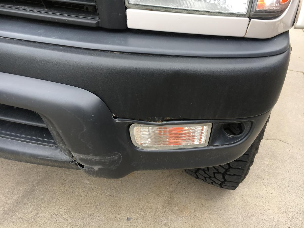

Got in my first accident - on the freeway of course! While making a headcheck to change lanes a rear ender happened in front of me and I couldn't stop in time. Minor impact - airbags didn't go off. Small damages to both vehicles so we just decided on a small cash trade to fix each other's damages. Pocketed the cash and used it as an excuse to paint my front bumper. Eventually going to be making my own so I'm not too worried about it.
Ended up using plastidip because I had some laying around. Surprisingly has held up quite well for the past 4 months.
You can see here the small ding in the front.
And plastidipped black...

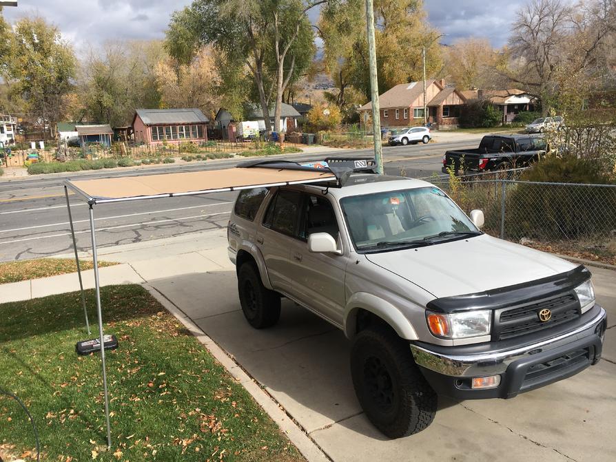

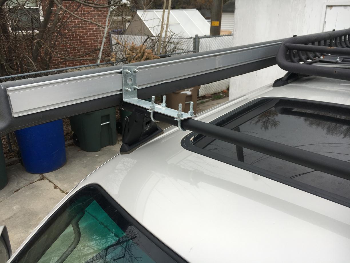

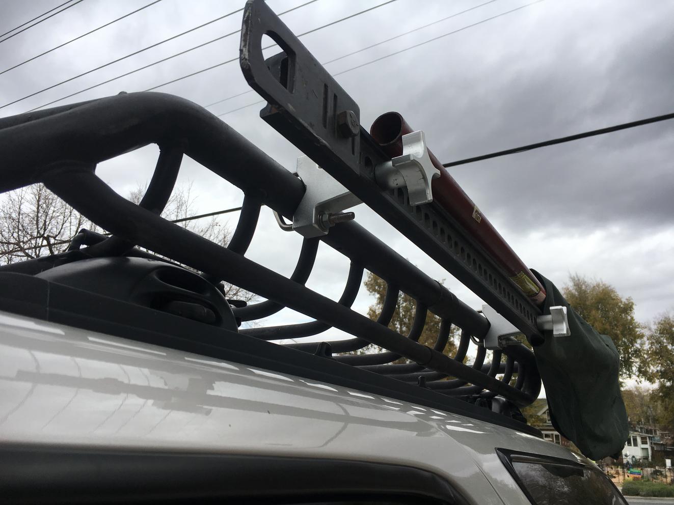

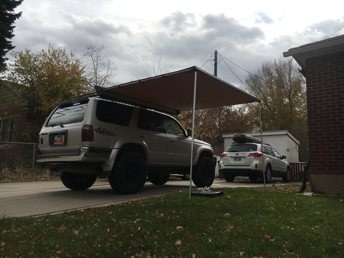

Friend of mine hit me with an awesome Christmas gift - his ARB awning off of his 100 series Landy! It's quite long and I couldn't mount it every three feet like ARB suggested so I snagged a Yakima Q tower setup and made a quick trip to Home Depot to get it mounted before a trip to the desert. Pretty quick and dirty solution but it is getting the job done - looking to make a full rack in the future so this will do for now.
My buddy even tossed in a Hi-Lift mount... no more bungee straps!
Next project - rear bumper! Tire swingout and all, weighing options at the moment but it seems [MENTION=55891]Bandit Runner[/MENTION] might have what I'm looking for. Time to get those jerry cans off of the roof!
