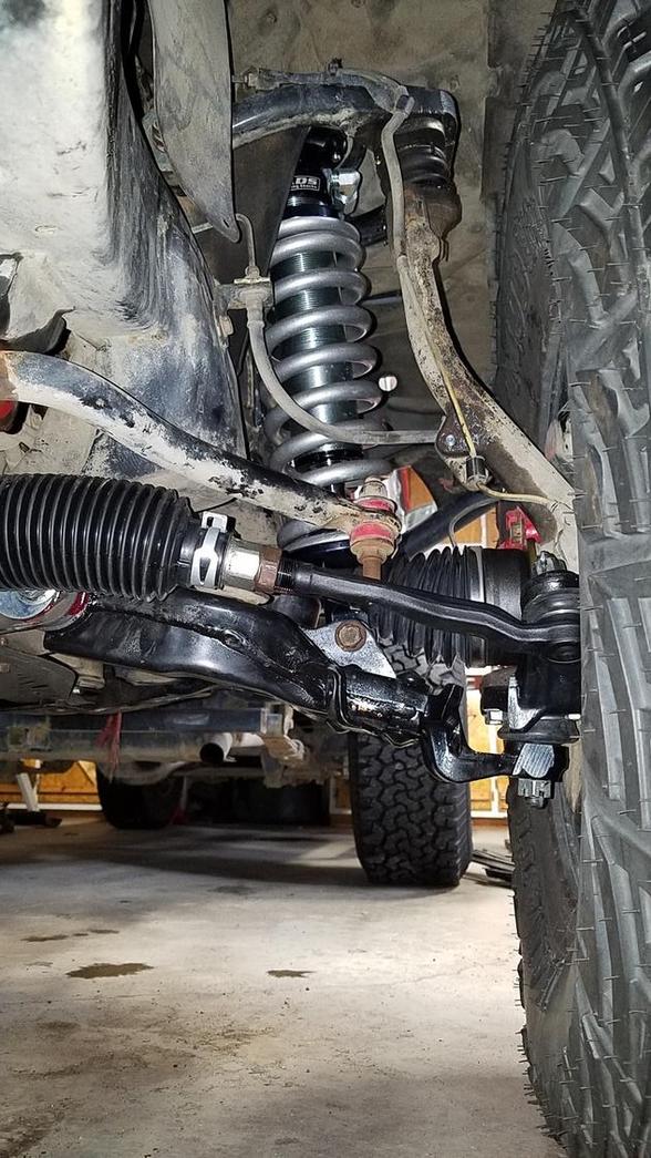

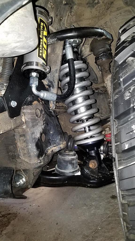

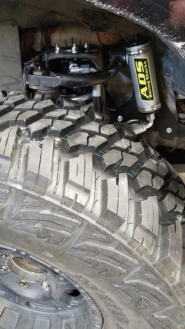

The neatest thing was the installation of my ABS Shocks!! My whole front end is getting worked on, but I had some time so I got these put on before hand. They ride AMAZING!!! I hit a short cross country trail here in town to test them and drove through parking lots looking for speed bumps. Again, amazing feel. Can't wait till the rest of the front end is done. Wish I was doing it myself, but I just don't have the time right now.:sobbing::sobbing:

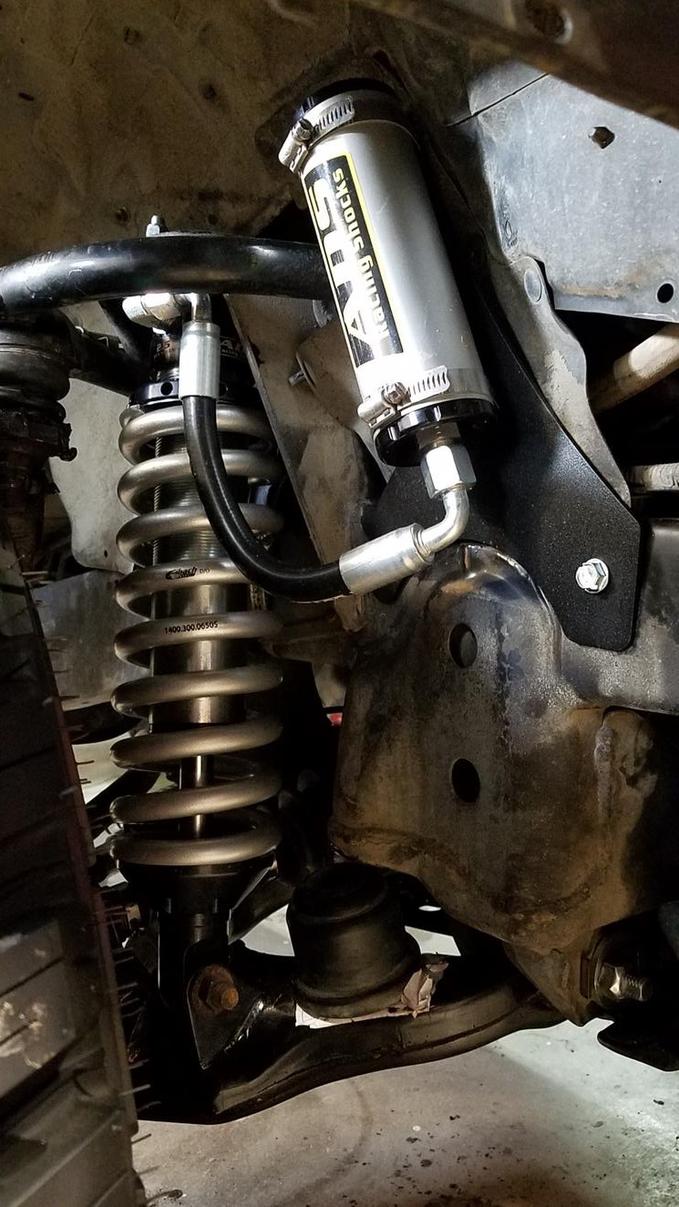

Looking good! I still haven’t installed my coil overs yet. How difficult was it to find a spot to mount the resi’s? Did you use the supplied bracket?
[MENTION=28808]psraff[/MENTION] Do you know how much lift you have over stock, with the new ADS coilovers? Did you adjust them at all before or after installing them?

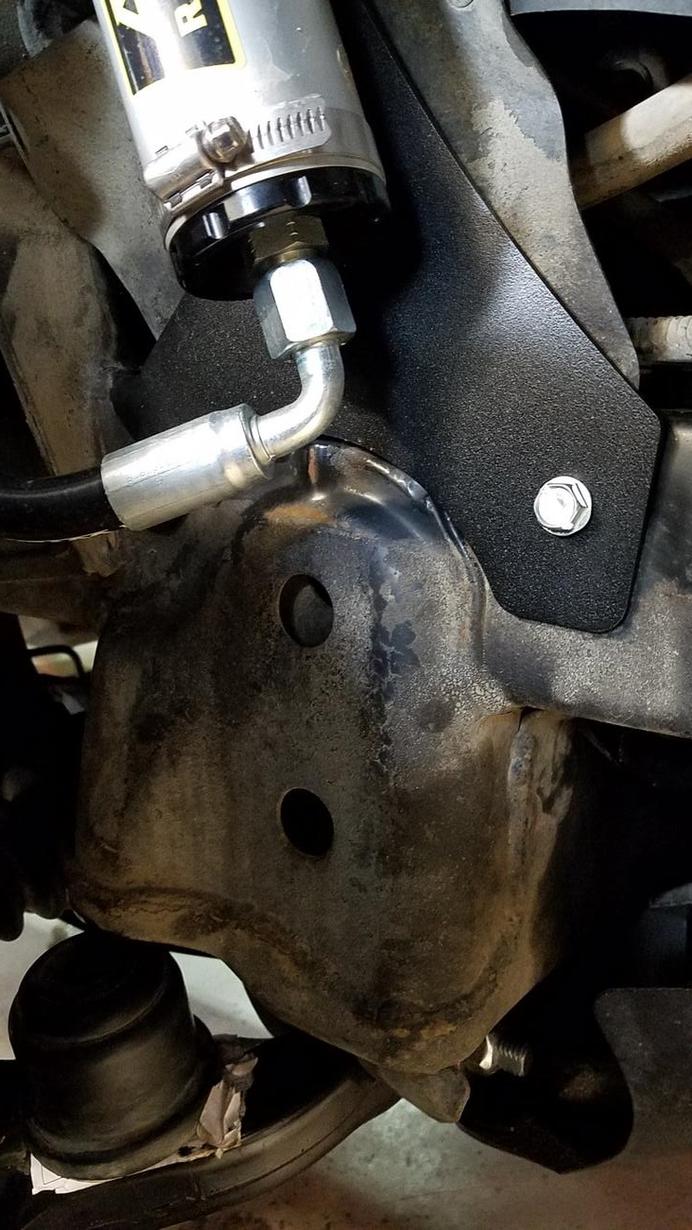

There's only one way to mount them really. I couldn't find pics anywhere so I texted SQR-Fab and they sent me a couple. I'll post pics of mine, but there's two holes already in the frame and you just raddle gun the supplied hardware in them to hold the bracket in place. It was supper easy. Only concern I have is I have an 1 1/4" BL. Without it, I "Think" the top of the bracket would rub the wheel well.
I took some measurements before and after (but I should've wrote them down). I was thinking to myself, "Oh, I can remember this!" Yeah, right. I'm a bit lower in the front then I was before with my 881s, but I was going to let them ride a bit before adjusting them. Though I'm thinking of doing it this morning because the truck was in the shop longer then was expected, and now my alignment may not get done will Monday!!! Really sucks! I'll get measurements again and post all of this and pics.

Pics shows how the bracket is mounted for the resi. Very quick and simple.

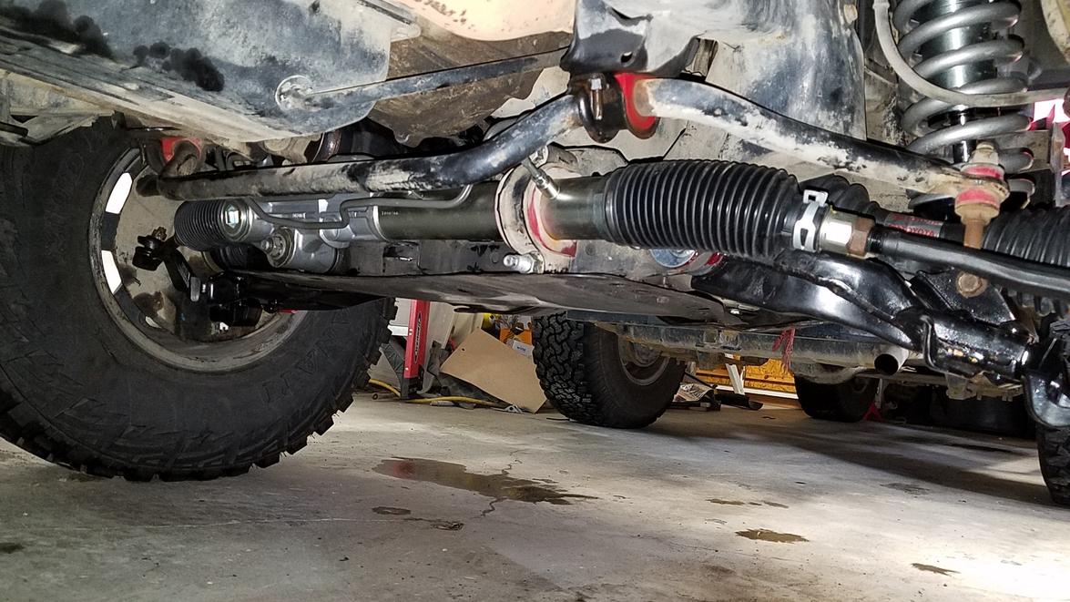

MOOG Cambolts seem to be a bit too long (not sure if they all are or the ones with the grease zerks. They were cut shorter to not rub the boot.
Right now my breaks feel soft. The rears were adjusted and bleed, but the feel is different. Tech said he worked about a pint of fluid out with no more air (on the rears). Fronts were never disconnected. I'll have to review this a bit.
Toyota sent me one wrong Tie-Rod so I had to reuse the old one (which is still good), but still irritating. Also was missing one CV bushing so I have a Car Quest one in there. Only option I had.
Drives great even without an alignment. Hope to get it in this afternoon, but it doesn't look good. I'm sure it will be Monday Morning.... :cry::cry:

Thanks for the info and pics! I’m hoping to get around 2.5” or lift with the new coil overs. Sounds like you got a little less than that?
Dang! You've been busy! I want to see some pics of the overall rig with all the changes. Does it feel much different with the bigger tires?
No problem!
I'll get that measurement today from hub to fender. I need to keep it in my notes to keep track of it anyway.

Just measured, and I came up with 24" from center of Hub to Wheelwell (no flares). If I remember right, Stock is 20" to 21". Correct??
Just for the fun of it, I measured from Hub to the Floor (16 1/4") and subtracted that from the 40 1/4" and you get 24" again.
FYI: My tires are 33 7/8" while at 28 psi (Kind of surprising...).

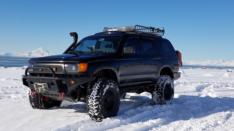

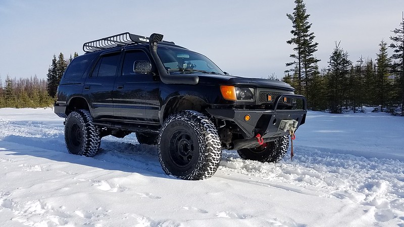

NICE! That's more like it. That thing has morphed into quite the beast. Great pics. Have you trimmed / tubbed enough to fit the new tires? Or will you not really know till it's aligned? :tea:
No trimming yet. The most I've done was fold over the pinch weld. I wanted to wait till after the front end work (and you're right) the alignment. I go back to work in a day so it's not going to happen this time around.

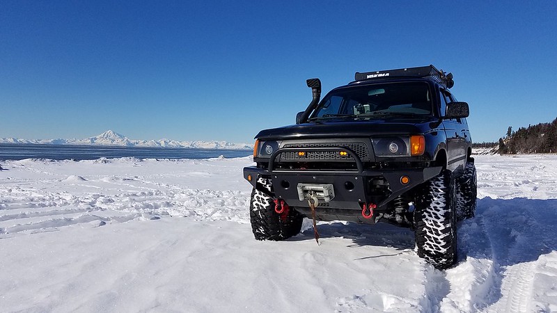

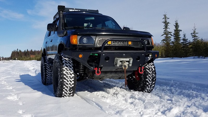

The lights and bumper look great together. Thanks for sharing these pics.
Glad people's liking it. Can't wait to fix the bumper!
Dope pics! Really like your take on the Satoshi Grill, is the front bumper custom?
SRQ-Fab does the grill. The bumpers are CBI.

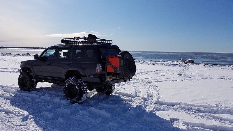

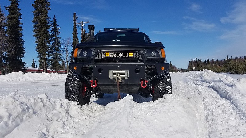

Great day to get a few pics....
I know you mentioned getting out of AK in the next 3 years or so... I'll bet you're going to miss seeing sights like that once you're gone. That's a cool shot.
