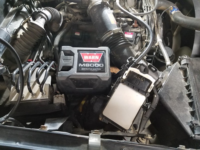

Got as much prep work done as I could with the fitting of the Grille and the Winch so now was time to start in on the fun stuff.

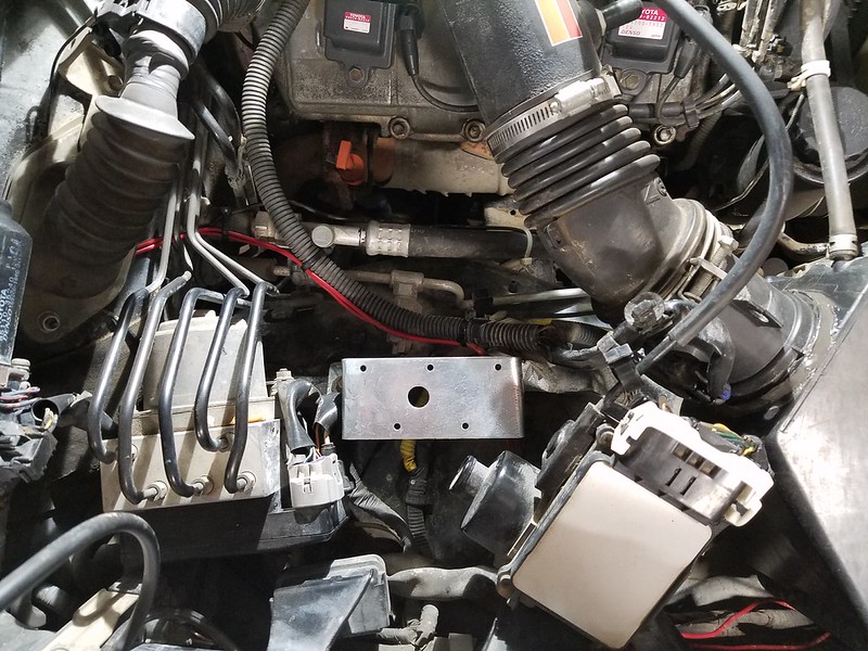

Fabbed up a bracket for the Winch Contactor Control and got it test fitted.
20170928_163102 by psraff, on Flickr

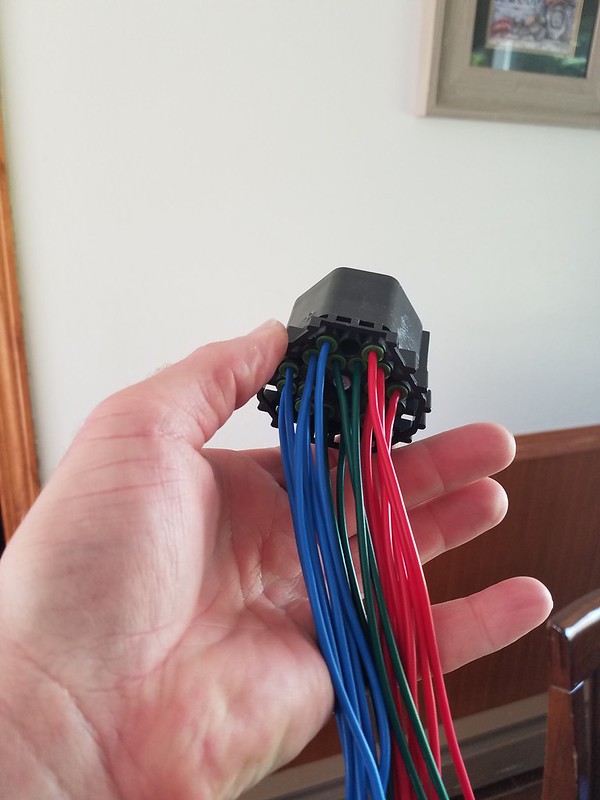

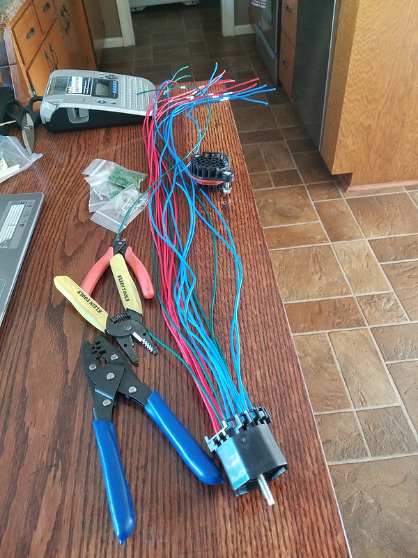

Then it was time to start making holes for all the wiring that I'm been designing in my head for the past few weeks. First, wiring up the bulkhead fitting.
20170930_133911 by psraff, on Flickr
That's 7-Reds, 7-Blues, and 4-Greens. Don't have a use for them all yet, but since I'm doing it, I might as well make a few extra.

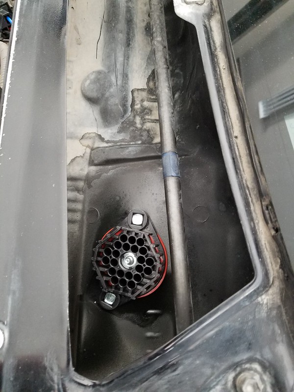

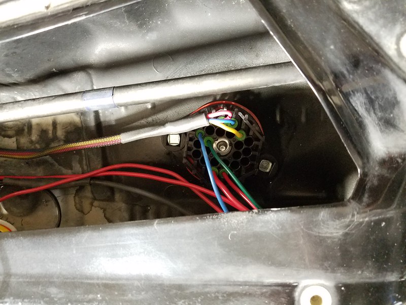

Bulkhead Fitting in:
20170930_165401 by psraff, on Flickr

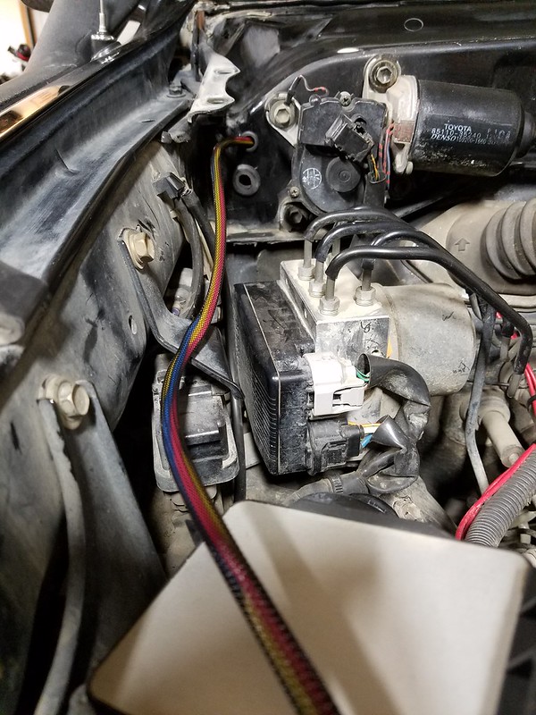

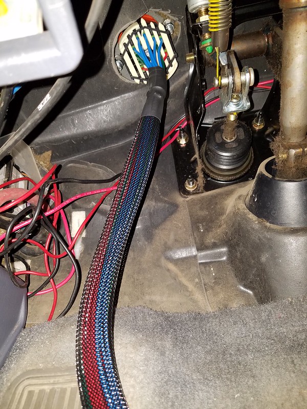

Backside with my wires and Snakeskin over them. Yes, that temp wiring is going away, and the Snakeskin will be pulled tight on the other end when I'm done:
20170930_181847 by psraff, on Flickr

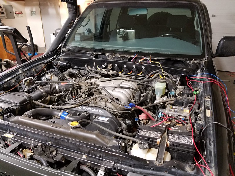

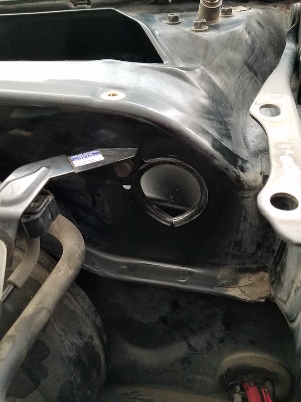

Hole for all the wires to enter the Engine Bay:
20170930_165353 by psraff, on Flickr

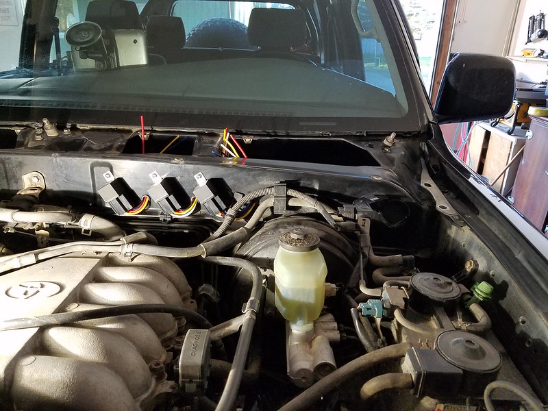

Relays:
20170930_180750 by psraff, on Flickr
Tomorrow, I hope to run the 2AWG from the Battery to the Contactor Box, and get the Relays wired up and documented. That way I can put the truck all back together and the rest should be able to be done with the hood on.

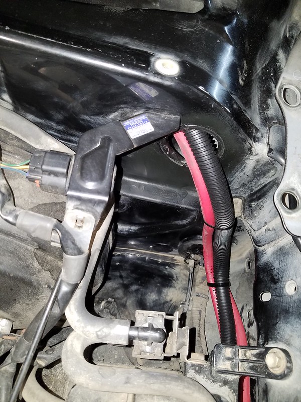

Day Two, didn't get nearly enough done. Turns out I didn't have enough 2AWG to get from the battery to the Contactor so that really shifted my work scope some. Plus side, is I did get the other two relays fit in! Right now I have one wired up for my Tranny Cooler Fan. I'll use another for my Lightforce if I decide to put them back on (which I probably will)(DAMN, Need to buy another switch for them! Totally forgot!).
I was going to use one for my horns, but since they came with it's own, I was just going to clean up the wiring and move that one from it's location (you can see it near my dist. block) and hide it somewhere. I'll use these new ones for more important items.

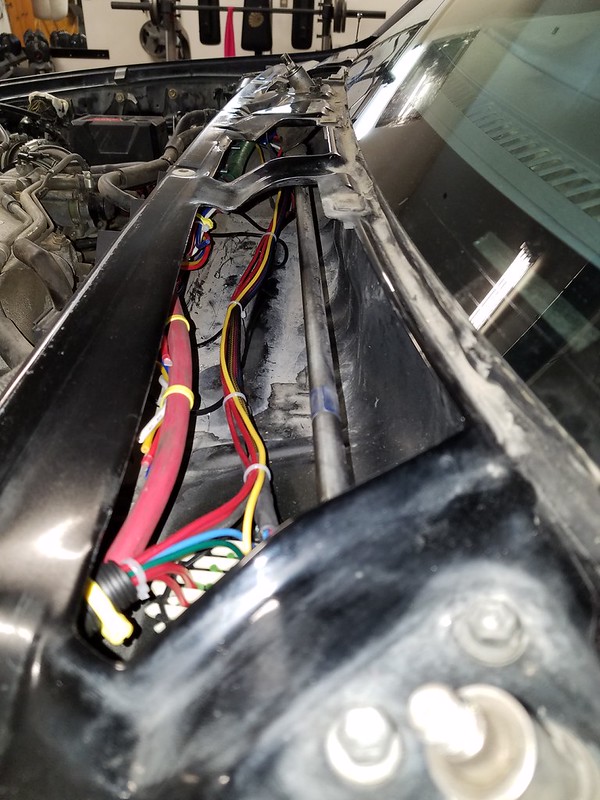

This is how I'm routing the wiring to the Contactor Control Box for the Winch:
20171001_165802 by psraff, on Flickr
Organized Chaos right now. Once I get the 2AWG fed through I'll get it all organized.

Starting to plug into this side of the Bulkhead fitting.
20171001_165915 by psraff, on Flickr

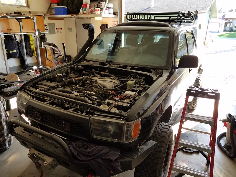

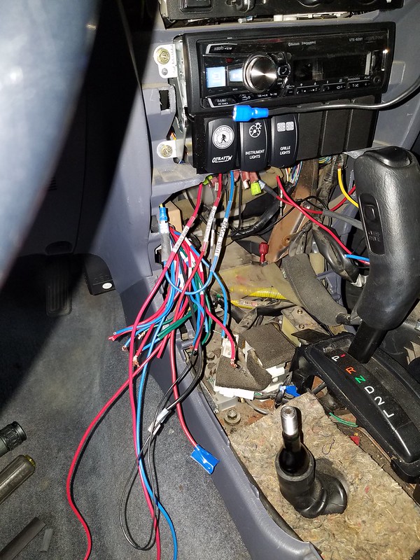

Also tore out the rest of the temp wiring and my dash is taken apart as well. Since it turned out I wasn't driving it tomorrow I figured I might as well keep getting the little things done.

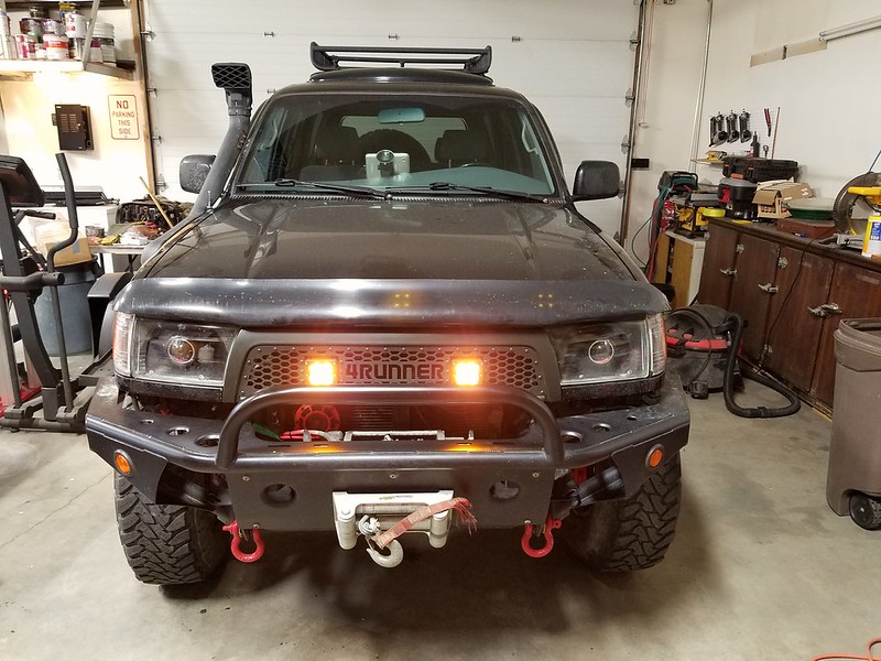

Besides a few last minute things to take care of, this phase is complete!!! (Yes, I know.... Bumper needs to be raised. Shut Up!)
2017-10-07_02-55-17 by psraff, on Flickr
I did end up cutting the back 5/8" off of the light pod on the drive side due to my tranny cooler and fan. The pods still stick out, so it's not 100% complete yet but at least they are installed and functional.

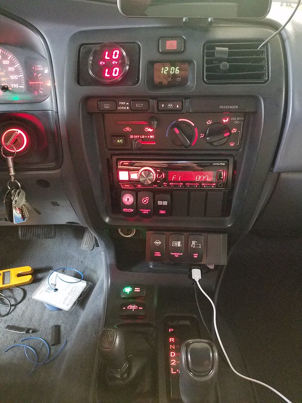

Switches are all wired up except my second winch control. I ordered the wrong one. I have the correct one on the way already. Note, to install them there you do have to move some wire harnesses around to get them to fit.
20171007_120706 by psraff, on Flickr

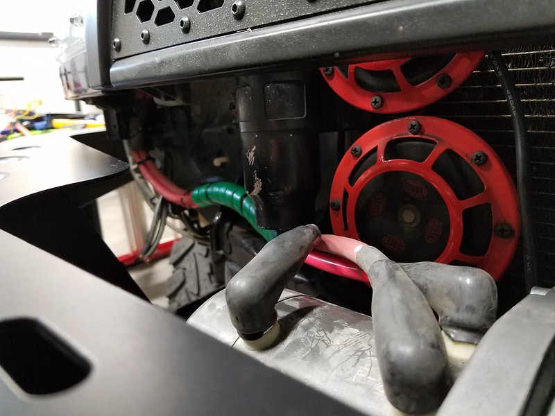

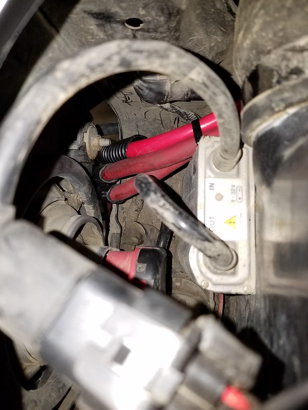

New Cables from the Winch:
20171006_071458 by psraff, on Flickr
20171006_071508 by psraff, on Flickr
20171006_072005 by psraff, on Flickr
20171006_071906 by psraff, on Flickr
20171006_202601 by psraff, on Flickr
Any tight areas I put heat shrink on the cables to help protect them. And it's not the shrink you get from your local Radio Shack....
20171006_072102 by psraff, on Flickr
My Harness was the perfect length!!! You would've thought I knew what I was doing! :shocked::shocked: I just did a rough measurement and added 6 inches....
20171006_224925 by psraff, on Flickr

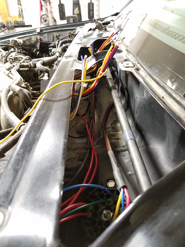

Wiper Area Cleaned up:
Note: The Actuator that works the wiper arms is at an angle. Because I have my cables \ wires leaving that area so far down towards the passenger side, that rod "taps" the 3 wires that's going from the Contactor to the Bulkhead Fitting. I do have them wrapped, and they aren't getting rubbed. It just barely taps them. I fought it for about 40 minutes moving them one place to another, zip tying them but no luck. I'm not worried about damage. It's just the Electrician in me that won't let it go.

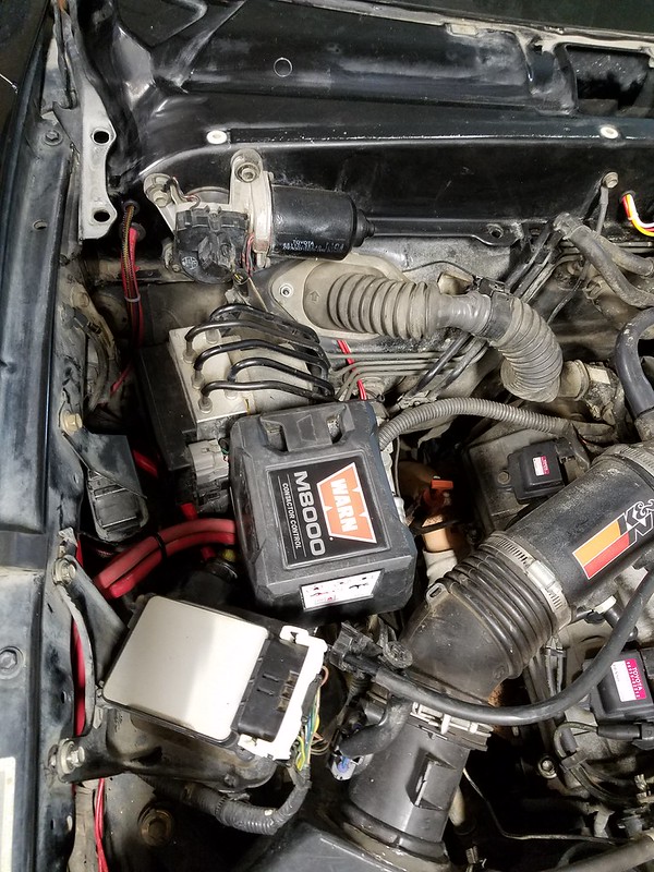

Got the correct switch in for my Winch and have that wired up. One more little project wrapped up nice and clean.
Note to self and others:
In the Warn 5 Wire Contactor Control Box, Green Wire is for the Winch to move out. White is to winch in. Brown goes to an Incoming Post on the Switch.
You need to use Switch Type VLD2UxxB ('xx' is the number showing LED color)
http://www.otrattw.com/wiring/VLD2U.pdf
Picture I used to help reference the wiring (from Tacoma World):
http://www.tacomaworld.com/gallery/showphoto.php/photo/368452/cat/500
Bulkhead Info (Useless babble for everyone except for me):
Blue 1: Blue Winch to Contactor Green
Blue 2: Red Winch to Contactor Brown
Blue 3: Yellow Winch to Contactor White
Blue 4: To Transmission Fan Relay
Blue 7: Winch Switch PWR
Red 1: Switch PWR
Red 2: To Grille Lights
Red 3: Front Locker Solinoid
Green 1: Switch Ground

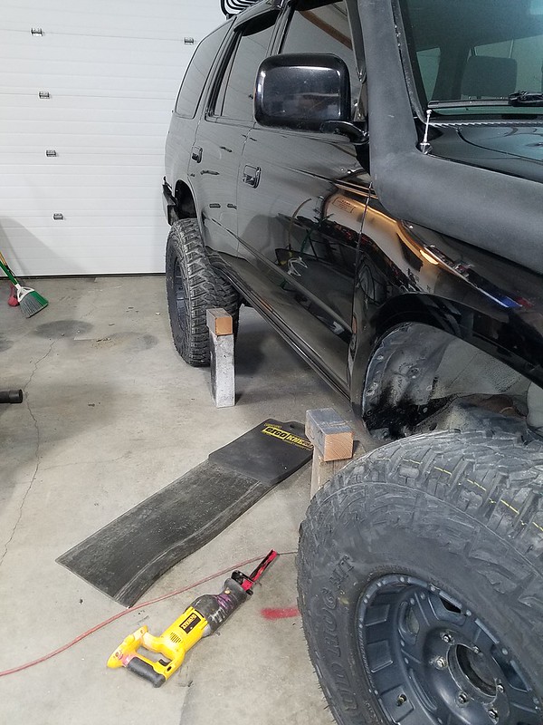

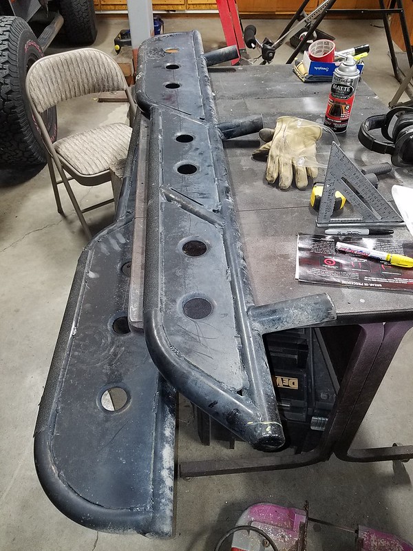

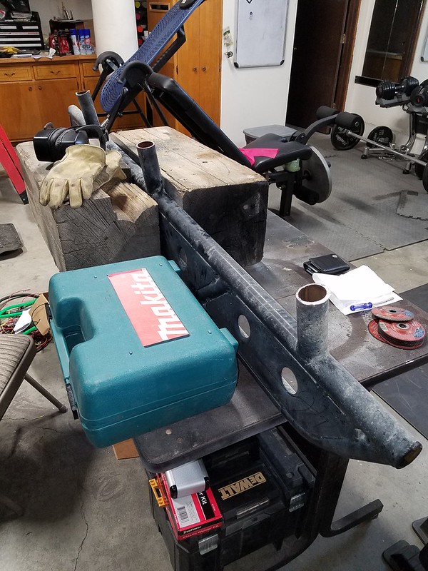

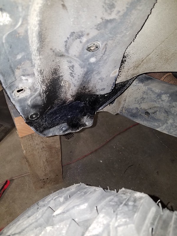

Worked on the rubbing issues from the front tires over the weekend. Not going to deal with the flexing or off road aspects of it yet. Winter's coming and I don't plan on doing much anyway. My main concern were my sliders and my pinch welds. I'll order my washer fluid bottle kit in a week or so. Got the pinch welds rolled over and hammered down. I made the mistake of cutting the plastic on the first one so I got my handy plastic welder out and welded it back together! Also with a heat gun got it all flattened out.
20171022_131922 by psraff, on Flickr
Next were the sliders. Took the measurement to retain what I needed and for what I need to change. Got them cut off, and the pipe cleaned up. The OD is 1 3/4" so I plan on getting more pipe with an ID of the same and weld it onto the sliders to get them back to the correct length. I'll have to get more 1/4" plate to weld to the end of it to connect to the frame.
20171022_132039 by psraff, on Flickr
20171022_132024 by psraff, on Flickr
These sliders are 68" long overall. I keep thinking I need to cut 3/4" of an inch off of them, and by the time I weld a cap on it'll be 1/2" shorter. They'll be raised up about 2" as well so at this time, I don't really know if it's needed. I'm forcing myself to hold off on cutting them back off until I fab up the rest of them and test fit them.

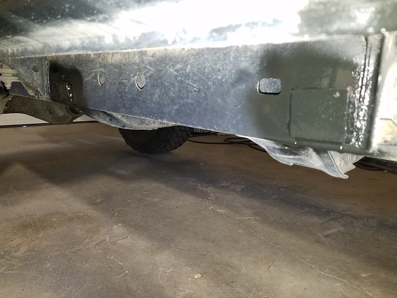

20171022_145838 by psraff, on Flickr
Got the grinder out and cleaned up the plates on the frame and since it will be another week possibly before I can do any welding I threw some paint on them.
20171022_145742 by psraff, on Flickr
