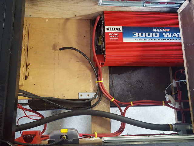

I've also been working on a rear storage with an air compressor and tank built into it. Plus for the fun of it, I installed an inverter as well. I'll have pics posted tomorrow once I have it assembled with all I've done. Unfortunately, my plans changed for it after it was mostly built and I need to fit a second battery in there as well. I'll have to find a somewhat low profile battery (somewhat under 8") for my plans to work.
As promised.
I started this months ago, but life got in the way and I just blew the dust off of it. I just got a handful of parts in yesterday and I have it as far as I can before I have to go back to work up on the Slope for a month.
Story is, is it will have drawers in it like everyone does, but also have the top on hinges so you can still get to everything if for some reason you can't open your rear hatch. IE, it would really suck if you slid back and your ass end is up against a rock or tree... You can't open your rear hatch, and then you can't get to any of your first aid or recovery gear if you have it stored in your drawers.
I was going to put a valve in to separate that tank from the gauge and connector, but I'm unable to find one that will mount behind a panel with only the handle showing. I had a Swagelok that I thought I could make work, but turns out the fittings on it are built into create the air tight seal. Change them, and you make the valve worthless....
20170307_090653_zpsmt1ayh7a.jpg~original
20170307_090744_zpslhkbgius.jpg~original
Still need to install a battery in it's own compartment behind the inverter. Then a 70amp fuse (power to inverter and air compressor), and a small distribution block for smaller devices (lights, switches and such)

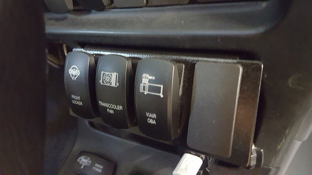

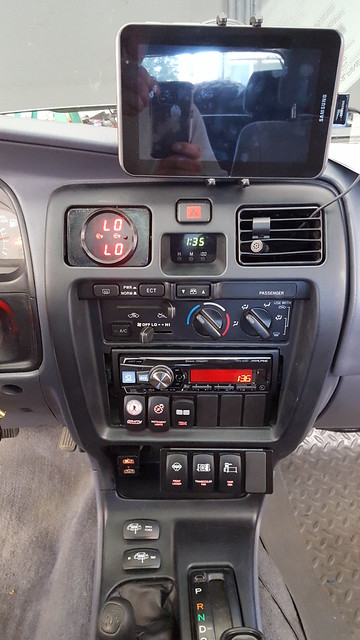

Another project I've been trying to finish are my switches. As much as I wanted an overhead switch panel or one high up on the dash, I realized it just wasn't ever going to happen. Also, my plan with the GPS Double Din Stereo didn't work as I wanted either. I got it only because I wanted it for GPS. I didn't know it used Cell Towers for GPS and not actual Satellites (not sure on terminology or technology regarding this....), and in Alaska that turned out to be a waste of time. So I picked up these brackets and switches and have these all wired up and ready to go. The only thing I'm waiting on is to get my old stereo out of my kids Jeep... (which was T-Boned, so it's at the body shop). When I get it back, we'll swap stereos, these switches go in and I get to clean up my wiring once and for all. I'm hoping to upgrade my fuse block to Ripcords Acrylic platform at this time as well. Then I will get my cable to connect my two batteries and I'll be able to mark several projects off the list.
First Switch will provide power to all the switches.
Second Switch provides power to all my extra gauges.
I have several blanks for when I figure out my extra light situation. I know I want amber glow / driving lights in my grill and under my head lights. That's one switch. a set of lights (spots) in my hoop on my bumper; that's another switch. Another pair of matching lights, but floods where my Lightforce are; that's another switch....
Most likely winch control some day.... So as you see the spots get used up pretty quick.

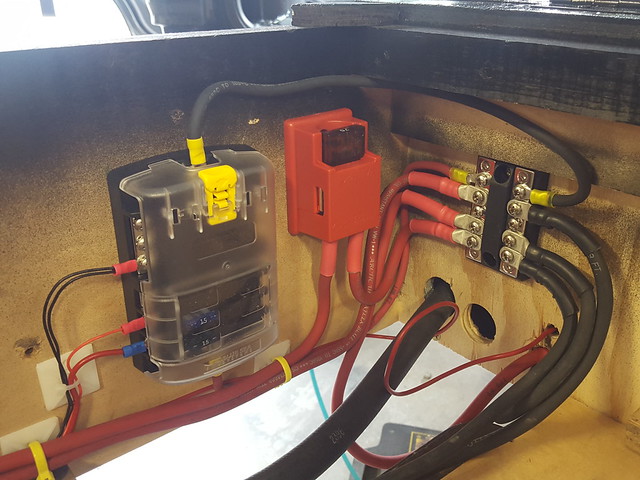

Cleaned up the wiring today which was pretty hard to make look good. The 6 awg wire I pre measured and had a shop cut and put end on for me since I don't have a crimp tool that will do lugs that large yet. They messed up almost every single one of my measurements. But you get the idea on my wiring, and what's doing what. I have room for more connections on that fused distribution block so the sky's the limit. I will clean it up more once the battery is in there for it's final time.
20170520_152057 by psraff, on Flickr
20170520_152130 by psraff, on Flickr
20170520_152147 by psraff, on Flickr

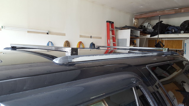

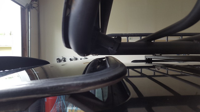

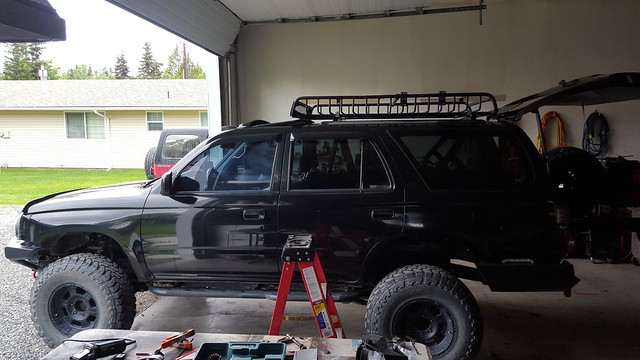

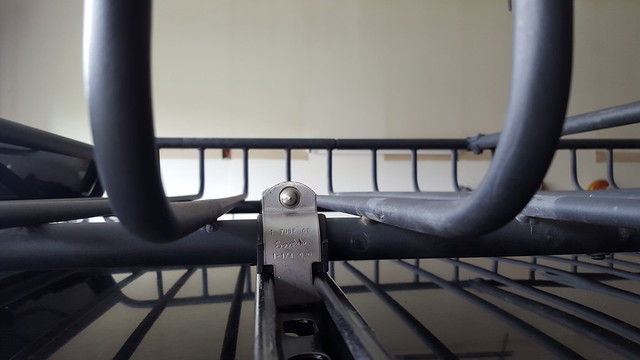

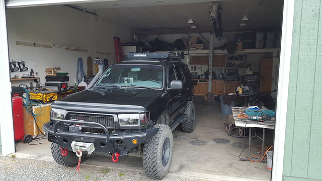

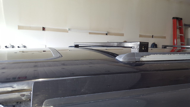

Due to a lot of rain and not wanting to be trapped in the house, I did a little project that I've been wanted to address. Wanted to drop my Cargo Rack as low as I could so it didn't look so awkward. Of course due to the curvature of the roof, and the sun roof it's not as easy as you would think (everyone already knows this). So:
Parts List:
One Stick Shallow Strut
4 Square Washers
M6 Hardware
Swagelok Tubing Clamps
For the Yakama Rack with Extension you need right at 7/8" to clear the sun roof when you raise it. That's the thickness of Shallow Strut so I just double stacked it. Used the Square Washers to cap the Strut to give it some character is all.
Once it was all welded, painted and mounted it turns out I've lowered it a total of 1 1/4". Might not sound like much, but if you stand back and look at it, it look so much better.
I'm sure there's better/ cleaner ways to make the ends, but I didn't want to spend too much time on this. Some day I would like to make a whole new rack anyway.
20170701_104731 by psraff, on Flickr
20170701_104745 by psraff, on Flickr
Amount of clearance you have with the Sun Roof:
20170701_112148 by psraff, on Flickr
Swagelok Tubing Clamps:
20170701_120650 by psraff, on Flickr
20170701_112237 by psraff, on Flickr

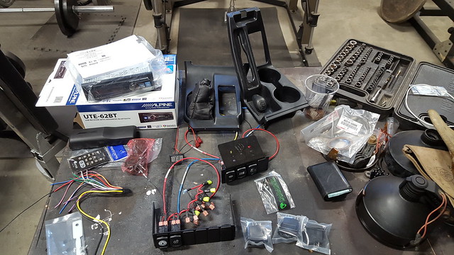

Got back from the Slope last night and started to plan this morning out to work on the 4Runner.
Oh BTW, we had about 30 seconds of snow flurries yesterday up there... Anyway, opened up a few boxed that shown up while I was gone and got organized (ok... not REAL organized).
20170722_071411 by psraff, on Flickr

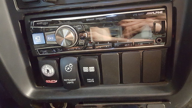

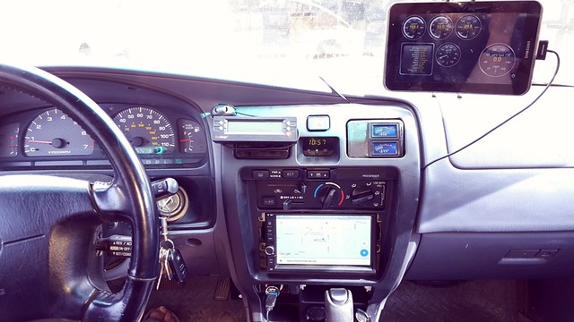

So here's an old pic of what Stereo I had in there before. Double DIN Android that I thought I wanted for GPS, but here in Alaska it just wasn't up for the job due to limited cell service.
2017-07-22_08-58-28 by psraff, on Flickr
Out with the old and in with the new! Single DIN Alpine UTE-62BT. Wanted the Single DIN because I picked up the switch brackets and switches months ago and had them wired up. Took me this long to decide on the Stereo. Also picked up a few more switches for my Winch Controls and cut them in above my 4WD Stick. They're not wired up yet, still waiting on this to be installed in my firewall.
2017-07-22_09-10-04 by psraff, on Flickr
Once I have that built and installed I'll have all my wires ran though that to my fuses and relays. Right now I have the console all put back together and the switches I need wired up. I'll have to add a Bussman Relay to my Fuse Block to it runs off my Ignition and not my battery so my switches will only work off the key but the major work is complete.
20170722_133642 by psraff, on Flickr
Yes, I plan on buying a new center dash soon. Just had to finally make up my mind what the finished product was going to be before I did. Also for the Instrument Switch, it's currently only going to my duel tranny temp gauge. But I would like to finish another project and get another gauge to do the same for coolant temps. Monitor before and after temps of the radiator like I do my tranny cooler. I may change the name of the switch from "Instrument Lights" to "Instrument Power". Not sure what I was thinking....
20170722_211803 by psraff, on Flickr
Right now, I only have the Fan Switch wired up.
20170722_211820 by psraff, on Flickr

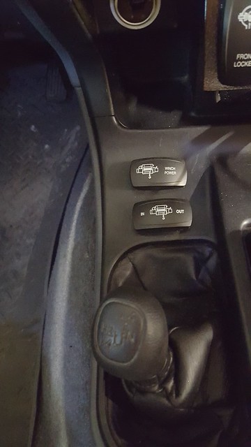

Winch Controls:
20170722_211738 by psraff, on Flickr

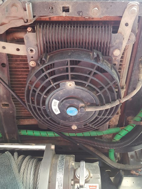

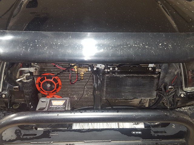

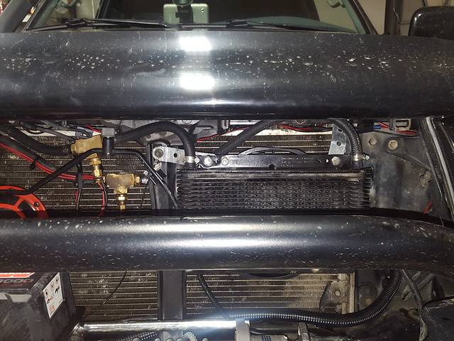

Alright, this is something I did a while ago and I know I posted somewhere, but it's too important to let it go. When you mount fans on your trans cooler it's important (at least I feel) that the fan goes BEHIND it.
See how much it covers the cooler:
2017-07-25_04-44-59 by psraff, on Flickr
Under normal conditions, it doesn't get the airflow. And I was told this going into this project long ago when I got the fan, but at the time I was having fitting issues, so I put it in the front. True enough the cooler wasn't as efficient as it could've been. So a while back I reworked it:
20170521_145628 by psraff, on Flickr
Let me tell you, it's not easy to get it to fit. and I had to trim the grill to make room (which scares me some since I'm getting a new custom grill in a few weeks). But I instantly could tell the difference in the temps with my dual gauge.
20170521_145645 by psraff, on Flickr
This was just one more of those projects that was put on the back burner to finish but this year I'm getting them all checked off the list. So glad I did it!
How big of a difference are you seeing? Mines mounted on front and will stay there. During normal town and highway driving there's plenty of flow going through it. My temps on highway almost never go above 170.
I installed it for slow wheeling up steep grades/passes. With the fan in front in a push configuration it's way more efficient than with the fan behind in a pull configuration. At least that's what my research suggested. I guess it boils down to preference/driving habits.
With my duel gauge setup, before in normal everyday driving, I would see average 12* difference in temps (notice in pics, those temps are taken right before and after the cooler). Maybe on a good day I could see 15*. Now I see at least 15* difference on a regular basis and I've even seen 20* at times. I haven't done any camping this year or mountain roads so I can't tell you any temps under those conditions. But I've turned it on around town on a hot day in traffic and still see the temps drop, so I know the functionality of the fan still works. When it comes to hitting the slow mountain roads (which is what I have it for), I hope it still excels.

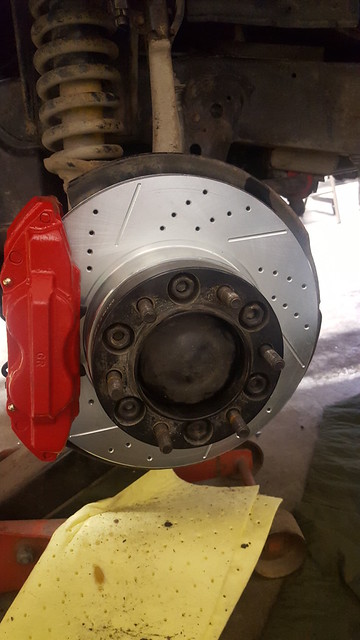

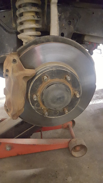

Back from the Slope and drove the 18 year old daughter and her Jeep through Canada to Washington for school. Time to finally put on my new brakes! Many Thanks to [MENTION=84643]JBurt[/MENTION] for getting them up to Alaska for me (3rd Party Sellers on Amazon wouldn't ship to AK, so shipped to Jeff's place in CA. Then he shipped up to me).
Old 190MM Tundra Brakes (Pistons freeze up on them every two years. These are the second pair for local Auto Store with life-time warrantee).
20170907_083859 by psraff, on Flickr
New 230MM Kit from Callahan on Amazon
20170907_094526 by psraff, on Flickr
