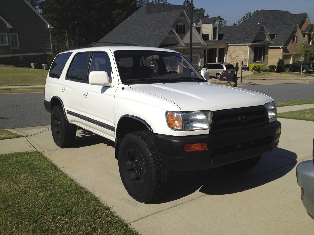

Here she is the day I got her. 198,000k - Sept 2nd 2010

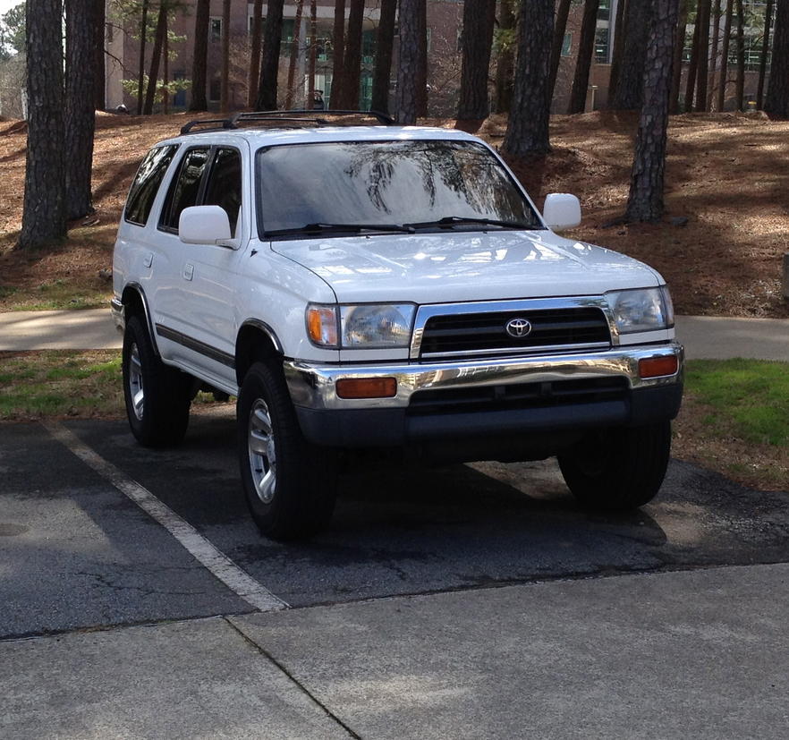

This is what she looks like now. 216,000 - April 27th 2013

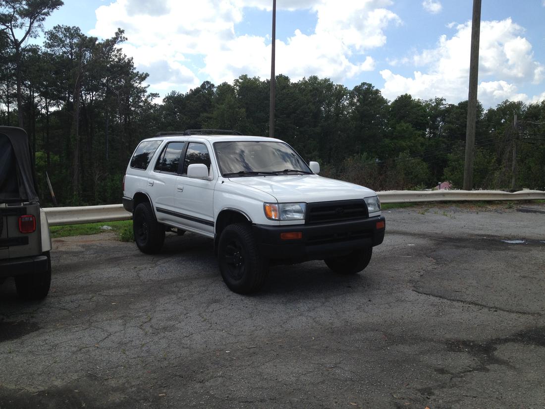

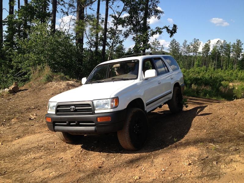

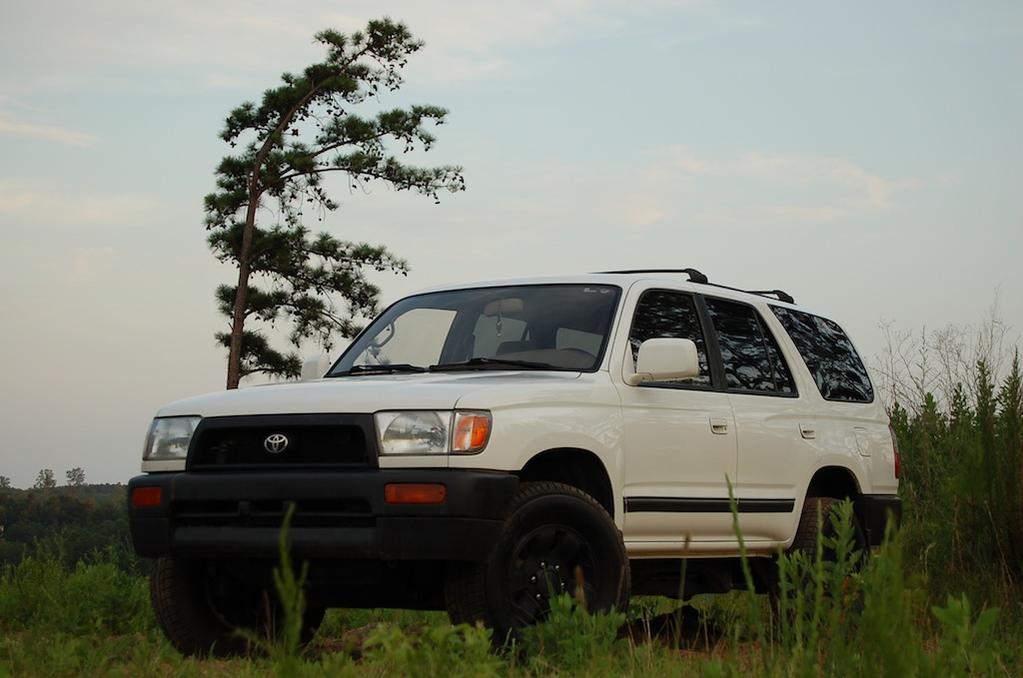

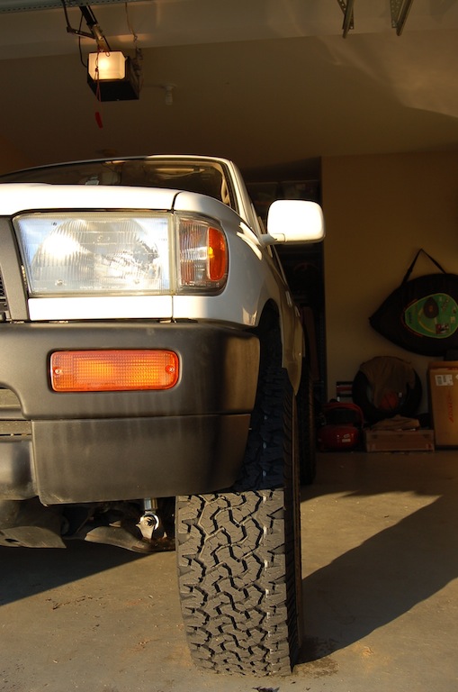

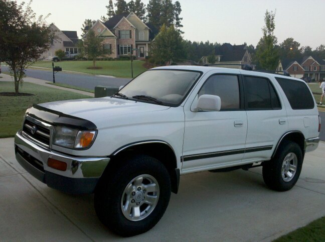

Here's a picture of her on a nice sunny day before any exterior changes took place. I think around this time I had put a Flowmaster 40 series.

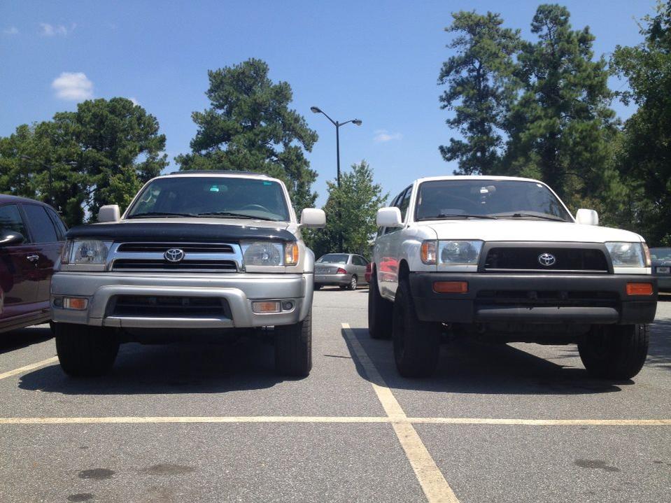

Here's Michele parked next to Natasha. My friends 99 limited 4runner. He copied me haha.

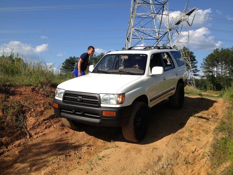

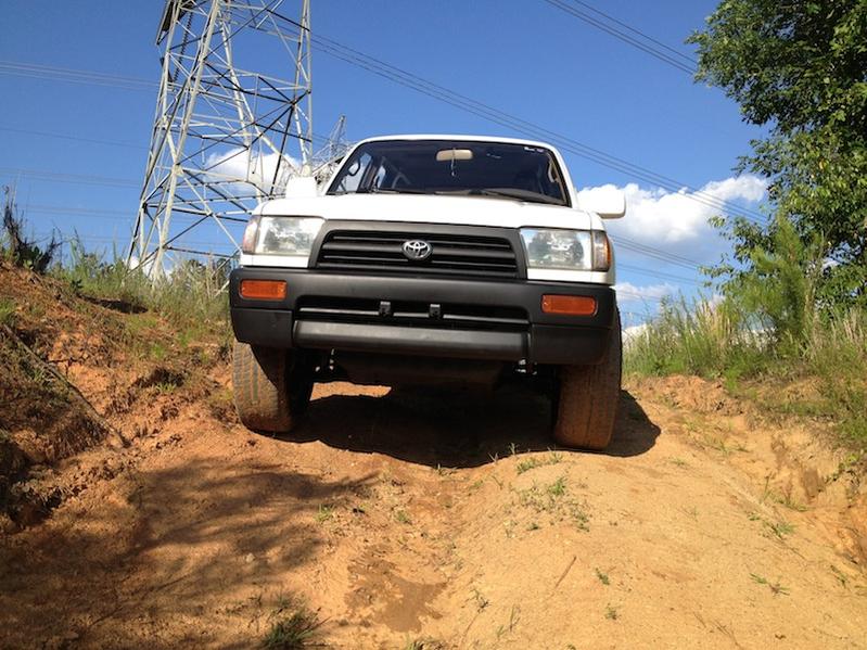

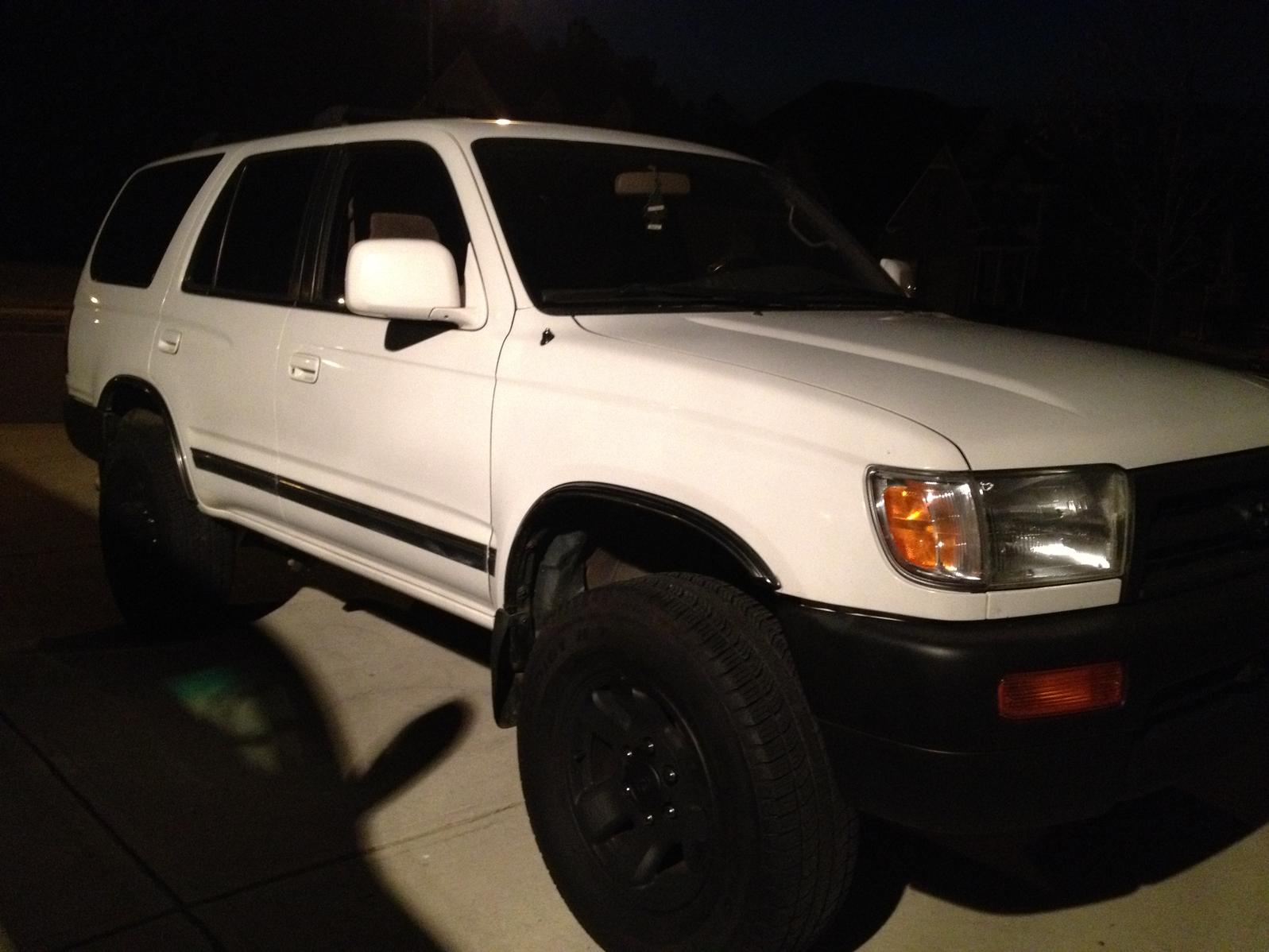

I then went on some quick trials to get some dirt on the tires. Nothing crazy at all since my mom kept telling me that ill break something. IMG_0429.jpg

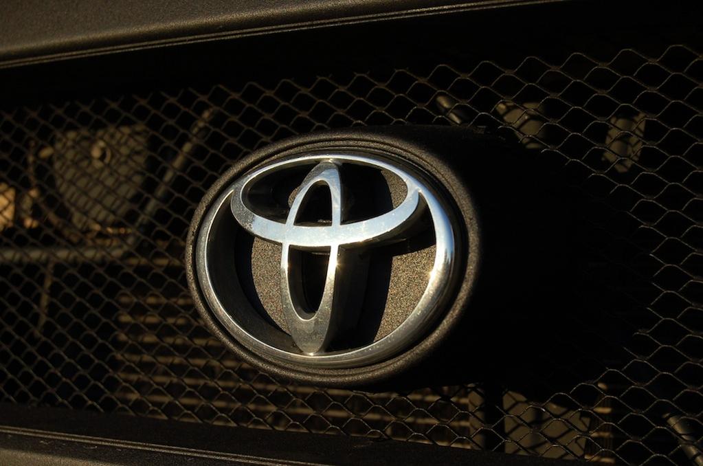

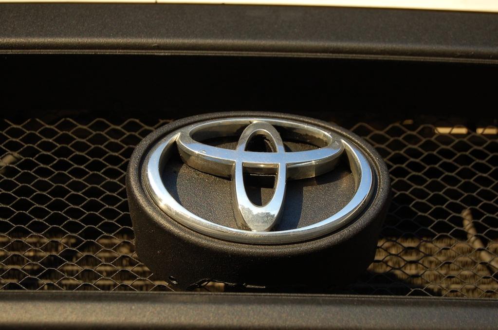

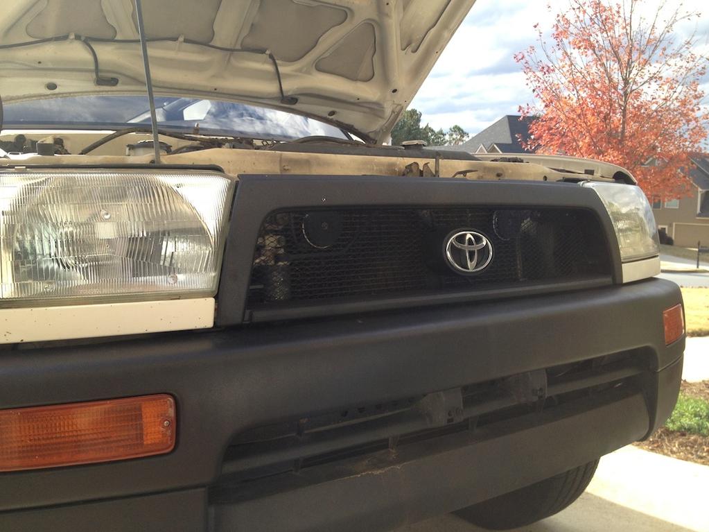

Then I did the Satoshi Grill Mod. Used some mesh from Home Depot. Got a huge roll for 5 bucks. Cut a size roughly to fit. Then cut out all unwanted trim from the center of the grill. Zip tied the mesh in and zip tied the emblem on. painted with Black Bed liner.

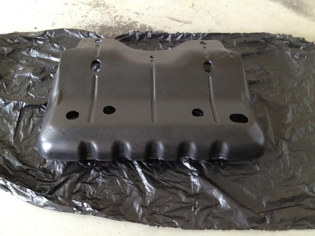

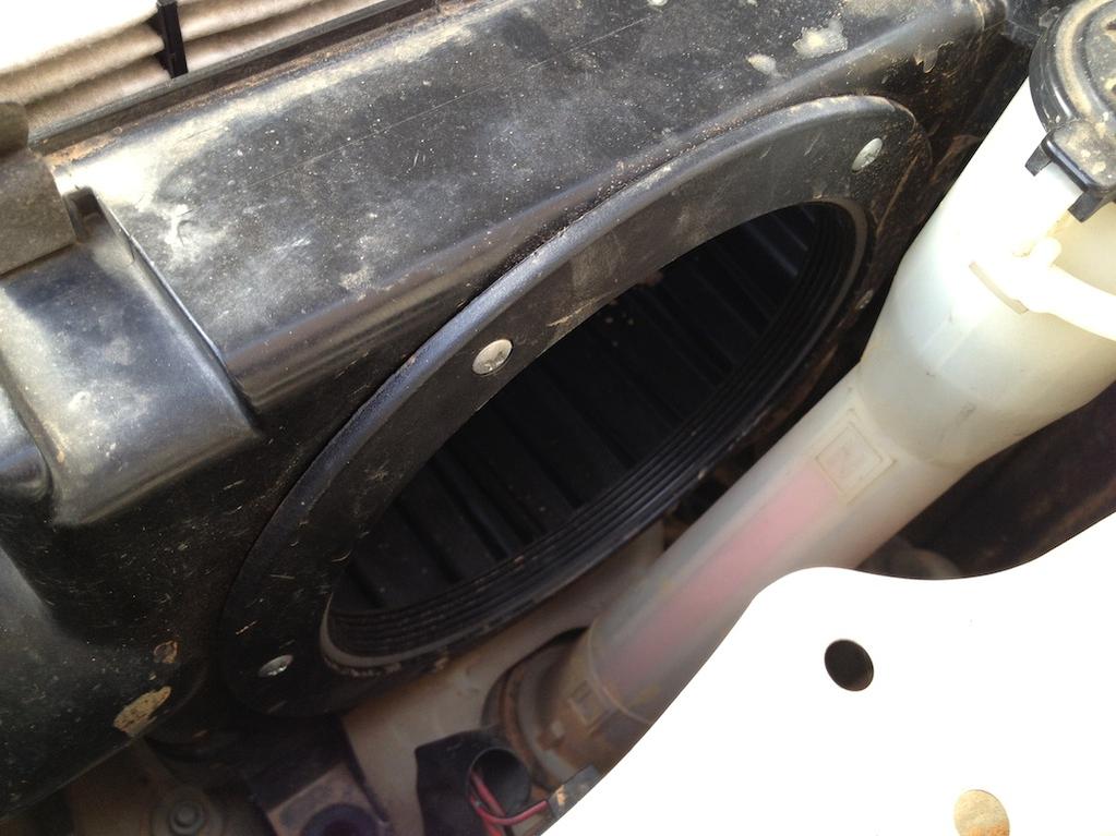

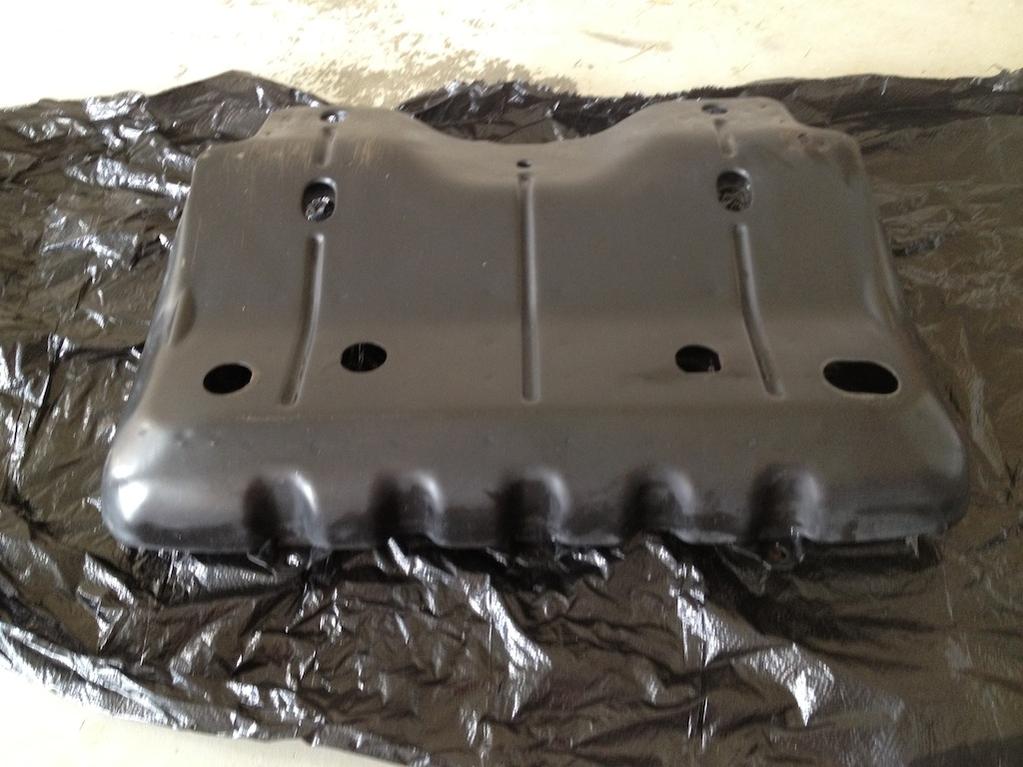

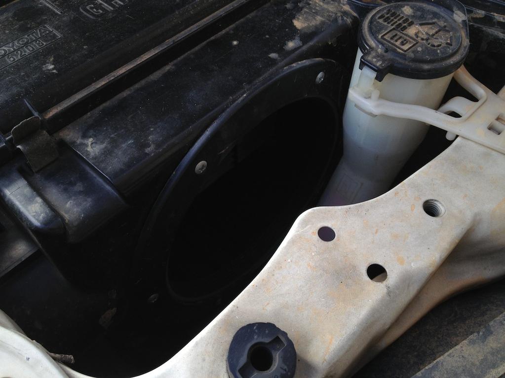

Then I did the Deckplate mod and also repainted the skid plate with Bed liner.
Its a 6 inch deckplate.
BEFORE
AFTER

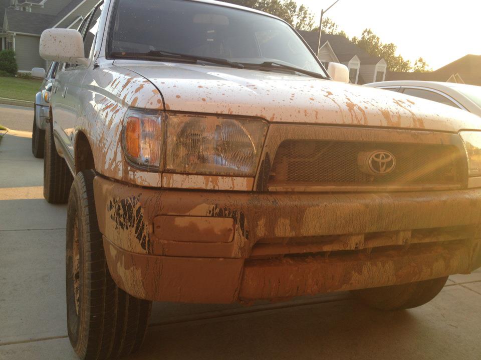

Went off road and hit a mud hole.
After I washed the mud off which was everywhere underneath the truck and ran my rents water bill through the roof I went and took some photos.

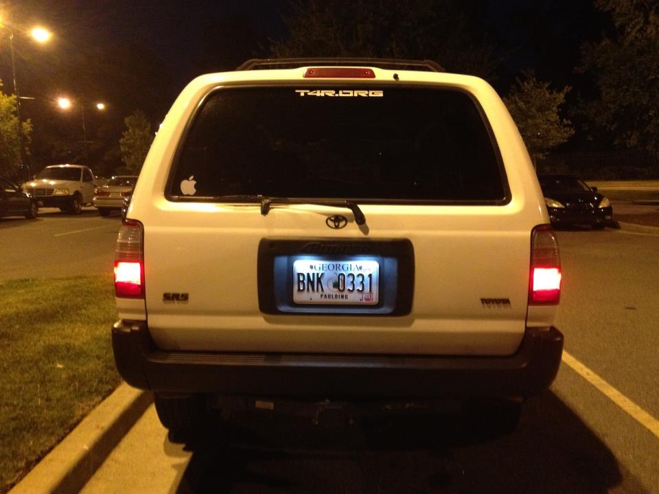

Added some Led License plate lights. The others looked old and dull.
This was the last thing I did until I spent some cash on the Lift.

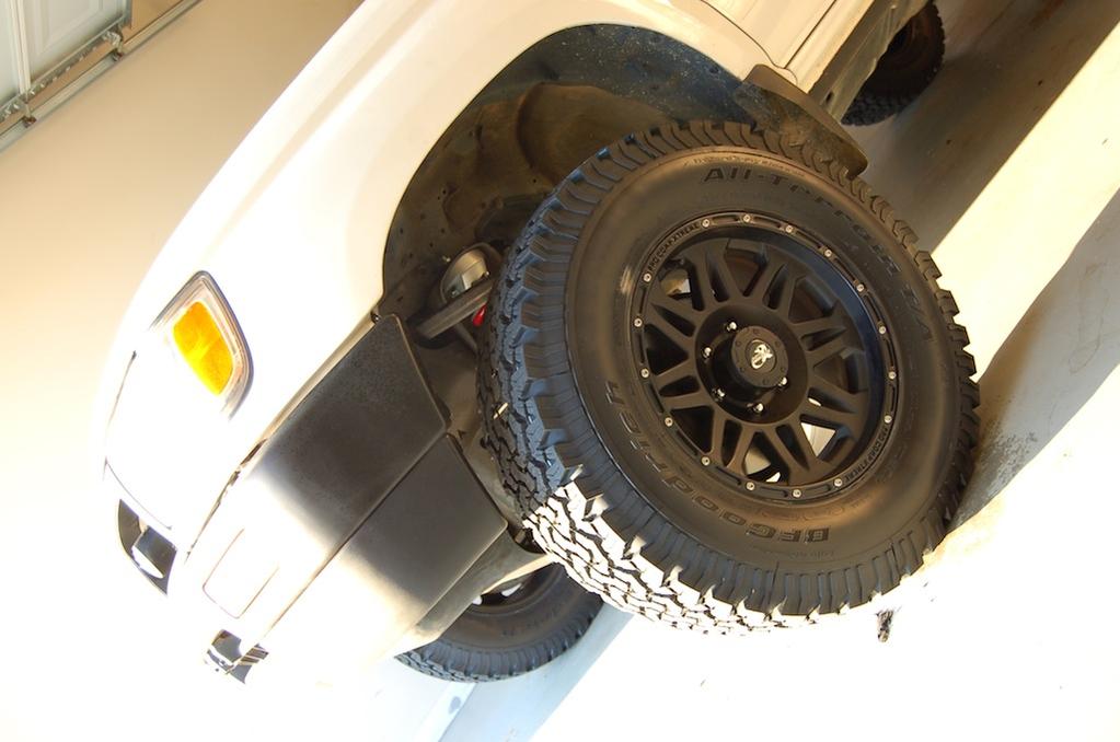

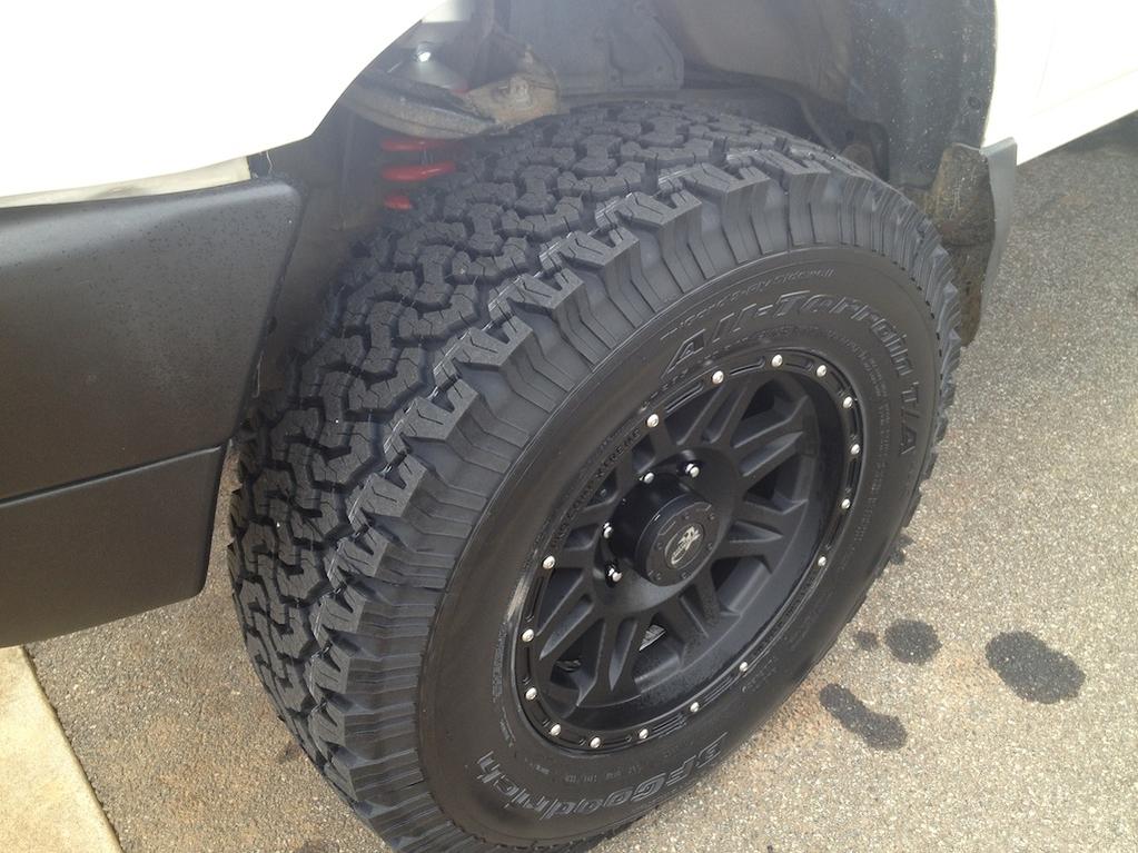

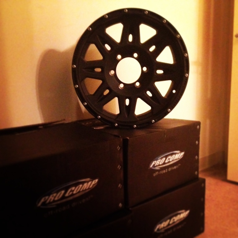

New Rims - Procomp 7005 17x8 4.5BS

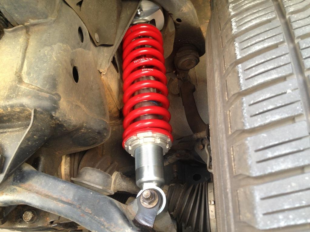

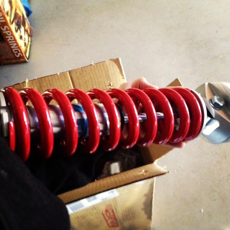

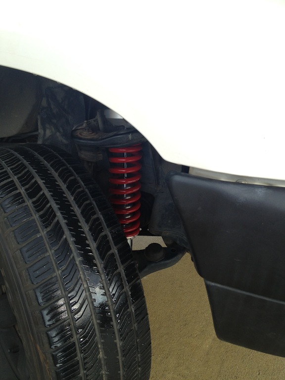

Then the 3in Ultimate lift kit came in from Toytec.com
600lb Coilovers
with 890 coils and procomp 9000 series

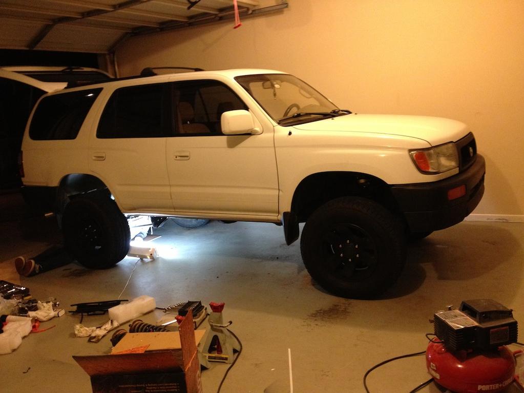

1in diff drop

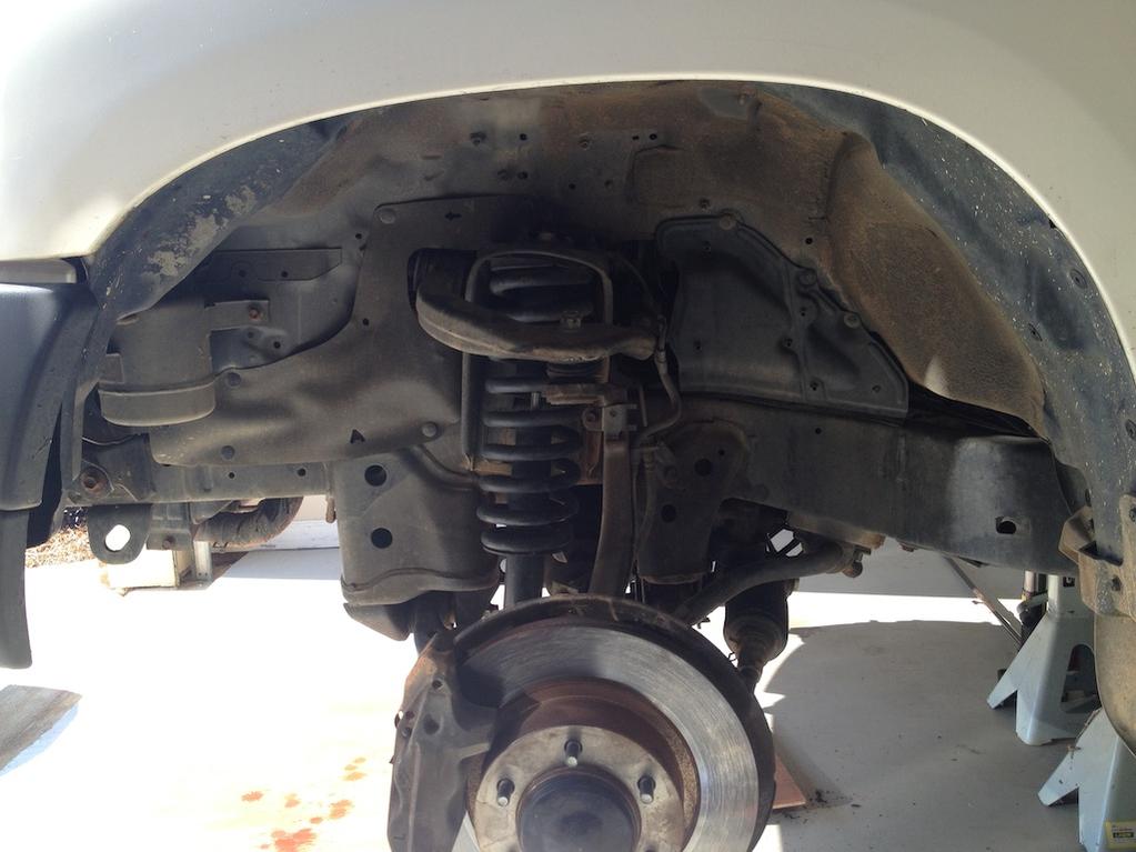

Then the install. Front first. The front struts bushings were torn up.

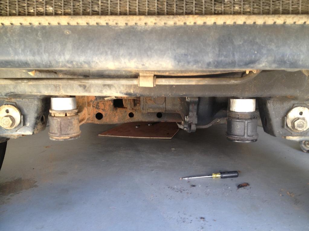

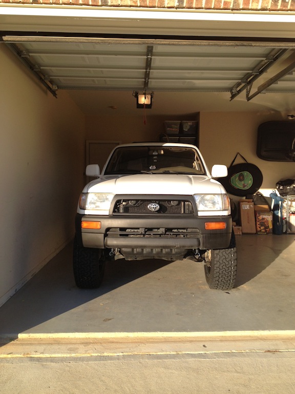

Then I installed the 1in Diff drop. I really hate putting the skids back on. It always seems like I put one less bolt on the front.

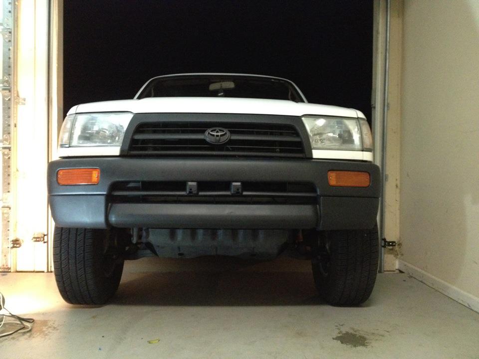

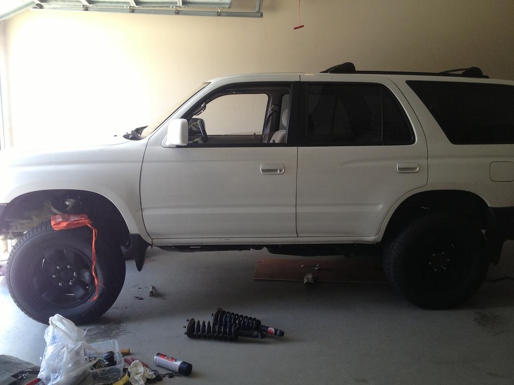

Heres how she sat with just the front lifted.

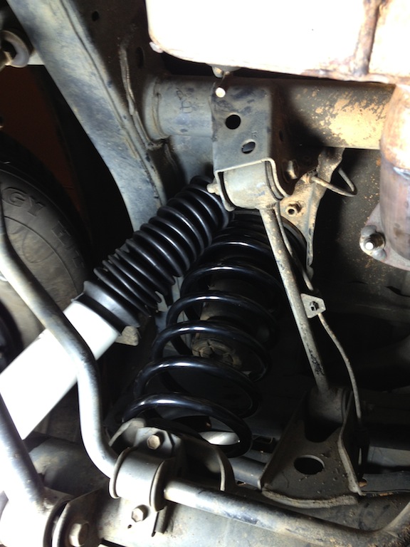

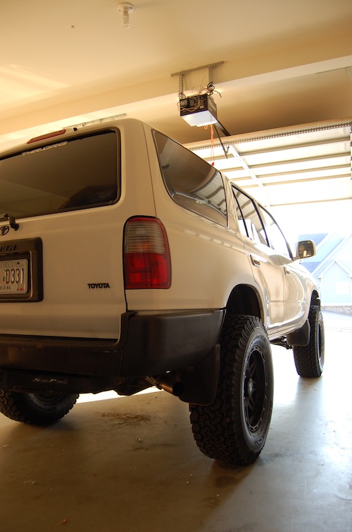

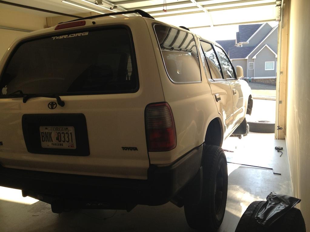

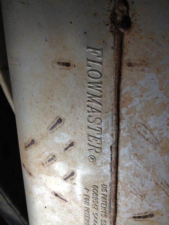

Then did the back. I didn't have any coil compressors until my neighbor saw me suffering haha. Finally got them squeezed in. With the shocks there is some noise coming from them when I hit bumps. Sounds like the top bolt is moving but they're on nice and tight. Also heres a pic of the 40 series Flowmaster.

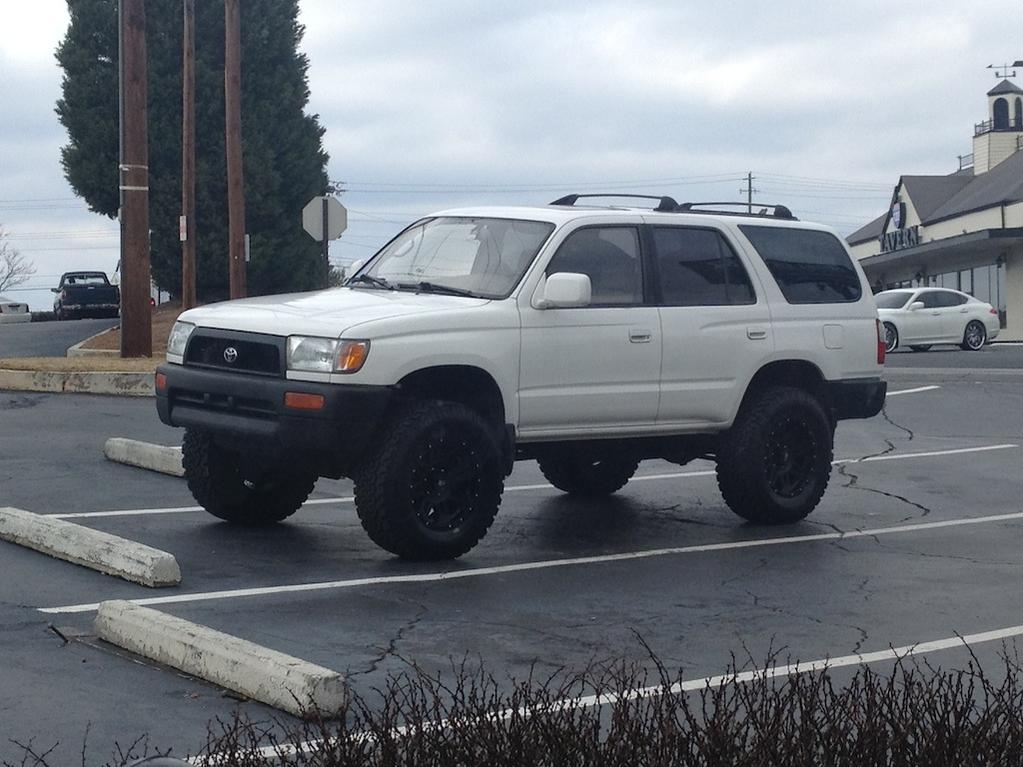

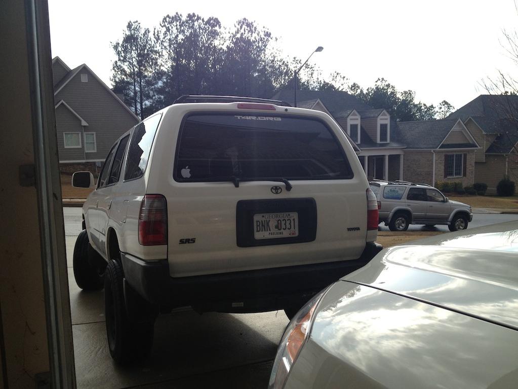

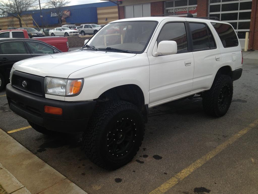

Here she is all put together after the lift. Next was to go pick up the tires and have them mated to the rims. For those of you who remember Natasha, thats not her in the road.

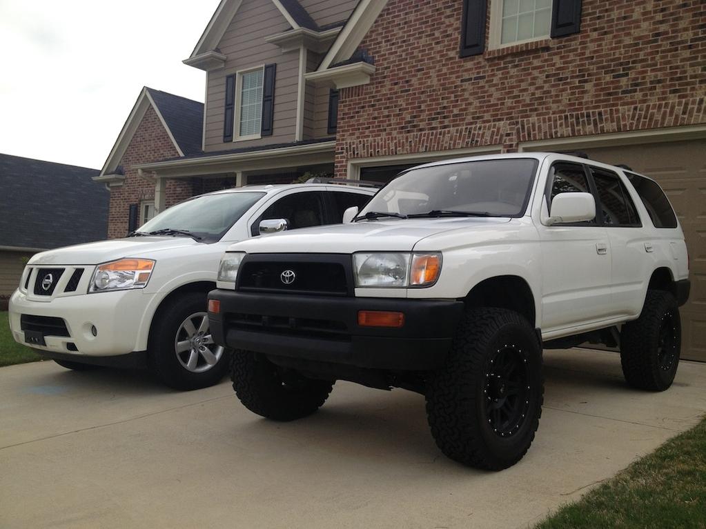

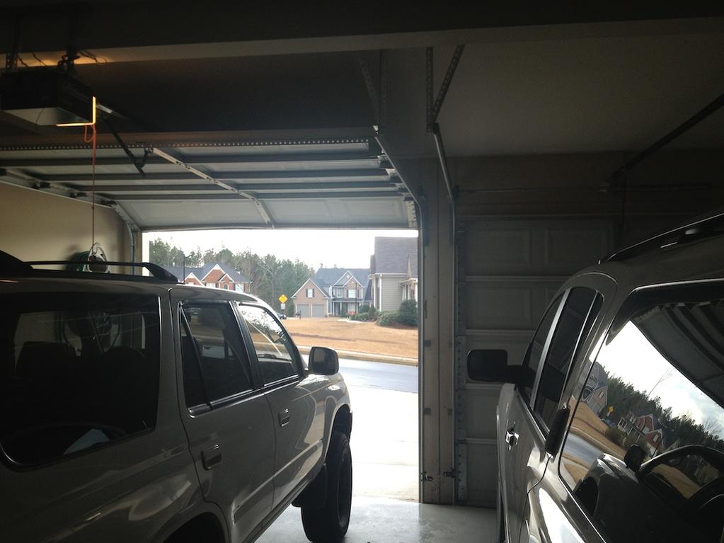

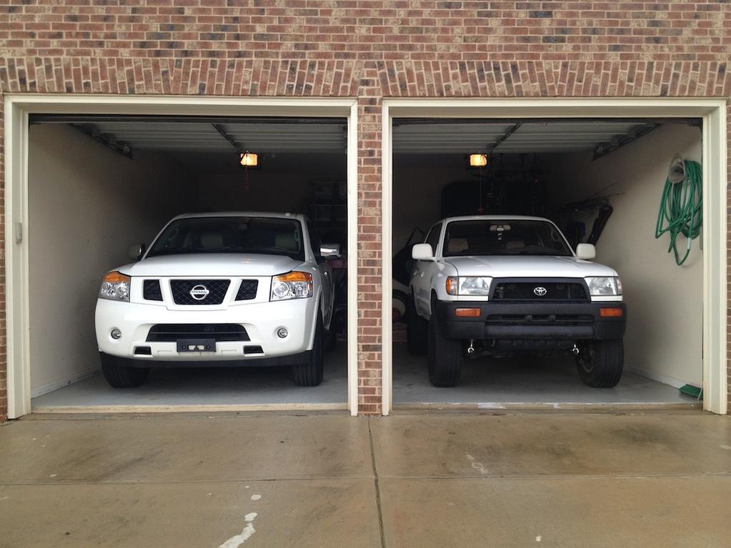

Here she is next to my mom's Armada.

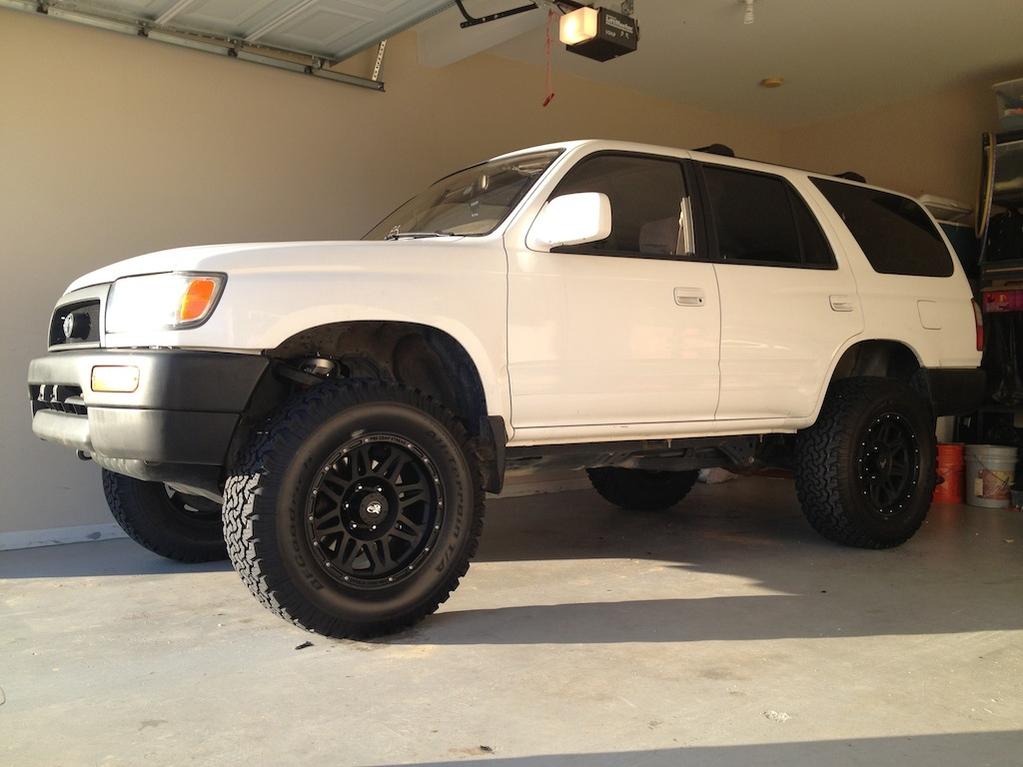

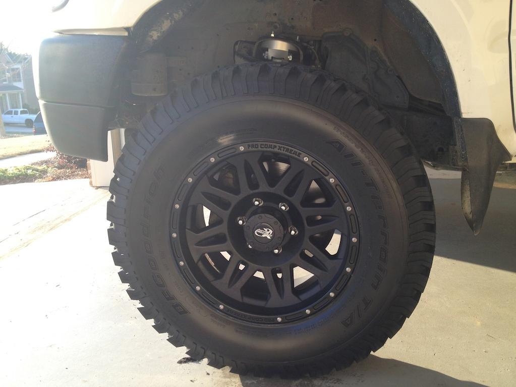

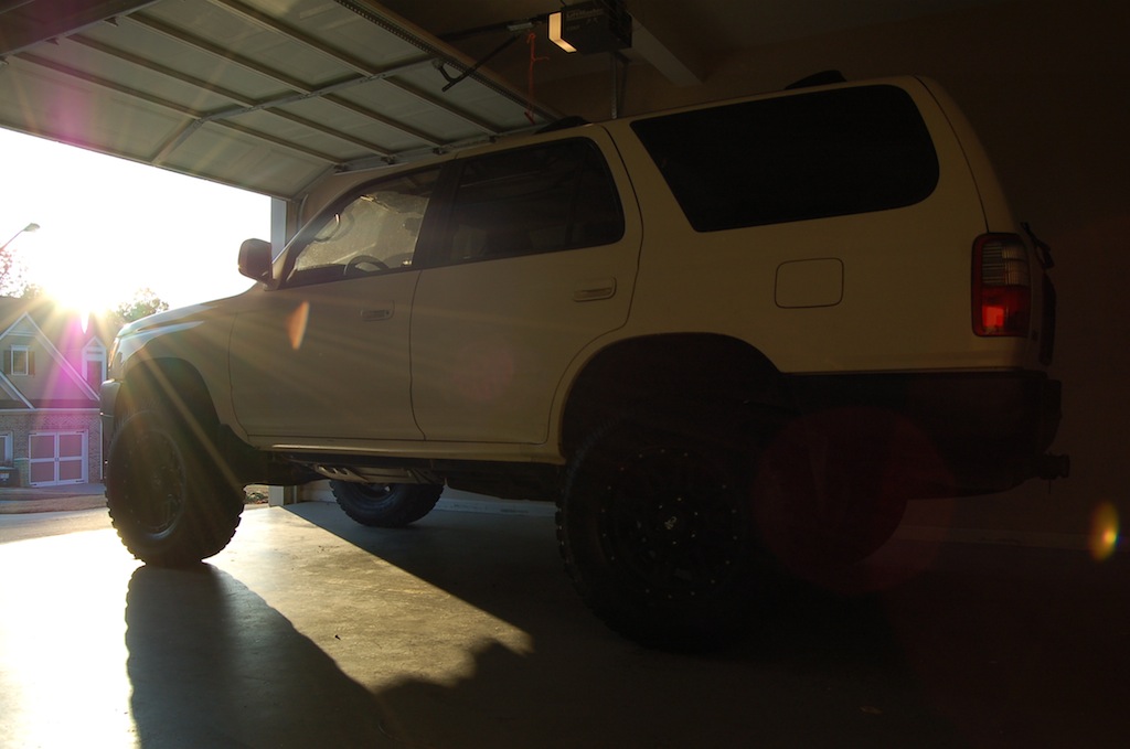

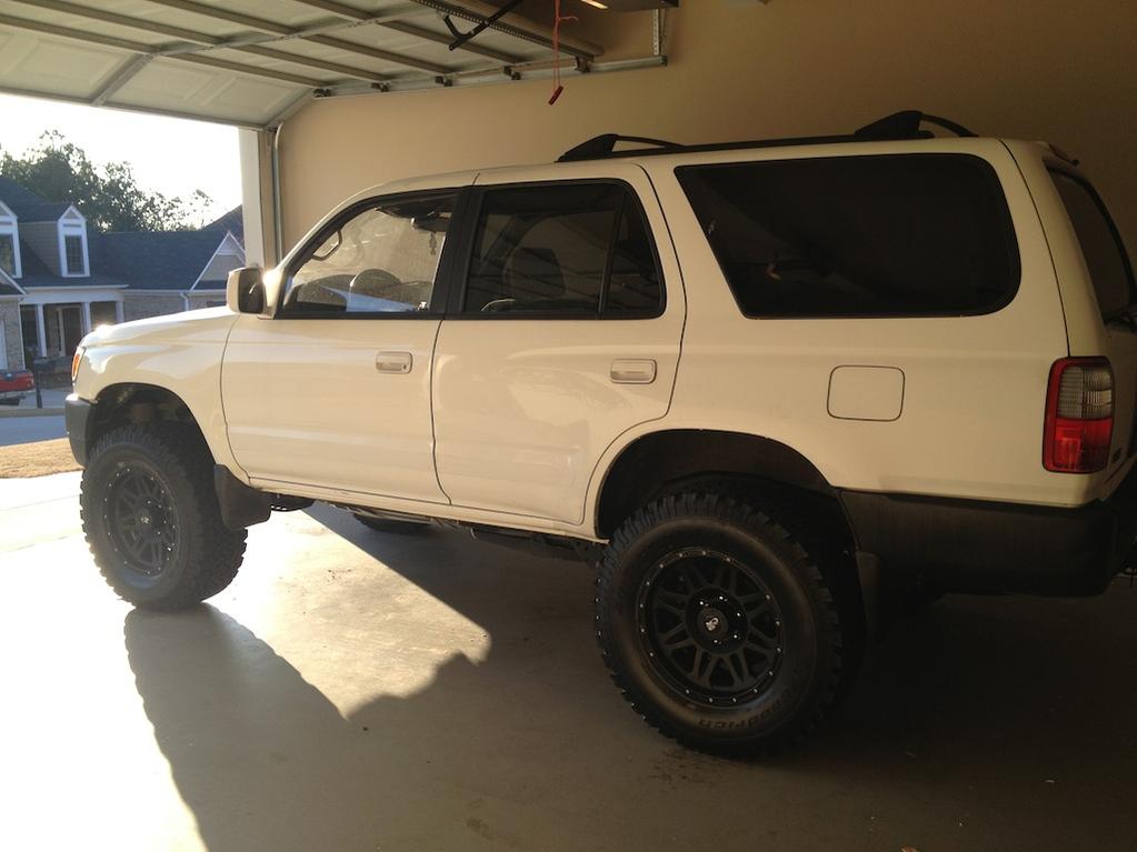

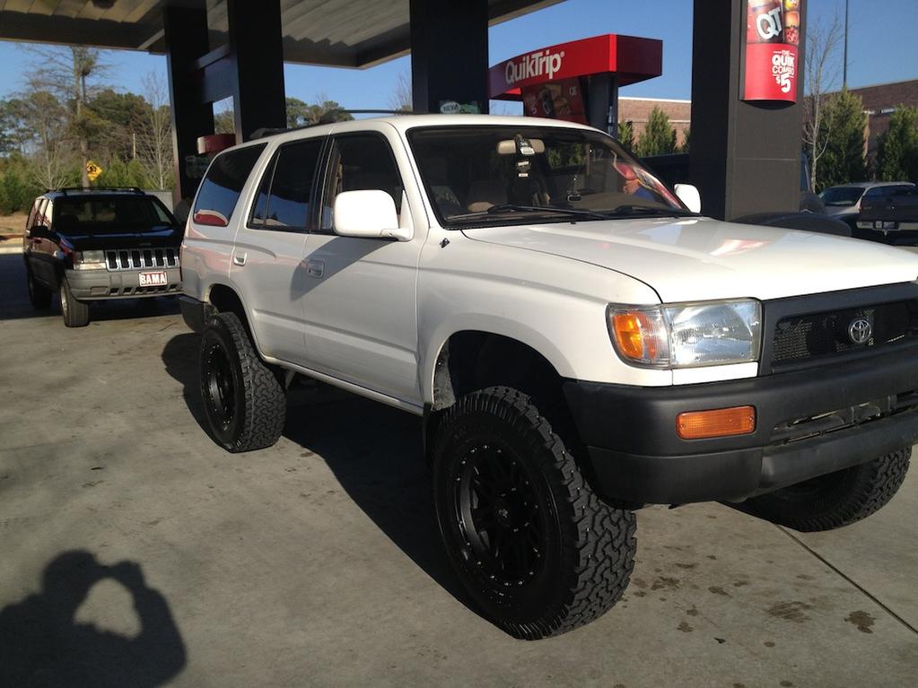

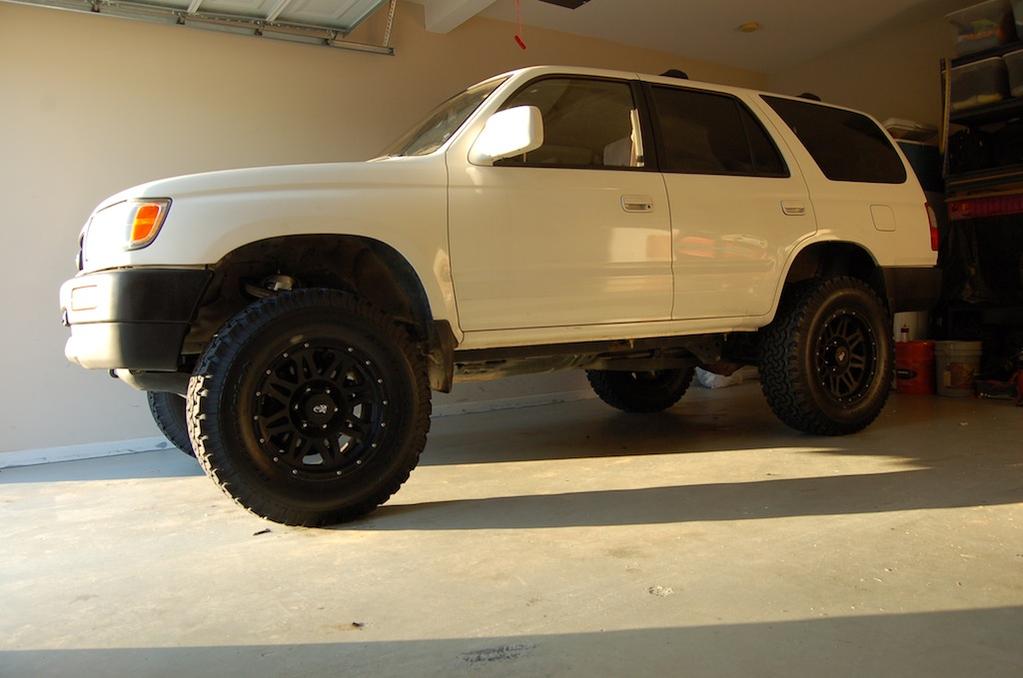

Then I went out and got my wheels put on. Before I left I had to reset the rear brakes since they were locking up when i went from park to drive. Go in reverse then hit the brakes do this a few times with pace. Don't hit anything.

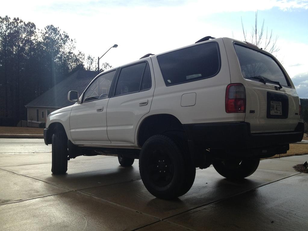

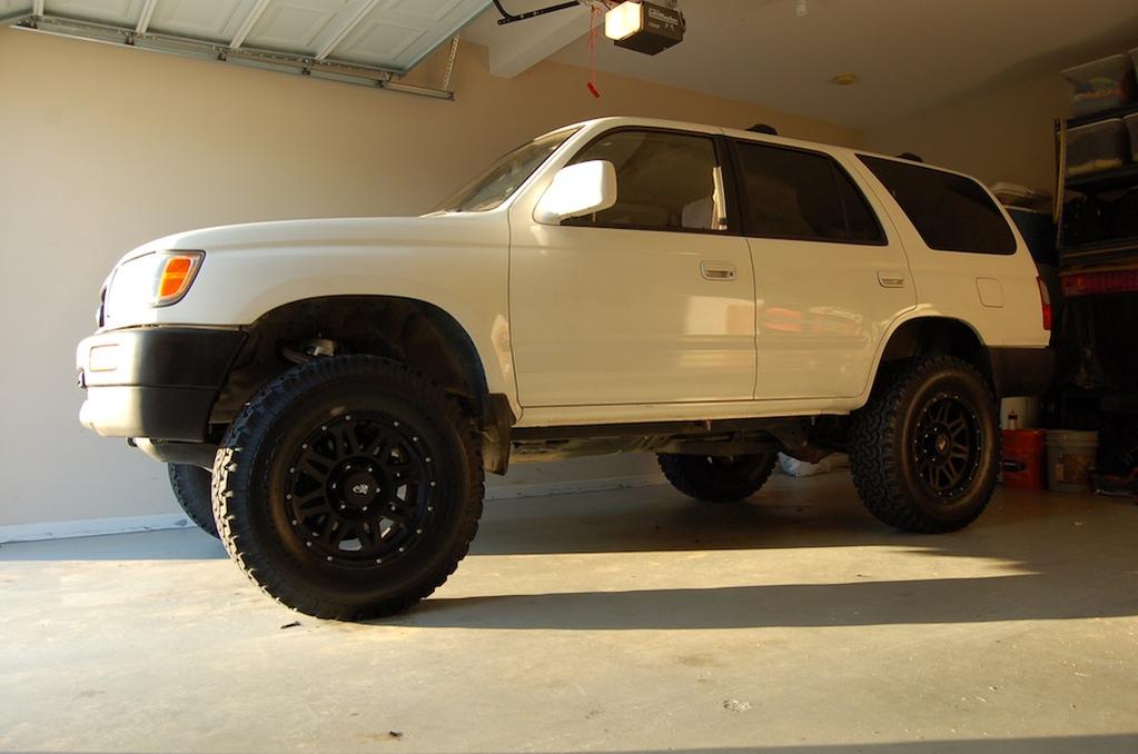

Now the lift is complete.

Drove her home and was very proud of how she looked and that sick feeling from spending so much was going away for now.

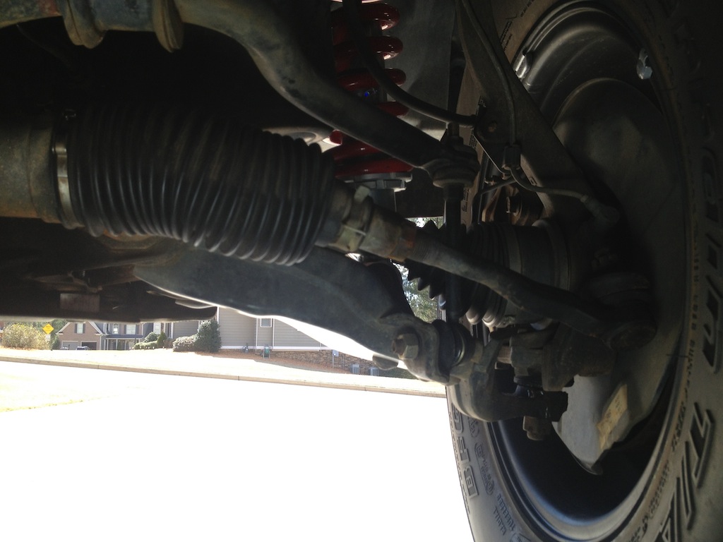

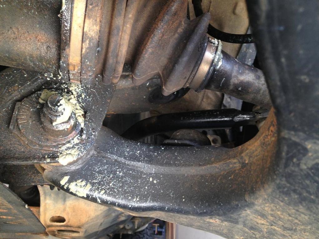

After the lift I would check up on her and see if anything was leaking. Much easier to get underneath since shes much higher. :naughty:

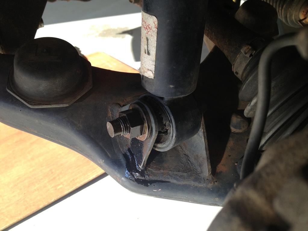

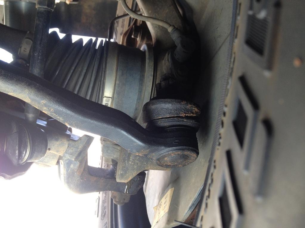

And there were some problems, the CV axle got lose and is leaking grease. Need to fix

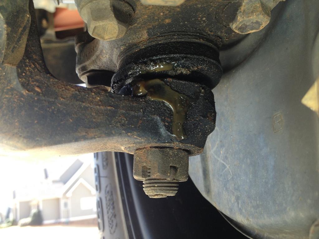

Then I saw that my LBJ boot was cracked and leaking OH NO!
Plus this pissed me off to see that when I got my alignment they cocked the tie rod at this angle.

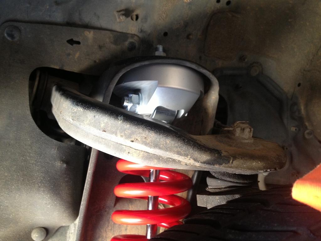

I ordered new UCAs from Camburg, new bushings for the rack and pinion, new bushings for the LCA, new LBJ which I got today, extended brake lines and a new pre cat o2 sensor.

It took a long time to save up for the Toytec lift. I like how the emblem looks like its floating on the mesh.
The moto for the the build was only the best (within reason) so when 4wheelparts told me uniball joints are the strongest I went with the Camburgs. The other option was Total chaos but those were too expensive for me. I couldn't find any reason to spend that much more on UCAs.
I got the Camburgs, front brake lines, rack and pinion bushings from Wheelersoffroad
The rear brake line and LCA bushings were from toytec
