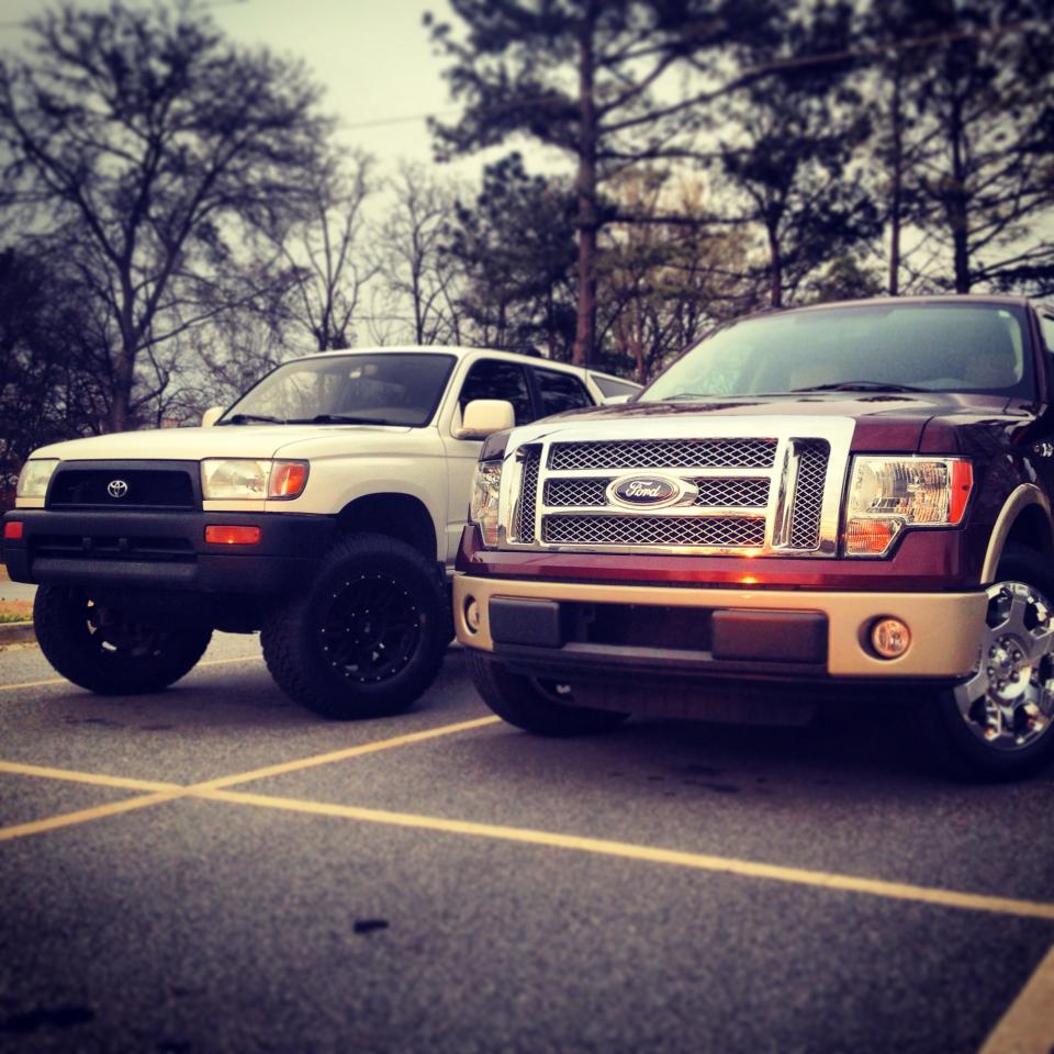

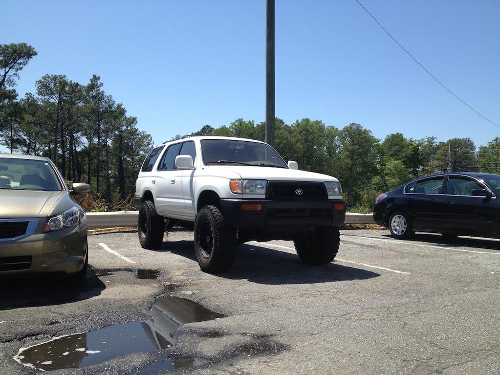

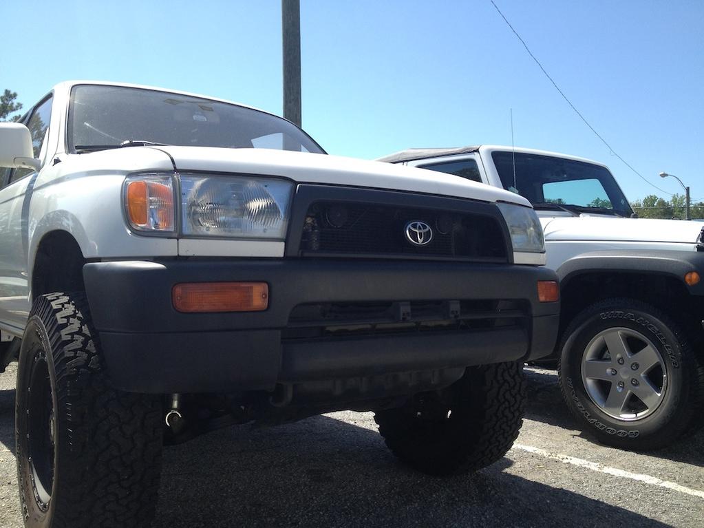

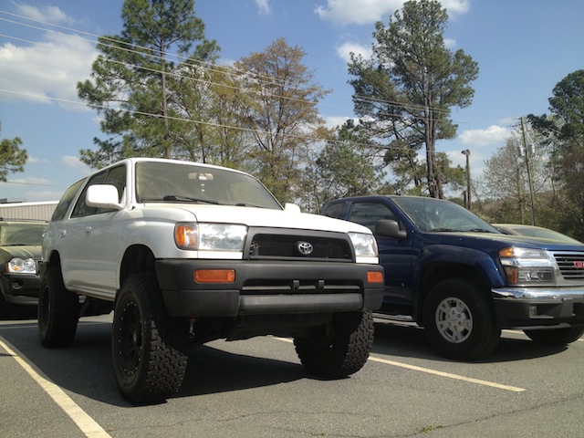

Can we get another pic of your truck and the Armada with your new tires? I wan't to see how big I will be next to my dad's X when I get bigger tires.
Are you running 33's?
Also nice rig!
Thanks in advance.

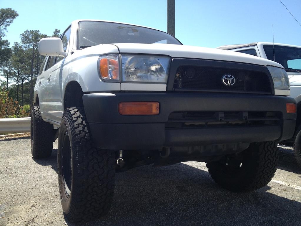

Ya man I can do that. I don't have any pics of them next to each other on my Mac you'll have to wait since she's parked at school until I can drive her again when the parts come in.
The tires are almost 33s, there 32.76 load range E1 speed rating R.
I had to cut the square (inside wheel well) off of my mud flaps since when I turned the tread would barely bump into it.
And Thanks for the compliment.

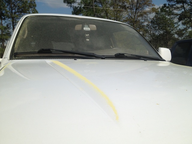

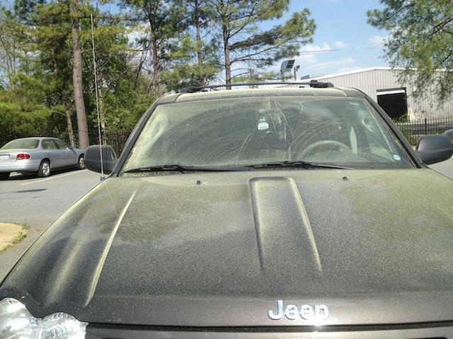

Sitting in the parking lot collecting pollen....

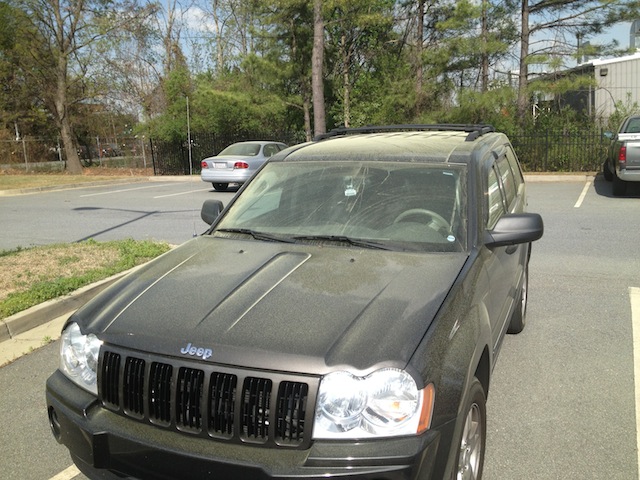

Then saw this jeep behind me, since its black you can see the pollen better.

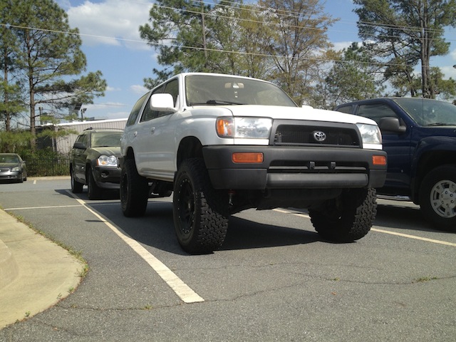

He's did you paint your wheels originally? And what did you paint it with?
I painted the stock rims with Black Plasti dip Spray. Plasti Dip update
The paint has held up really well besides the wheel weights were making it bubble a bit.
Plasti dip is like a rubber paint. You can peel it off whenever. Just be sure to watch some youtube videos on how to apply.

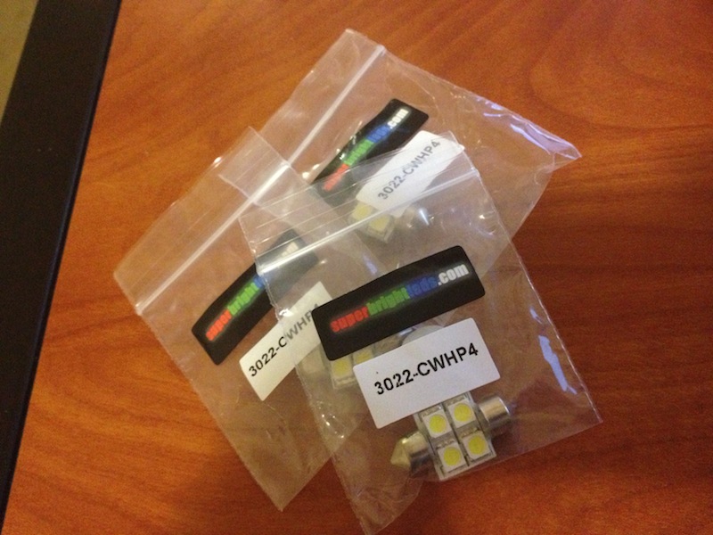

LED Dome Lights came in from Superbrightleds.com
-3022-CWHP4- Cool White
Going to install when I get back home. These lights will fit Domes and Map lights on 98 4runner.

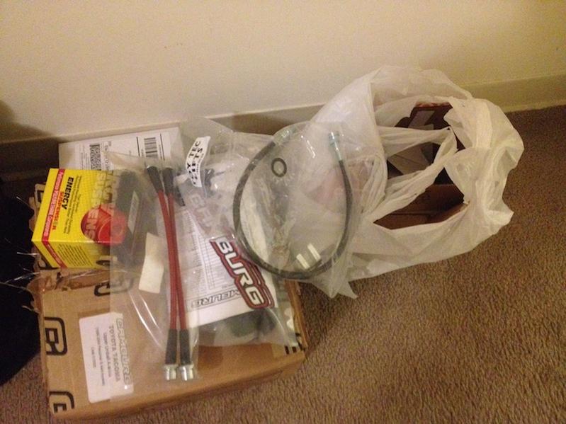

Finally all the parts came in. Now I just have to wait till monday to have them put on. Its been 20 days since ive driven my 4runner which sucks since its my dd. Luckily my best friend was nice enough to let me drive Natasha (his 4runner)

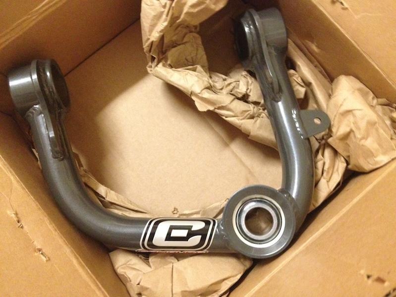

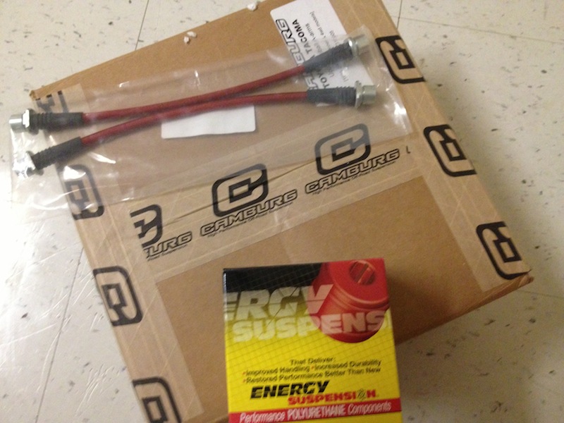

So while shes in the shop I decided to replace the outer tie rods. Heres whats going to be new on the truck after this overhaul.
Rack and pinion bushings
Outer tie rods
LCA bushings
LBJs
UCA Camburgs
Front brake lines
Extended rear brake lines
Looks really nice Kyle. I can imagine the money well invested and now you can put it all to the test! Good luck with your 4Runner, she's still a baby even with those miles!

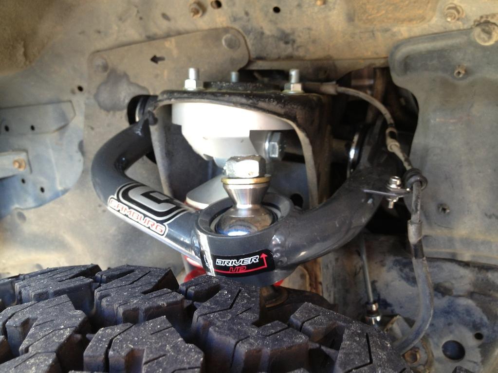

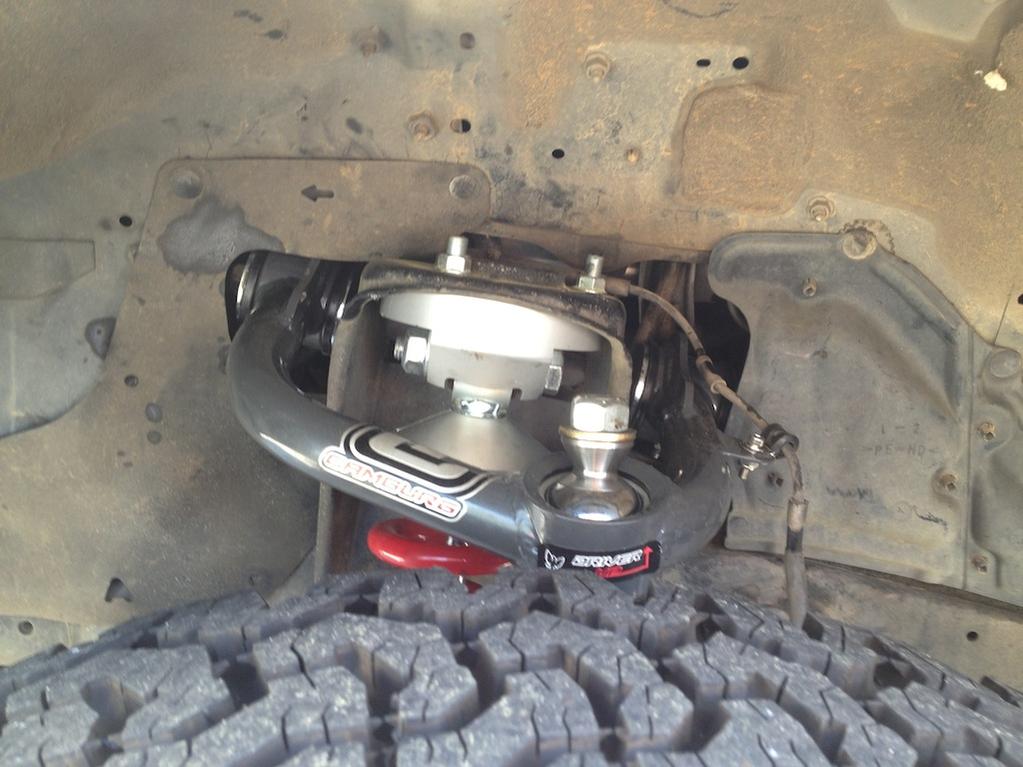

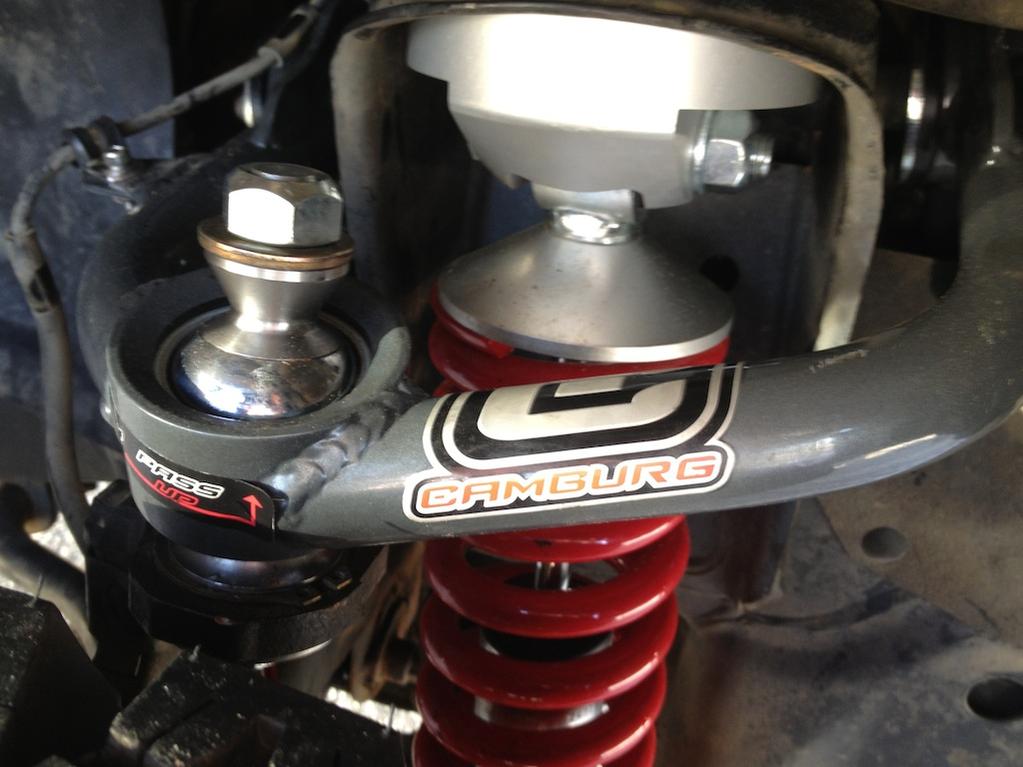

Heres some pics of the Camburgs installed.
Next on the fix list is the sway bar end links. Ether make my own (can't find the thread again) or get extended ones.

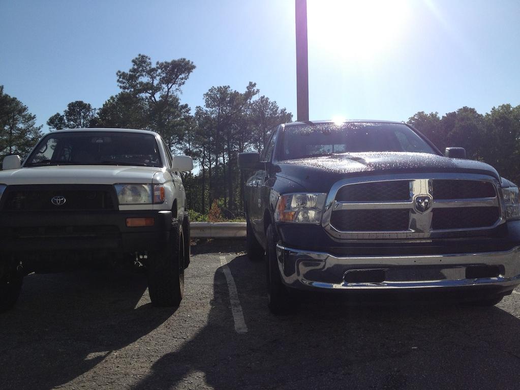

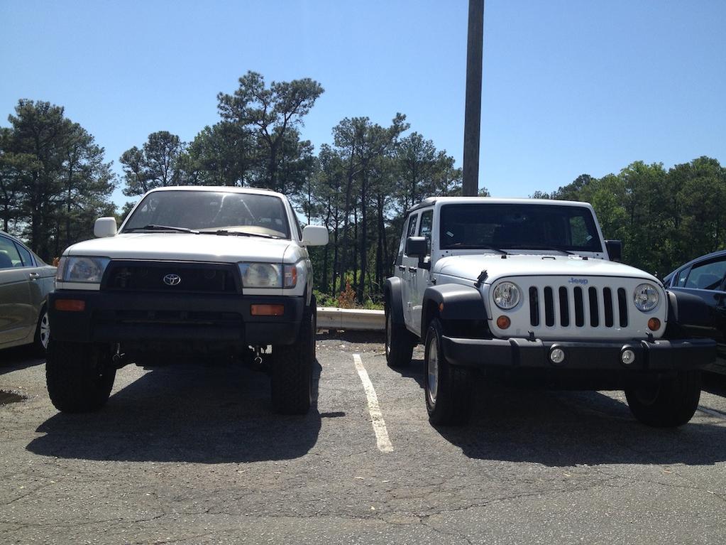

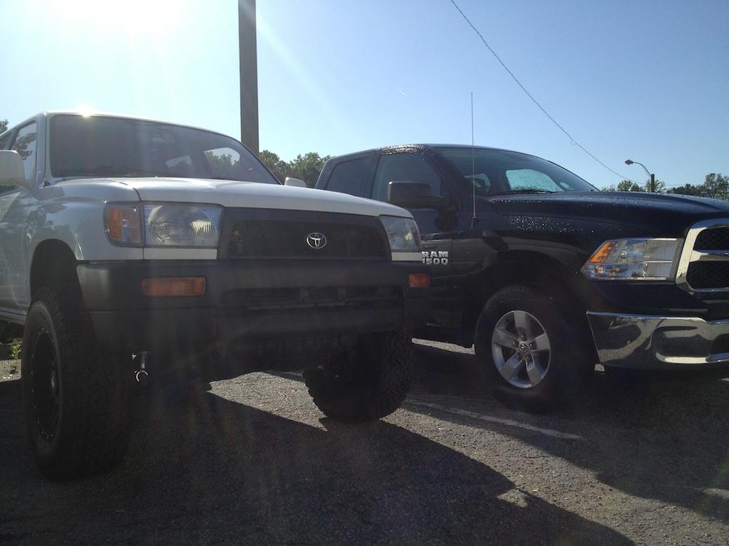

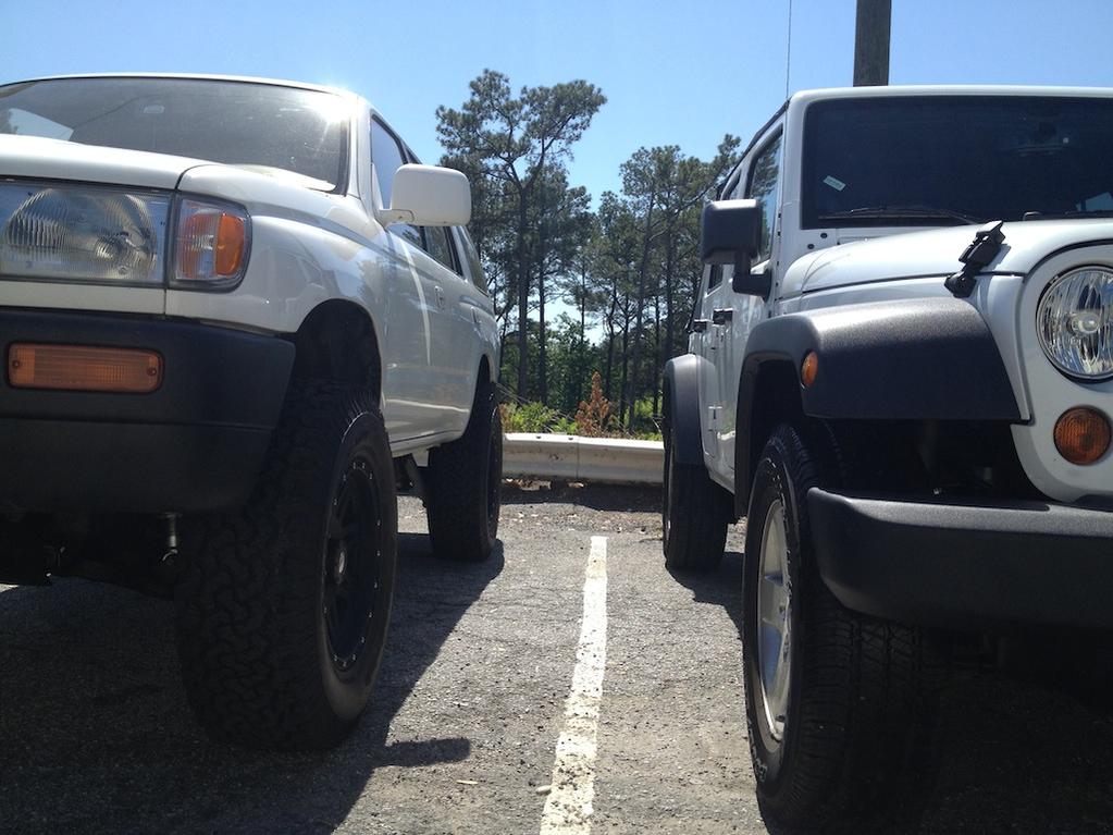

Heres some comparison pics. I parked a stock 2013 wrangler sport and 2013 Ram next to my T4R.
