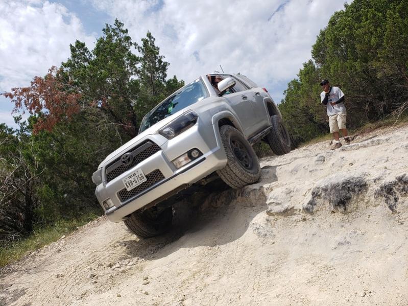

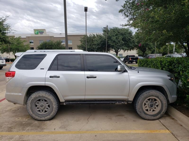

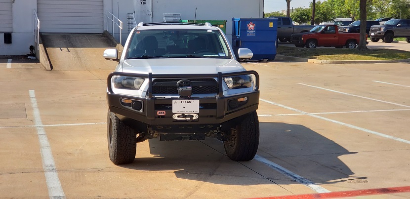

Front bumper
Well here is the ARB bumper. I think it looks pretty good. Has a 9.5k Smittybilt winch with synthetic rope.

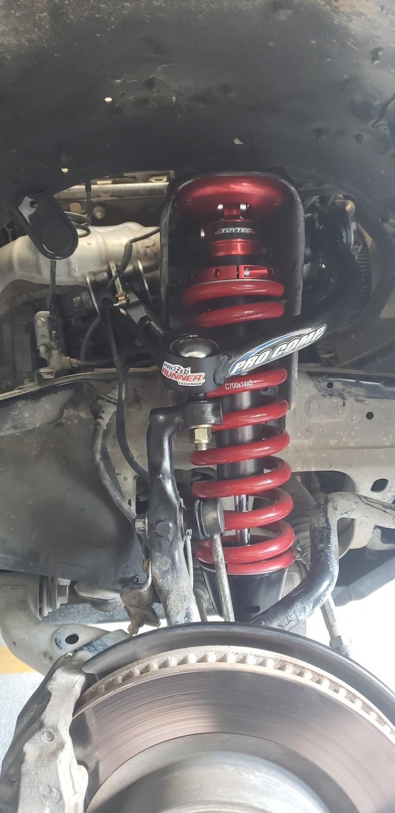

So today I added the pro comp UCA. All in all it was an easy install. The only problem I ran into was the pre drilled holes on one of the arms for the grease fittings were to large. Went to 4wheel parts to exchange them and they just put in a larger fitting. This is a QC issue but it seemed to be the only one. I will be having the alignment done this week.
Next on my list is to add a ARB compressor and the pro comp side shooter style lights.... I hate running wires.
So something I was worried about when looking at shocks and UCA's was clearance with my tires. Now my wheels have a back space of 5.71 inches and when looking at the Icon shocks they specified a back space of 4.75 in. Not sure why it matters when the coil over isn't anywhere close to the tire, maybe I am missing something
So if you look at my spindle you can see that the little bump that sticks out is shiny, my tire sidewall is about 1/8th of an inch or less from that bump. I am pretty sure that it has rubbed at some point most likely while off-road driving at lower psi. Anyhow, I think that my set up is as close to the spindle as you can get with 285/70/17.
Another note, the Pro Comp UCA's do have better clearance then the stock UCA's.

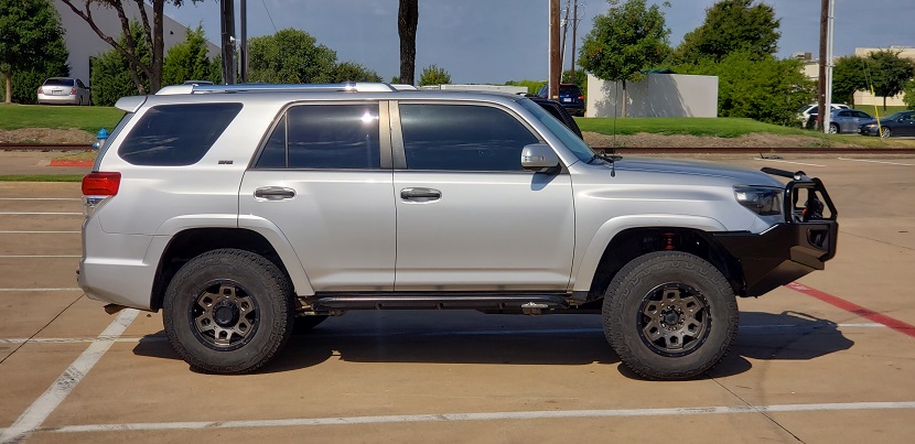

Well today I installed my ARB compressor and Pro Comp lights.
For the compressor I am not overly impressed with it. Specifically the way it is wired. I would much prefer the the power supply wire be located in the engine bay rather then in the cab.
The lights were fairly easy and straight forward.
Both kits had wiring harnesses that simplified the installation but the Pro Comp lights were easier of the two.
I think my next step will be to add an external air fitting so that I won't have to open the hood. I think it will be installed at the bumper.
