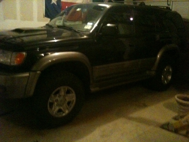

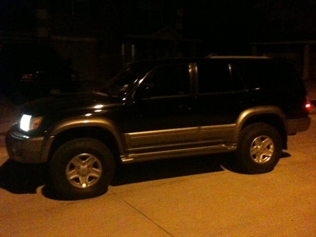

I'm going to document my build thread here. It's going to be a slow process, but I hope to include lots of pictures. I am a visual learner and I can hopefully help a few others out. Here are the current specs:
V6 3.4 L
4x4 Electronic Locking Diff
4.56 Gear Ratio
142 K Miles
Limited Sports Edition

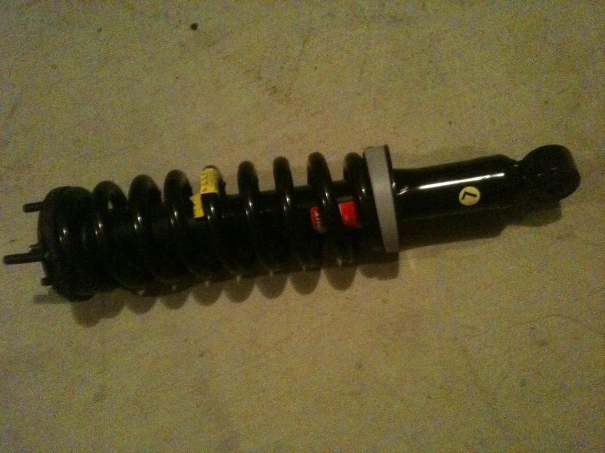

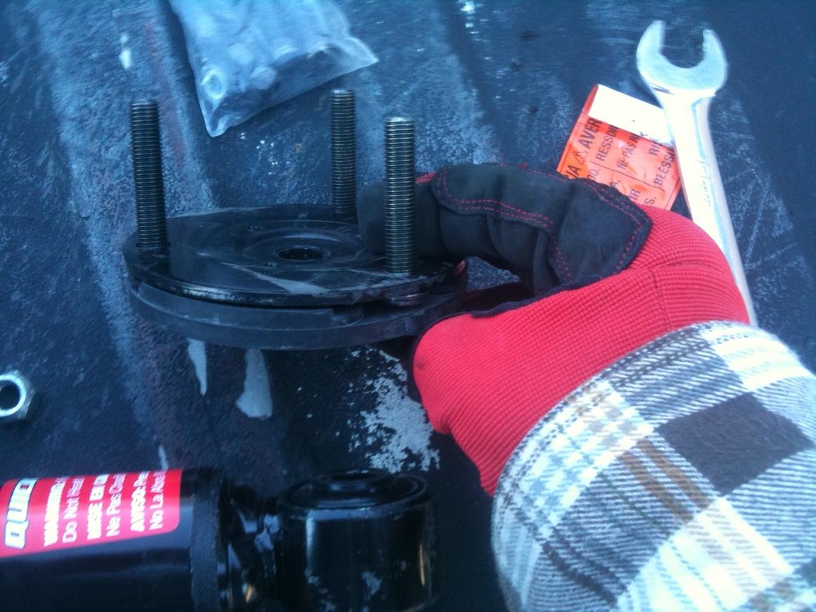

Already have purchased and ready to install Daystar 2.5 lift, Toytec 1' Diff Drop, Monroe QuickStruts, and Monroe Sensatrac Rear Shocks.

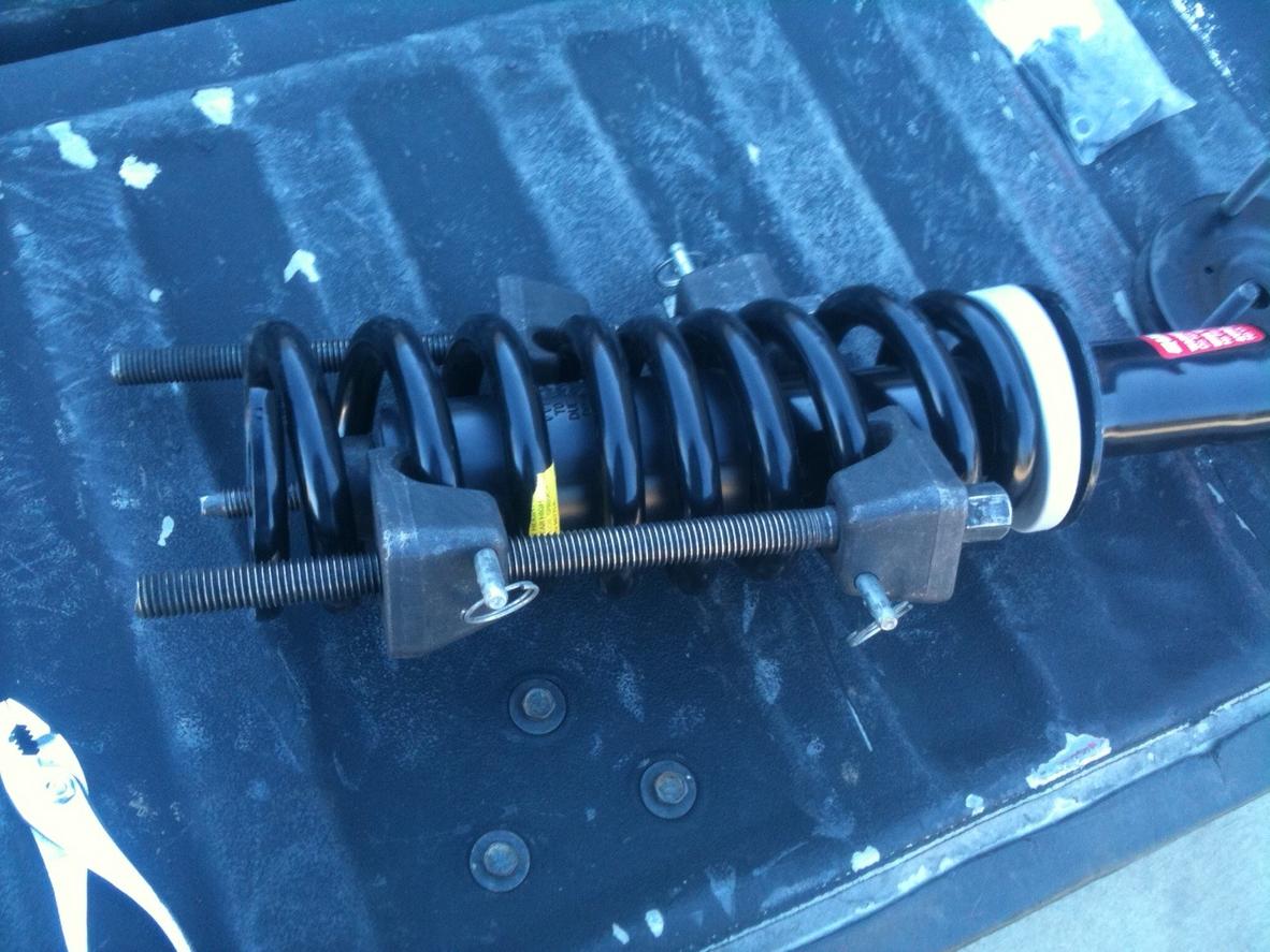

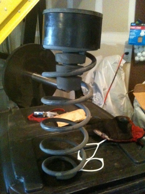

I bought the Quickstruts so that I wouldn't have to compress the coil springs while replacing the struts and installing the spacer lift. That didn't work out so well since you need the longer bolts when installing the spacers. I tried using the Auto Zone spring compressors but those are garbage. Luckily I have a mechanic that I use pretty often for my F-250 and he let me use his spring compressor which made things simple.

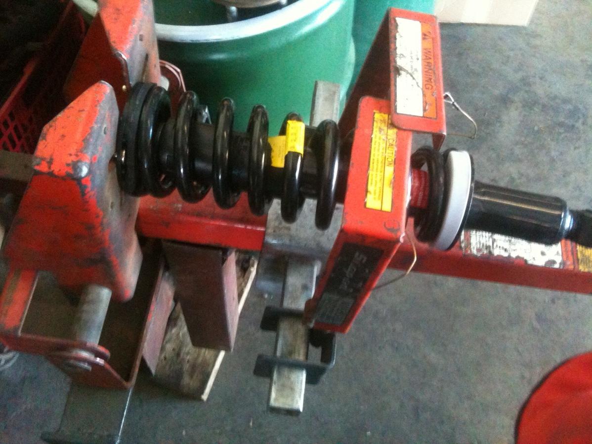

I'm hoping I can find a shop around here to compress my coils and assemble my struts. I'm definitely not using the death trap AutoZone compressors. If I can't find someone to do it for a reasonable price around here I'll just buy one of the clamshell compressors.

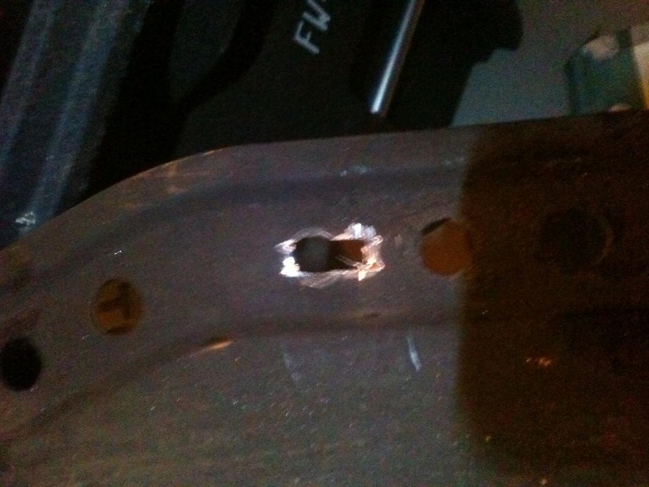

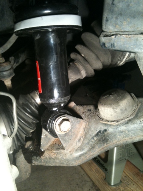

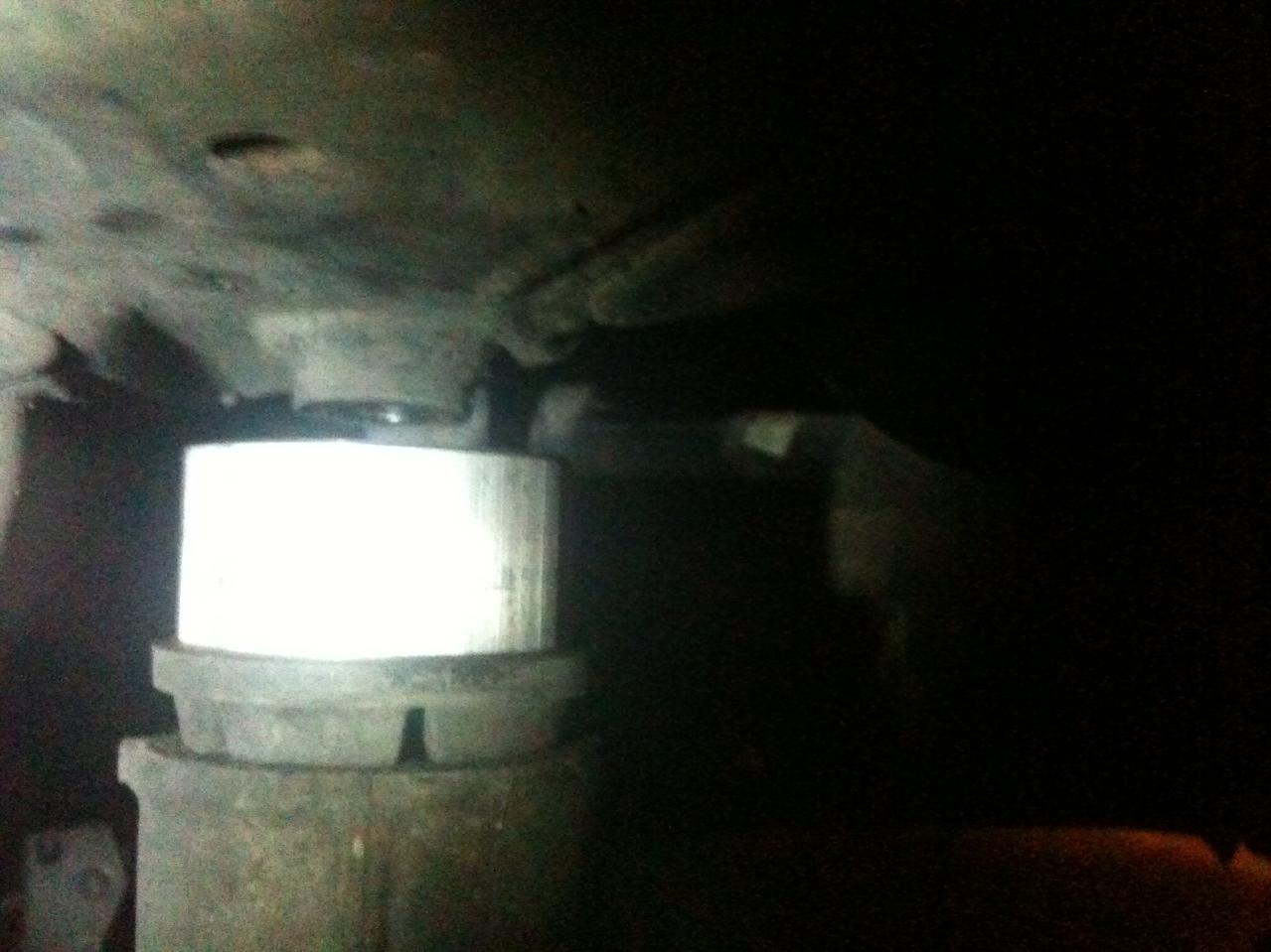

A few updates and pictures on the differential drop.
  1. The entire job took my 1.5-2 hours from the time I jacked the truck up to the time I let it down. Including removing and reinstalling the factory skid plates. I did this job solo. I could see cutting the time in half it you did it with a buddy.
  2. I needed a 25' break bar which I got for 12 bucks from Harbor Freight Tools
  3. The instructions were pretty easy from Toytec, however I did have to trim my factory skid in the 2 back bolts to make it fit. No big deal though.
The trickiest thing was maneuvering a pair of vice grips in the top bolt while breaking and reinstalling the new longer bolts.
One question I have for you experts... Check out the 3rd picture. The little hump that comes down from the frame...should that concern me with that sitting on the differential spacer and not making 100% contact? It's only making contact with about 50% of the spacer. Will that cause me trouble over time? Should I have grinded that down so that it made 100% contact between the frame and the spacer?
I guess instead of a 1 in differential drop it is really more like 1.5 in drop.

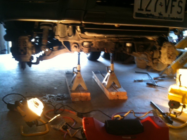

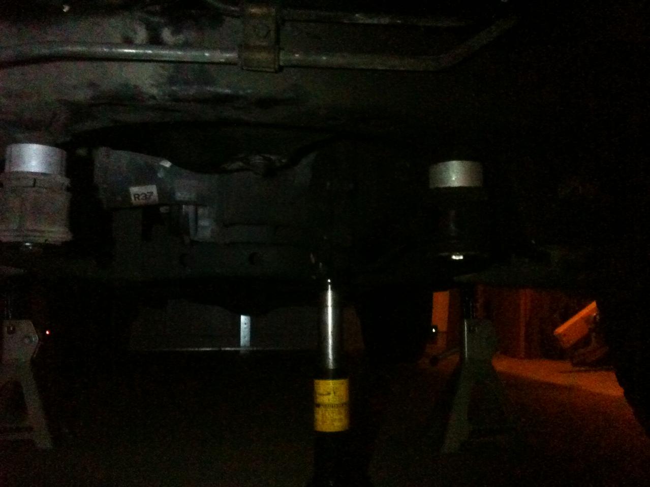

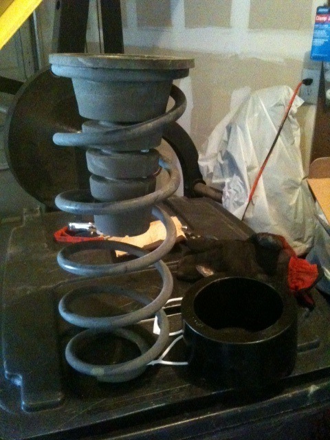

Welp, the lift is completed. Lots of sweat, grease, music, but luckily no blood. There is not alot of help out there for installing one of these yourself. Here is the best one I found... Daystar (Spacer) installation on 4Runner with XREAS - Toyota 120 Platforms Forum
It took me about 6.5 hrs yesterday to do the rear. I was doing this solo and for the first time so it was a learning experience. The problem yesterday was when I disconnected the panhard bar it "shrunk" on me. I had to drill a new hole in the frame side to make it fit. I fought that dang thing for 2.5 hrs before I gave up and drilled a new hole. If I had drilled a hole in the axle side it wouldn't have enough meat there to that's why I did that.
Also, PB Blaster is legit. I was jamming to Old Crow Medicine Show while working and over torqued the lower bolt on the shock, and snapped that booger off a 1/4 in inside the housing. I sprayed PB Blaster in there several times over the span of 1.5 hrs and then I took a normal drill bit, switched it in reverse and backed that bad boy out. I was elated!!

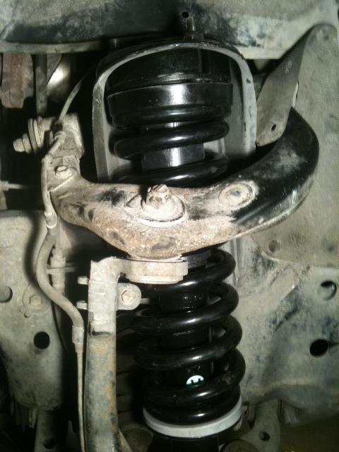

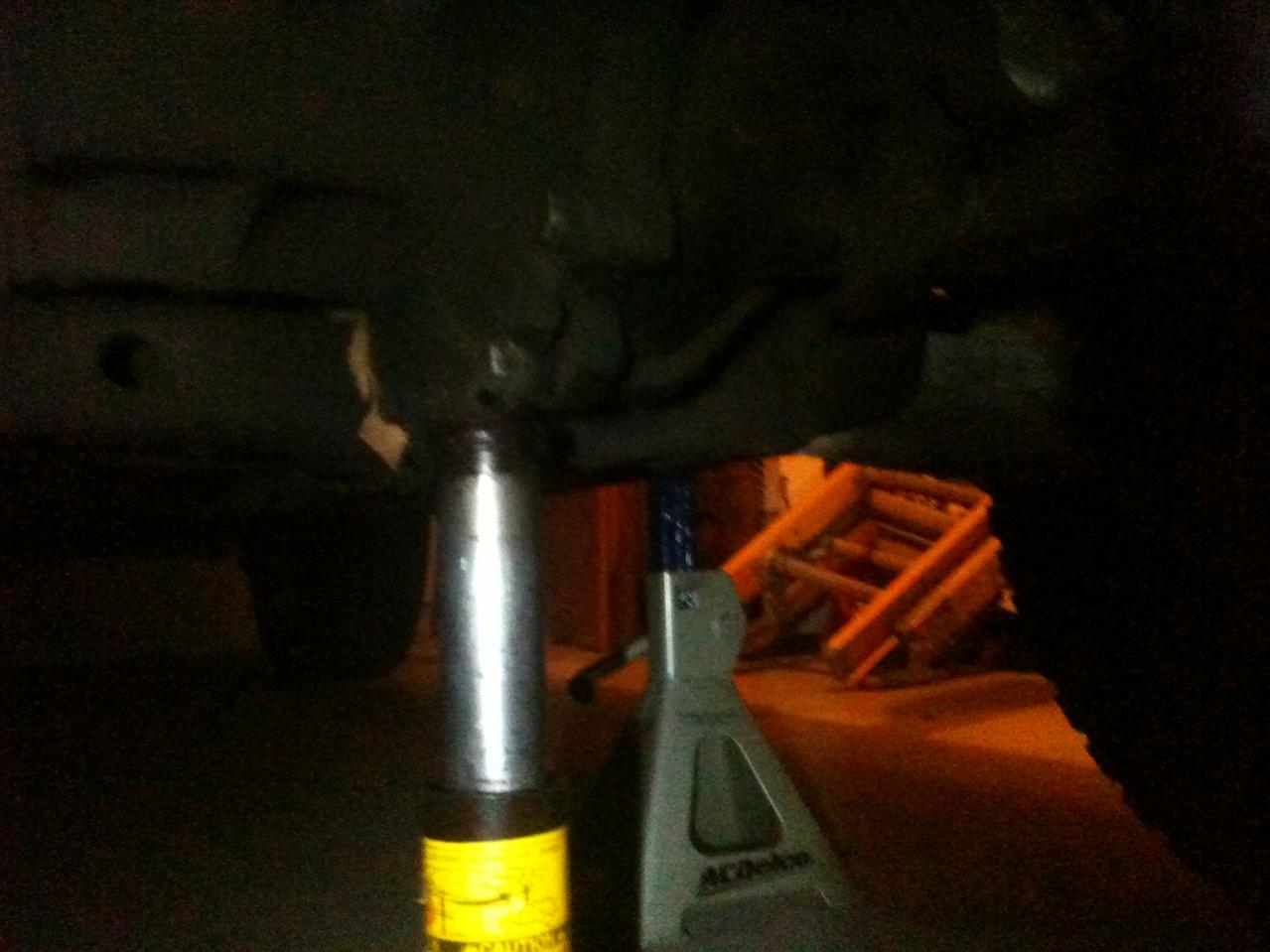

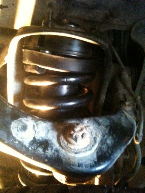

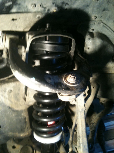

After an hour break for dinner I started on the front. I jot it jacked up, tires off, and loosened the sway bars. DO NOT disconnect these. Just loosen them, bc you can't get them back on once the spacers are in. Loosen and then tighten when the spacer are on.
In fact just throw away the directions away as soon as you get them from DayStar. Use these directions from DUHOCKEY...that's all you need. Wish I had gotten them before I was finished.
to get the coilovers out, you undo the sway bar, loosen just the three nuts not the center one. take out the lower shock bolt and then take off the 3 nuts on top. use a bar, put it between the upper control arm into the engine compartment and have someone pull down on it and you should be able to pop them right out.

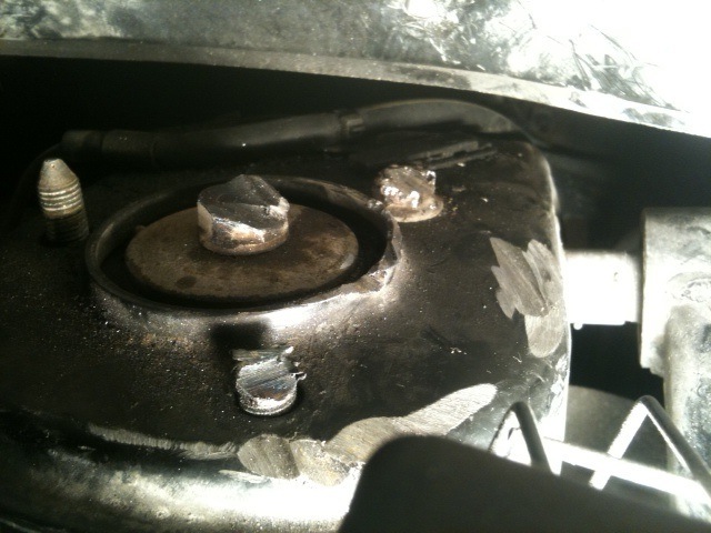

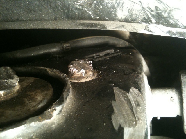

Took me about 4.5 hours today. My big screw up this time was those dang bolts that hold the strut mount at the top. That one in the back was a mother to get out. I stripped it the pieces, then tried to use and angle grinder to cut it off, you can imagine how that worked.
I reached out to the masses but to no avail. I called a welder on Craigslist and he came over, torched the SOB and sent it back to HELL where it came from. From there it was smooth sailing.
Front assembly 1.jpgfront assembly 2.jpgfront assembly 3.jpgfront jacked up.jpg

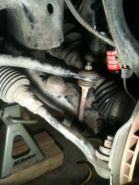

It would really be helpful and give me piece of mind if some of you self proclaimed experts, guys who have done this before, or someone who wants to be a wise guy would chime in. Take a look at the pictures I posted and tell me if everything looks as though it is where it is supposed to be. Thanks in advance.

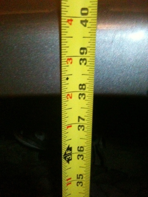

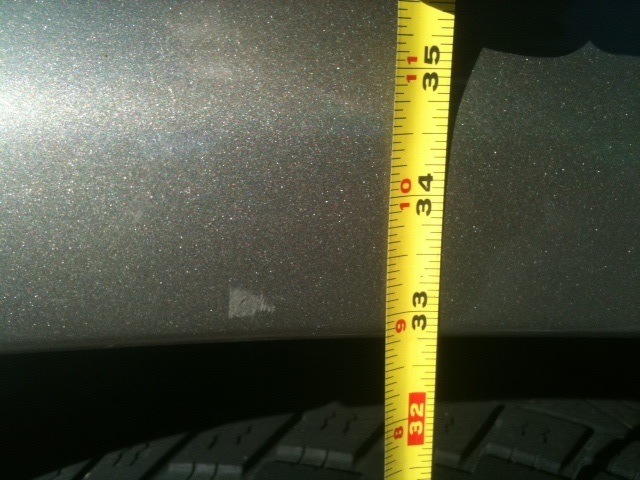

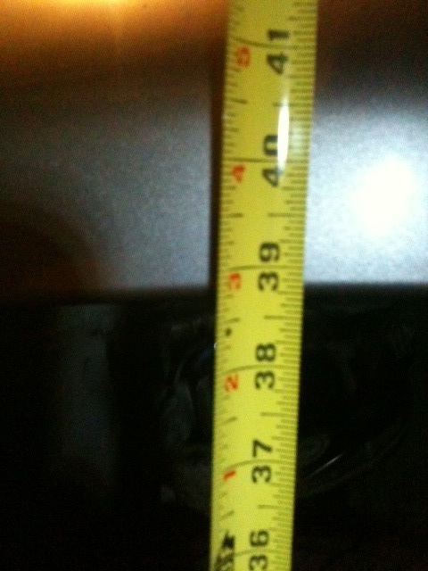

Also here are the before and after measurements...
Before Front:
Before Rear:
Now for the weird part. My front passengers side sits 3/4 of and inch higher than the front drivers side. Maybe it will settle. Basically I'm sitting 38' all the way around. The front will settle once the new coil springs are broken in.

I took it out driving a bit to see how it handled, I got it up to 80 mph and drove 12-15 miles. I measured when I got back home and the front coils had already settled 3/4 of an inch. I expect another 1/2 inch or so.
And I definitely need an alignment. It was a little scary driving with it in the current condition. Hope an alignment will fix things.
lol, thanks man, Ive done a few of these lifts now, but me and SteezeMcqueen, Ron Helmuth and Sn0wrunner messed around with mine for like 6 or 7 hours on our first try too! LOL
I completely forget cuz my sway bar is off, but someone correct me if Im wrong, but in the pics you put up of your sway bar, is your link on the wrong side of the Tie rod?? Again, Its been so long since Ive had my sway bar on I cant remember exactly, but that pic sent off warning signs.
everything else seems good from the pics.

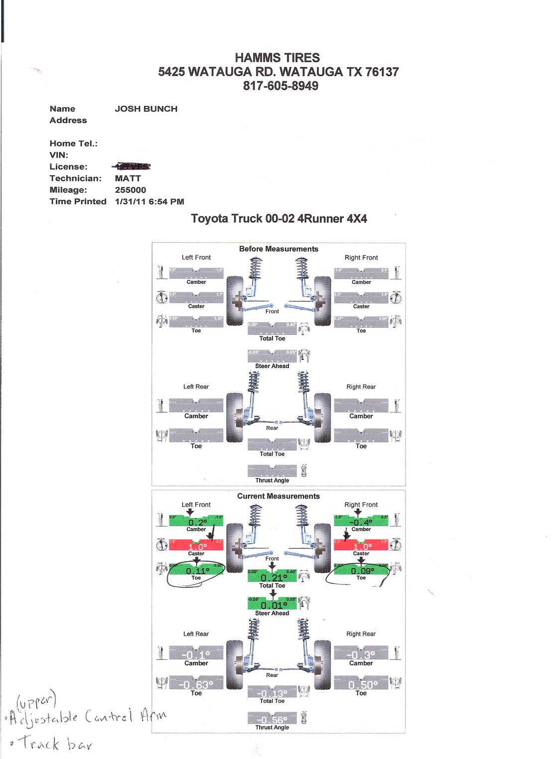

Went and had my alignment Yesterday and while the guys were trying to adjust the bolts between the inner and outer tie rods on the drivers side they broke it. Well almost. I had to go to 2 different parts stores after calling around. One store for the inner, and another for the outter. Set me back $126. Then I needed it done quicker than I usually would have so I took it to my mechanic and he changed it out for me in under 1/2 hour. To get the boot off he put it in a bench vice and used an air chisel the rotate it. after about 10 minutes of struggling I told him to just cut it in half.
Went back to the alignment shop and completed the alignment minus the caster which is 1 degree off on each side. The guy doing the alignment says he adjusted it as much as he could. He says I have to get adjustable UCA's to align everything back up. They don't sell that stuff or install it, so they don't have a dog in the fight, and I don't know any better. Let me know what you think. It doesn't seem to effect the driving what so ever but could effect wear on the tires. I am however pretty religious about getting the tired rotated every 3-5K mile. Every time I change my oil. I got 85K out if my last TOYO's
Also I drilled a hole 3/8 to the middle of the vehicle on the frame side when reinstalling the panhard bar. Apparently this threw things off on the rear end bc, they told be I was going to have to get an adjustable panhard bar to put my truck back in line.
Also does anyone know where I can find an adjustable panhard bar besides from here: 4Runner - Fully Adjustable Trac/PanHard Bar (1996 to 2002) - $175.00 : Sonoran Steel, Sonoran Steel Custom Metal Fabrication L.L.C. Custom Toyota Truck Parts
Seems a little steep. Looks like a good product, I would just like to save some cash. Especially since I'll have to find someone to weld washers over the original holes so it stays put.
