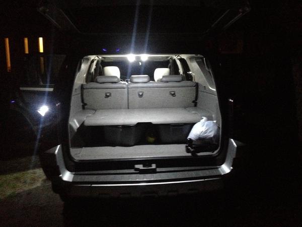

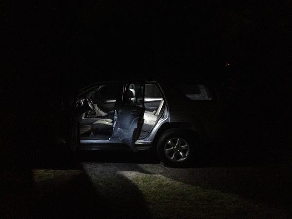

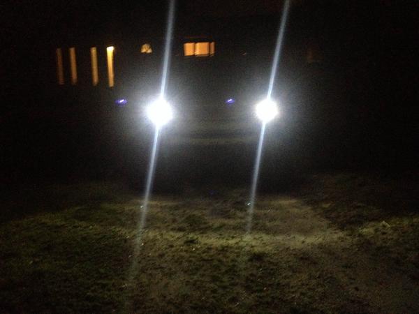

Lights
So... while I was waiting on parts for the front end, I decided to fix a few things that annoy me about the truck. I started with the reverse lights. The stock ones were simply useless.
And when I was ordering them from Lightbeauty I thought, why not throw a brighter light in the back? I'm in and out of there a bit and would love to be able to see everything... Next thing I knew, I had decided I wanted LEDs in the entire interior (map, dome, doors). He was a pleasure to work with and was very quick to get em out to me. We'll see if the LED bug has bit me if/ when I decide the dash needs an update...
I'm waiting on parts from the local Toyota dealer to add a grab handle on the driver's side (the "missing" roof one). I just got the ICON portion of the front end suspension... just waiting on the TC UCAs. Hopefully I'll be able to install it the first weekend in April. :) I'll put up some pretty pictures (well- the best my phone can do anyway) once it's in there!
