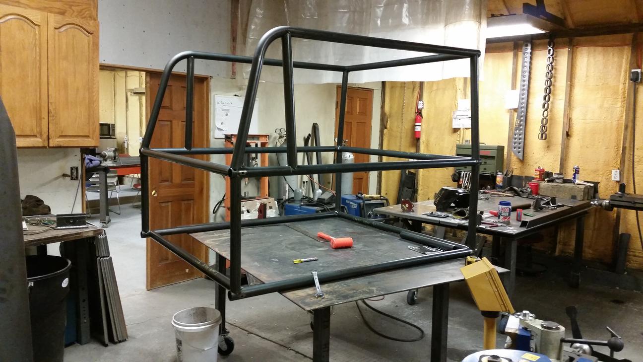

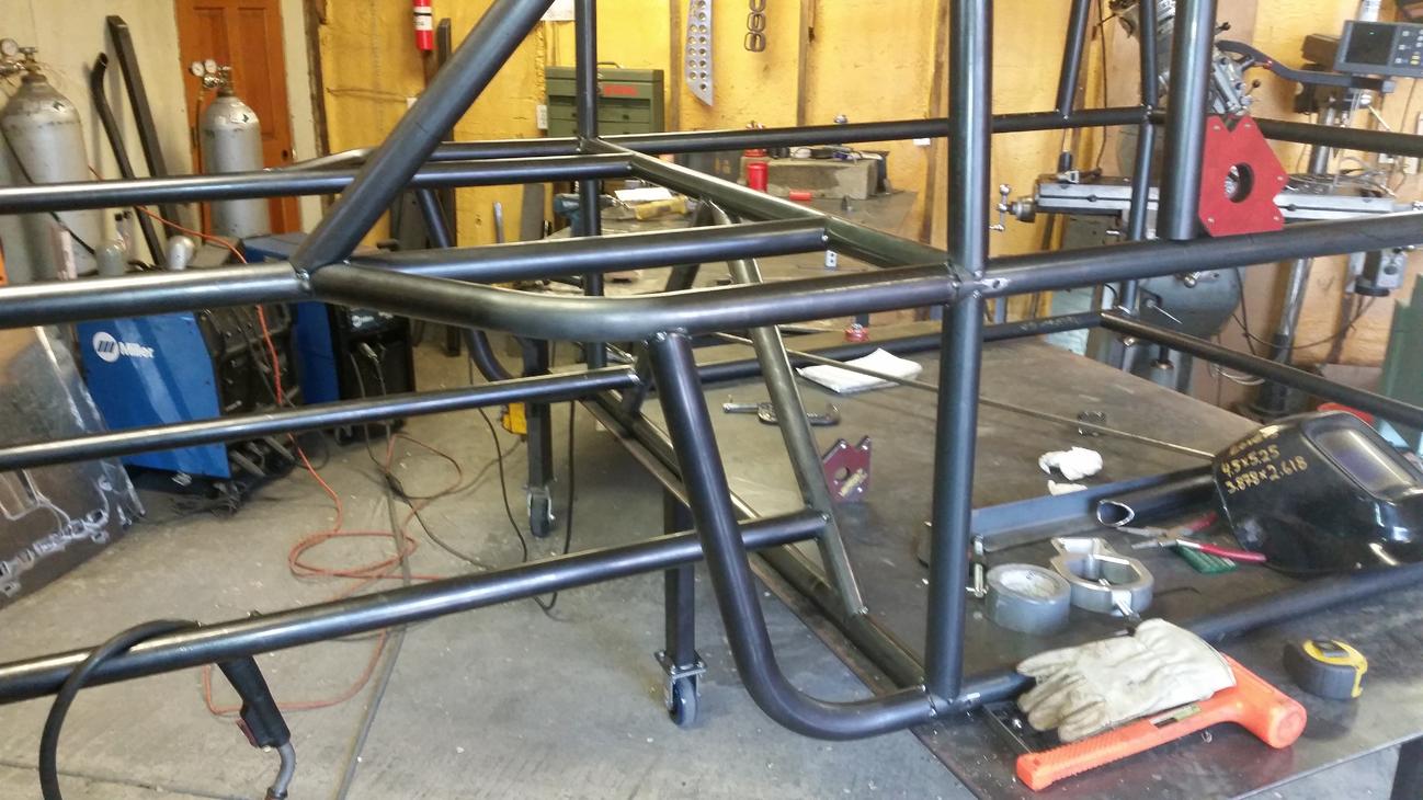

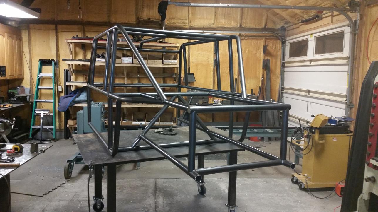

Here's a few pics of a fun little crawler buggy I'm building. It'll run toyota 22re engine, 5 speed r151f tranny, dual transfer cases, 4 link with air shocks front and rear and full hydraulic steering. It'll be a 2 seater, but the chassis is long, like an extra cab.

Dude.... This is going to be SWEET!

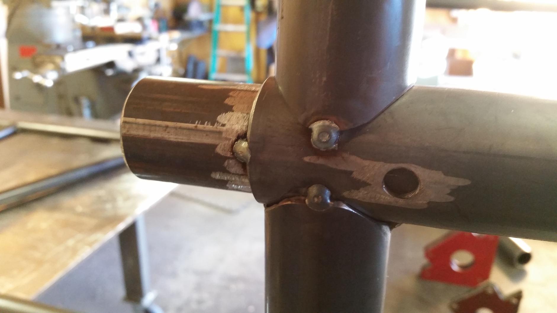

Man, there are a lot of connections/joints on that. Wont be as strong as it could using continuous lengths where you can
They're called nodes. Every one gets a slug, and multiple rosette welds to ensure they never seperate. It's very common, and necessary. The perimeter of this car will be over 30 ft of tube, an unworkable number for a few reasons. Also, it's much easier to ensure that the chassis is square an true by avoiding compound bends wherever possible.
Dual transfer case gearing is twice as low, and I can still use single low if I don't need to crawl too slow.

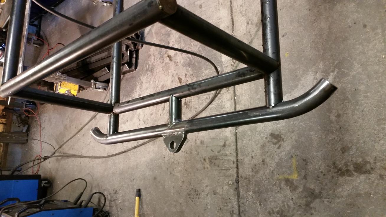

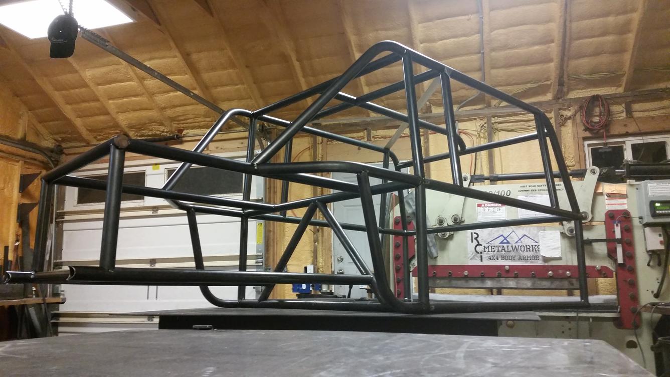

Here's a few more from today. Nice area for fuel cell and cargo. This will be able to haul a good bit of camping gear, looking like 115" wheelbase. So far, only 2 bends, the notch method allows you to square everything up perfectly.

You know more than me. I just know that chit wouldn't fly in a drag car. Were talking about lives here. I'm not bashing...as stated, you know more about this than I do.
Maybe thats why rock crawlers have, like, a rediculous amount of tubes, bent all different directions and such? To strengthen the 'nodes' and joint areas?
Exactly, every tube is tied into multiple other tubes. When it's all done, you can't even tell where the joints are. Good discussion, I enjoy it.
Apparently bends are technically weaker than straight tubing (I'm not entirely sure if I agree with that consensus as combining arches and nodes I would imagine would provide better load distribution with less material than tons of straight tubing and nodes), so Node construction is used to maximize the use of straight tubing and reinforcement.
This actually makes a lot of sense when you think about the varying forces the frame will sustain in varying situations. With proper material, welding, and design the force of impacts and stress should be directed along the tubes and into the nodes where they will be strongest, vs. in the tubes themselves where they could buckle. Ideally you use Triangles anywhere and everywhere you can; Triangles are your friend. They are one of the best ways to distribute loads and can take a lot more punishment from various directions than a square. In places where a triangle cannot be used or is not desired (i.e. for an aesthetic or practical choice like for passenger seating and/or doors, ect.) plate or tube gussets should be used.

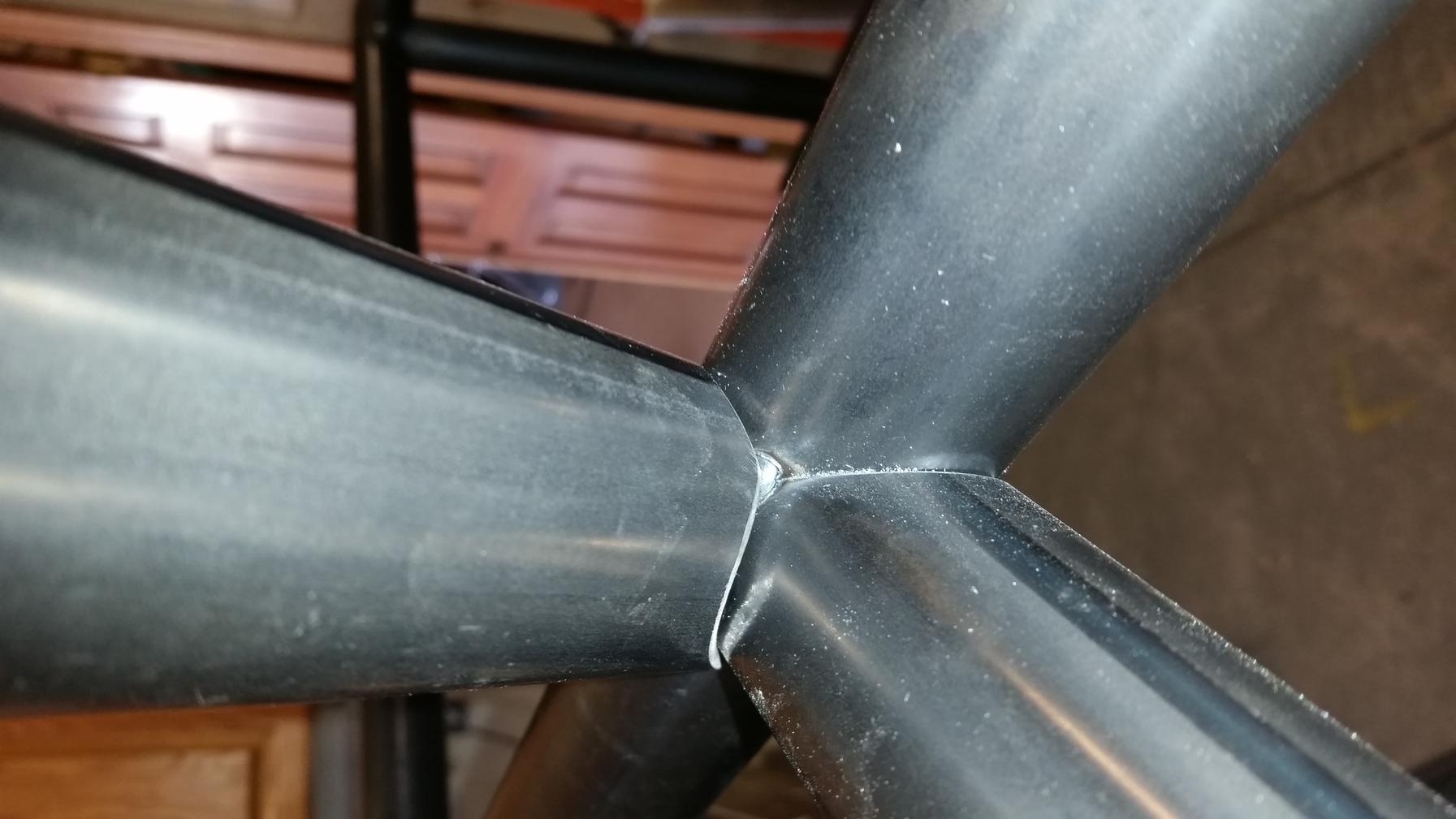

A close up of a node joint using TIG, what you don't see is that each tube is welded as it's layered like a puzzle, creating a strong load bearing joint.
Personally I would want go with a Halo-Bar Type build and use one or two long "perimeter" tubes that are bent slightly to establish the sides of the vehicle. Then tie them to the Halo-bar on top to establish a rough shape/skeleton, before going crazy with reinforcement triangles and gussets. But that's not always viable depending on what kind of mandrel bender you're using and tubing length/size/diameter you're using. Most small scale builders are probably not going to have the bender and space to bend a 30ft tube like the OP pointed pointed out.
That's mostly right, if look at most race cars you'll see that they also utilize nodes a lot as well. Keep in mind this is the beginning stages of his frame construction. I imagine after he's squared away the perimeter and rough shape he'll go back and add additional supports and gussets to the nodes to make it solid.
...Dual transfer case gearing is twice as low, and I can still use single low if I don't need to crawl too slow.
Hmm... I was going to say "isn't that what a dual stick transfer case does?" But apparently my assumption that the second stick was an additional gear reduction was erroneous (though honestly I'm surprised it's not utilized like that.) So when you say 2 transfer cases do you mean 2 actual full chain driven units that have both input and 3 outputs? or like one is a traditional case and the other is just a gear reduction box? I'm trying to visualize how you would install two transfer cases to use as a gear reduction set.

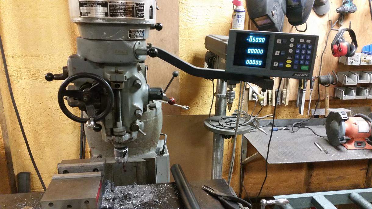

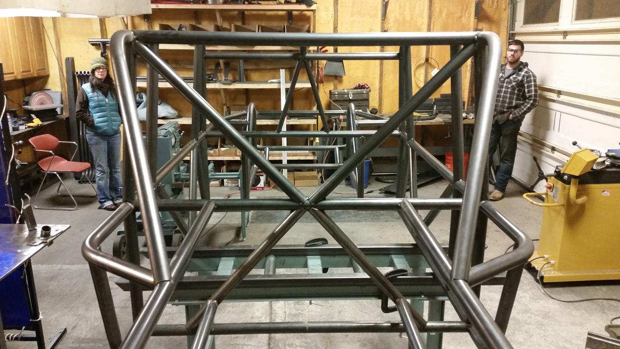

Lots of good info in that last post. For every joint on this chassis that is over lapping another joint, the first is welded 100%, also. This is the only way to go. Even with the mill, sometimes you find yourself having to do a little hand notching.

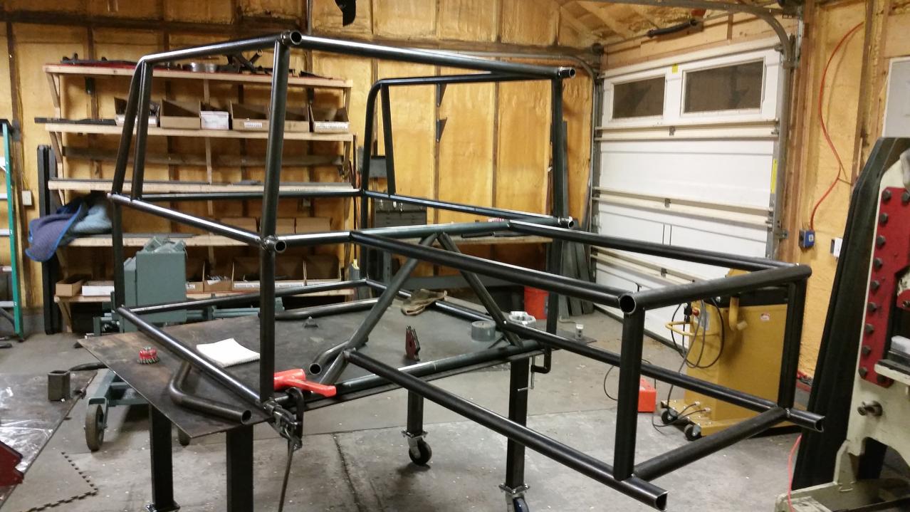

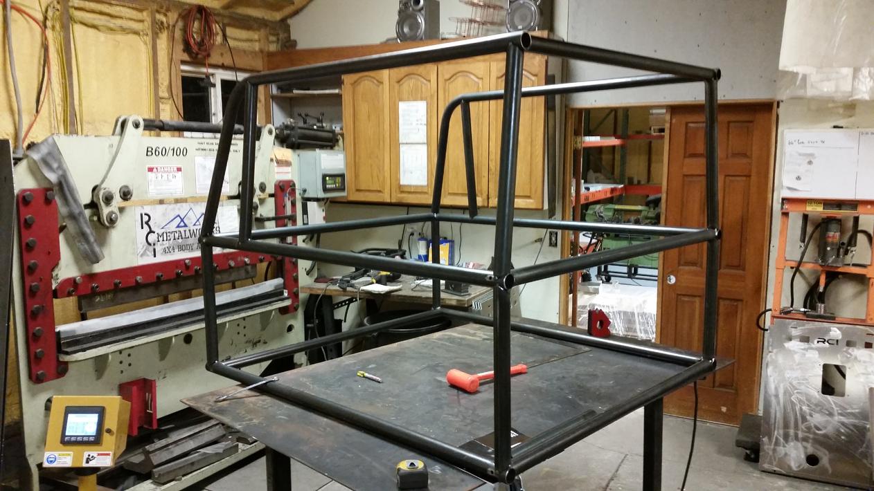

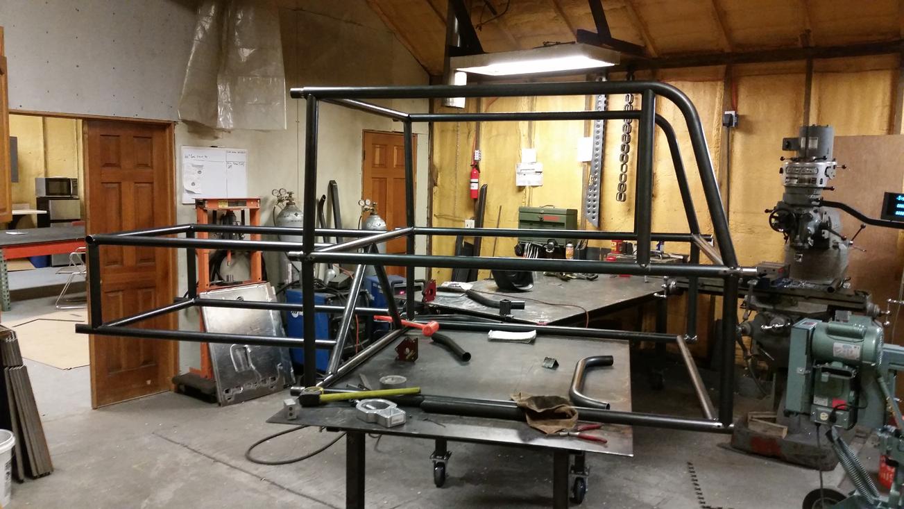

Couple more for the end of the day. Not bad for a weekend.

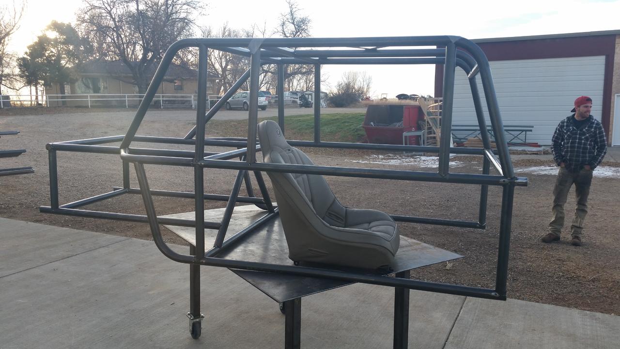

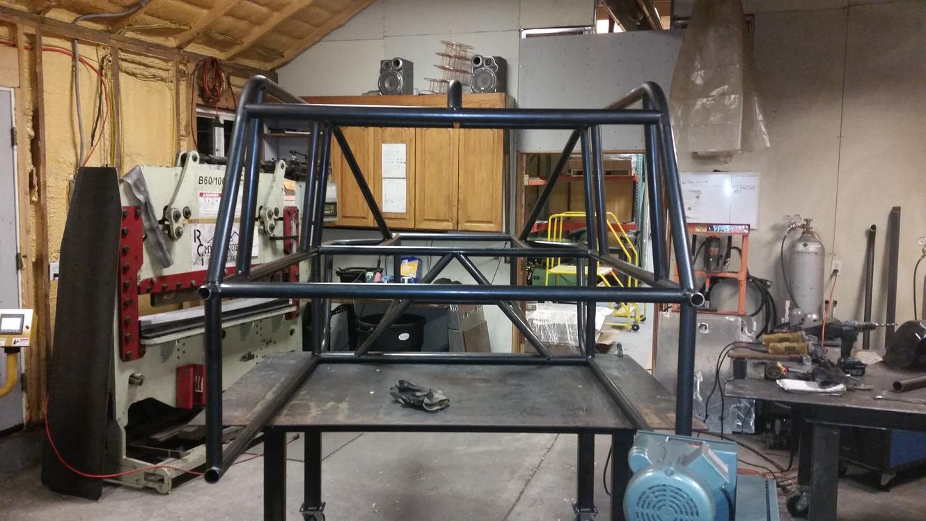

A rough idea of where the seat will be located in the cage. There will be an area behind the seats for backpacks, water bottles, camera bags, rain gear, etc. Tools, fuel cell, cooler, and recovery gear will go in the "bed".

Thanks, Aaron. I got that mill from someone you know, Carlos in Rye, CO. It's made all the difference lately. Way better than a conventional nitcher.
Yeah, I know Carlos! I've sold him some Toyota stuff a couple years back. Nice mill!!! I bet that that makes some slick notches :jaw:

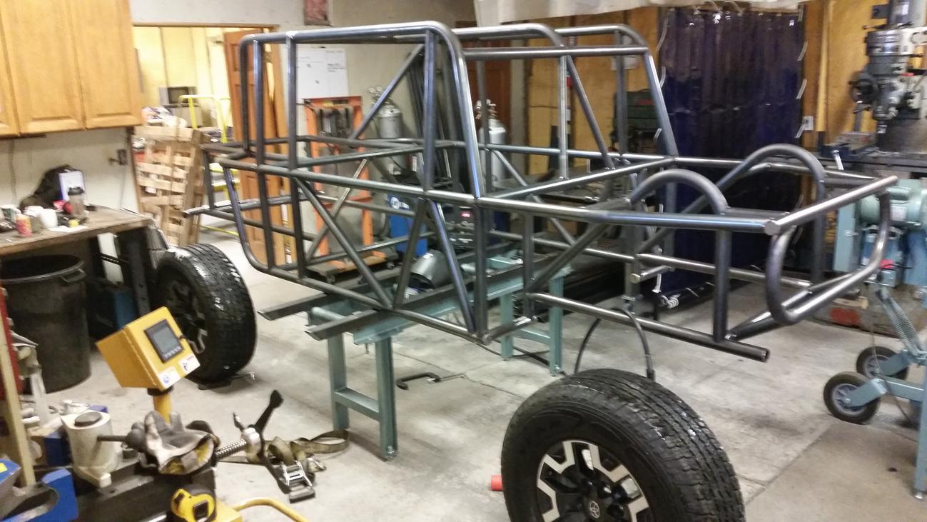

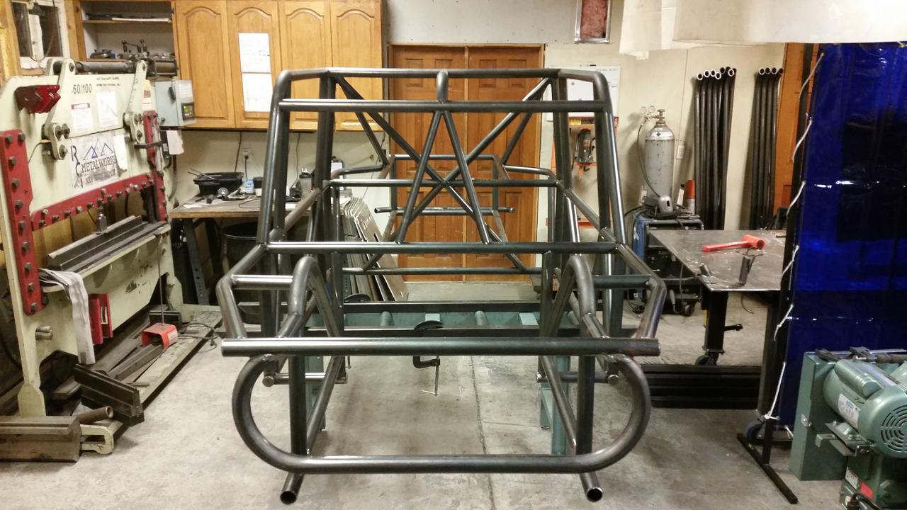

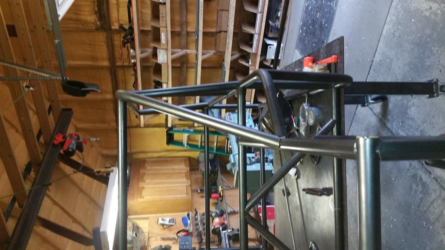

Updates! The main chassis is almost done. Went with an FJ style look for the front. Lots of cross bracing, but still more to come.

I built a Ftoy several years ago when they first came out. All Yota. 22RE converted to carb intake and propane. W56 tranny and two top shift tcases. 85 front axle with Longfield axles, welded up 4.10 gears, IFS width rear axle, leaf sprung with 38" TSLs under it. Thing was a beast and surprised a LOT of folks.
