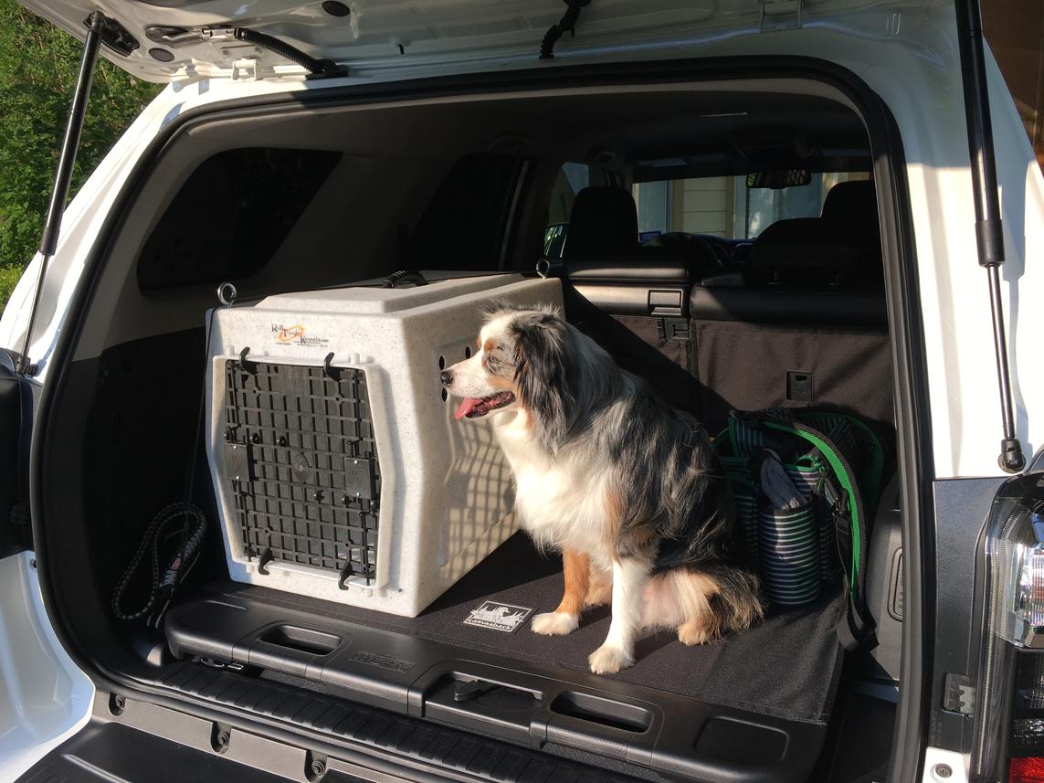

Yo! Just got my kennel today and this thing is indeed "ruff and tough". Very well built. I installed and secured it like you showed and its not going anywhere. I will attach some pics of Zeus, the mini Aussie haha. Drink of choice : Ballast Point Big Eye IPA
Aussies forever!
Awesome, looks great! I really enjoy the two we have, and haven't looked back! It's great for the pup to have her space in the 4R regardless of how much crap we pack in there. Good call on the brew, sir :cheers:
Aussies forever!
Oh, and 4Runners... And beer... And stuff.
Ha! This gave me a good laugh. Cattle dogs are awesome. And so is beer.... And so are 4Runners....
