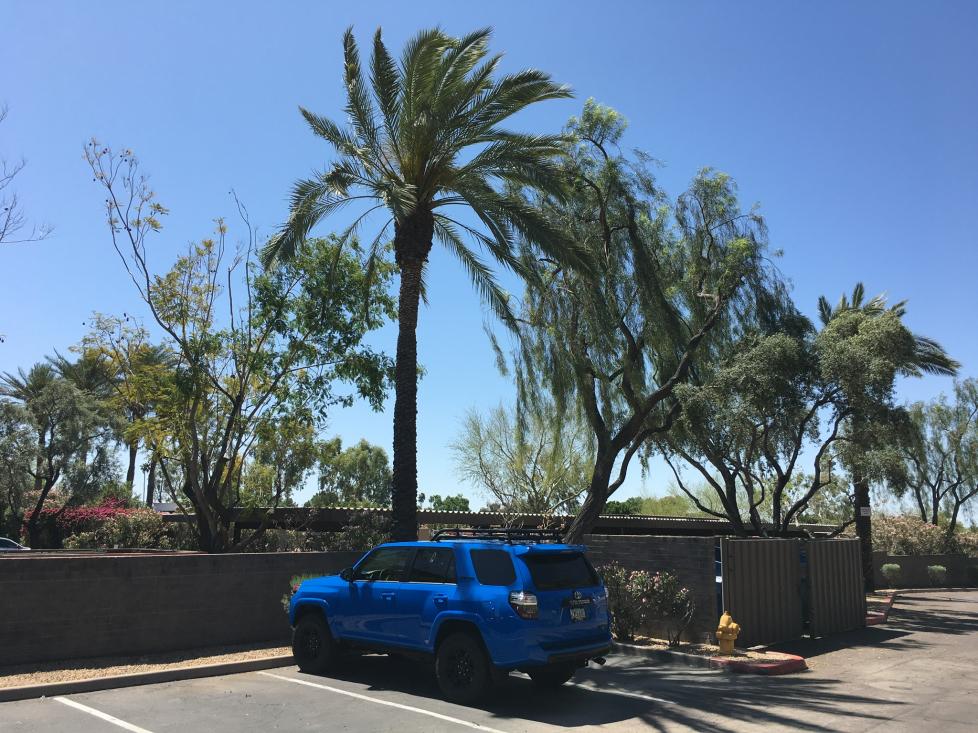

[MENTION=129593]MTN4RNR[/MENTION] if you are still out there anywhere ... in the last photo in this sequence, you show how you ran a wire under the rear carpet and then down to the rear door sill area.
Any clues on how you pulled it off? I'm trying to take the same route, but so far I've been foiled. Did you go under the carpet? Under the plastic trim on the side of the cargo area? Did you resort to witchcraft and sorcery?
Thanks if you do come and visit!
Seems many people have rear facing lights on their roof racks, which are great for lighting pretty much everything behind you... Unless you have the hatch open. To solve this, I installed a [MENTION=87816]Baja Designs[/MENTION] S2 Pro LED light in the driver side hand hold of the hatch. I first took a look at the specs, and made a paper model of the light to test the theory, and knowing that it was very close, I ordered the light to find out first hand. Considering that the light would be used to illuminate a large area I ordered the flood pattern lens and it works great. The light output is ridiculously awesome. Thankfully, this was a short install and I get it finished just in time for camping this weekend! The S2 does not require a relay, so all I had to do was run a hot wire from the battery to the hatch, and then modify both plastic hand hold pieces to make the light and the switch fit.
