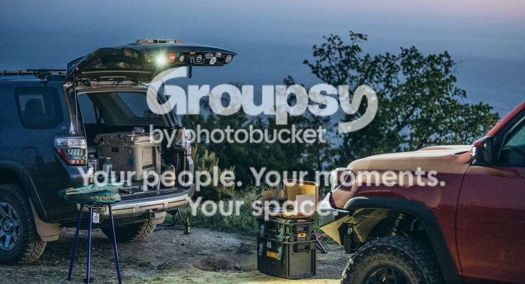

From the following weekend camping trip. This light definitely did it's job lighting up camp, and [MENTION=124732]LawnDart[/MENTION]'s rig for a sunset photo shoot
image_zpsmpvibafh.jpeg~original
DSC09461_zpsj7rd3wqe.jpg~original
Impressions
I am very pleased with the outcome of the light installation. It covers all of the requirements for my install, and the light output is awesome. This is the perfect addition to the 4Runner for anyone who spends time behind the truck at night, working, camping, or whatever. The quality of the [MENTION=87816]Baja Designs[/MENTION] light is top notch and it puts out a lot of light for it’s compact size, and in the right place with the work/flood lens. I finished this just in time for a dispersed camping trip, and will post updated photos when I come back!
