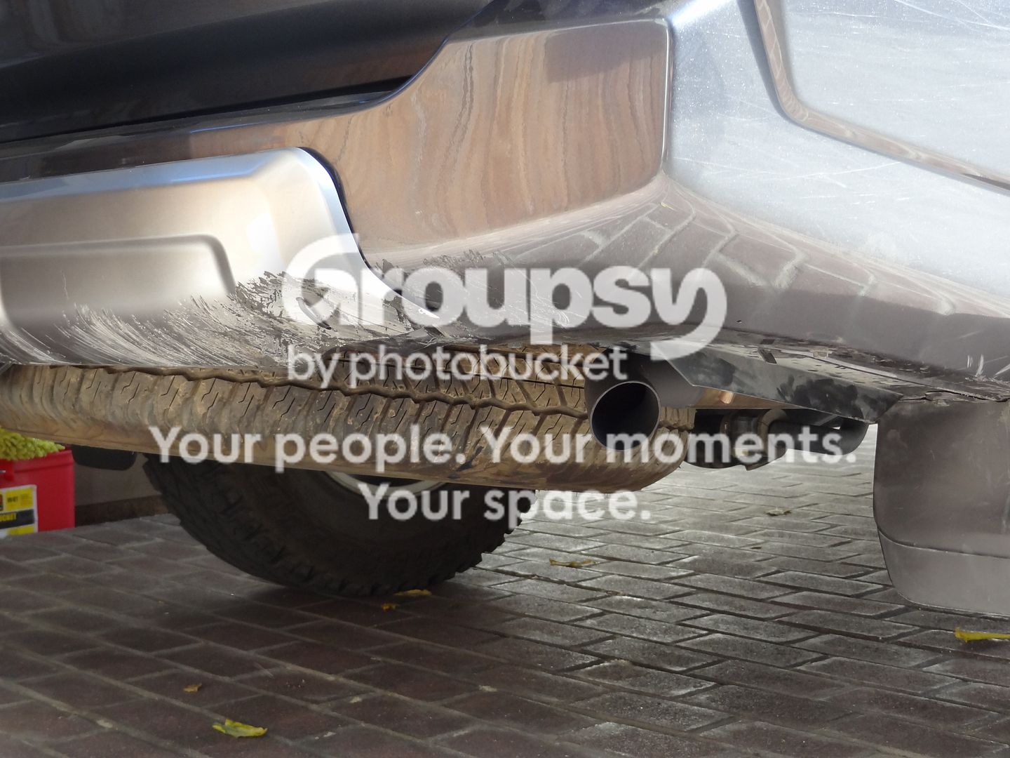

After the exhaust tip was a bit... squished... after the last trip, I took it upon myself to knock out 2 birds with one stone; cut the exhaust back for better clearance, and turn the tip out to the passenger side to eliminate exhaust fumes from entering the back window. The stock piping is 60mm, or 2.38" more or less. We made the tip out of 2.25" pipe, and the direction/angle is spot on. The fumes have been eliminated, but I am going to have this tip replaced with one that is 2.5" because when I get on the skinny, it makes a nice (and by nice I mean unappealing) whooshing noise which I think is because the tip is just slightly smaller than the stock piping. Oh well, live and learn.

Love the rear "pin stripes"
Does the side out all together eliminate the sulphur? Even a little, is tempting, I feel bad with the pooch in the back, he loves the air thru his ears but I'm sure he doesn't enjoy that smell
I earnt 'em.
So far as I can tell from today, it's 95% gone. A little wiff here and there, but not as bad as before. I will be putting some good miles in this coming weekend, so I can update you after to let you know. Fresh air for pup is a good thing.
