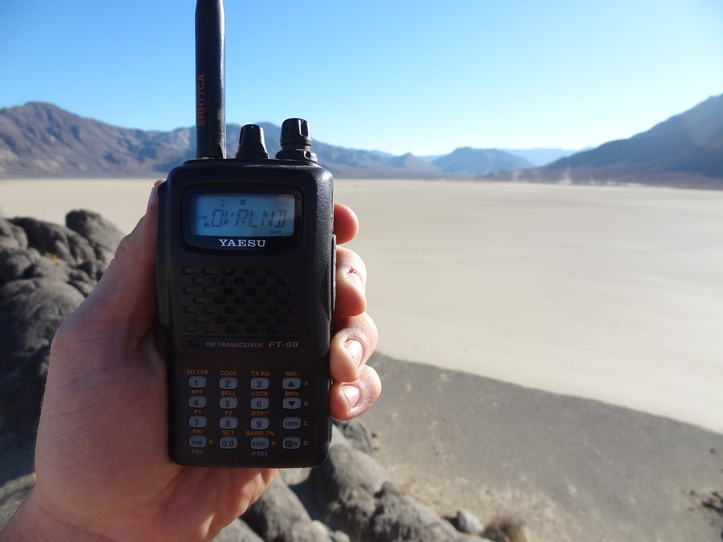

I started my HAM career with a single Yaesu FT-60r, soon after buying a second as a back-up. The reception was good for a handheld, and it was easy to get acquainted with while I was learning the basics of HAM communication. After a number of trips, and a few instances when the range wasn’t enough with the Yaesu, I realized that I wanted to upgrade to an installed mobile unit in the 4Runner. I had a short list of requirements:

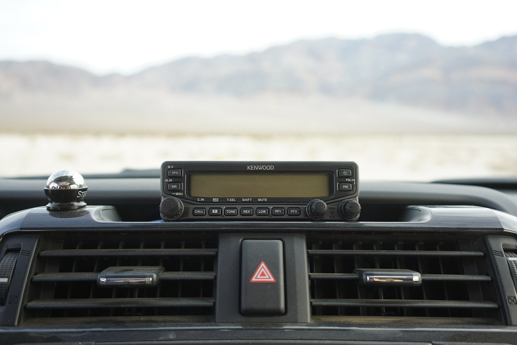

The Head Unit:

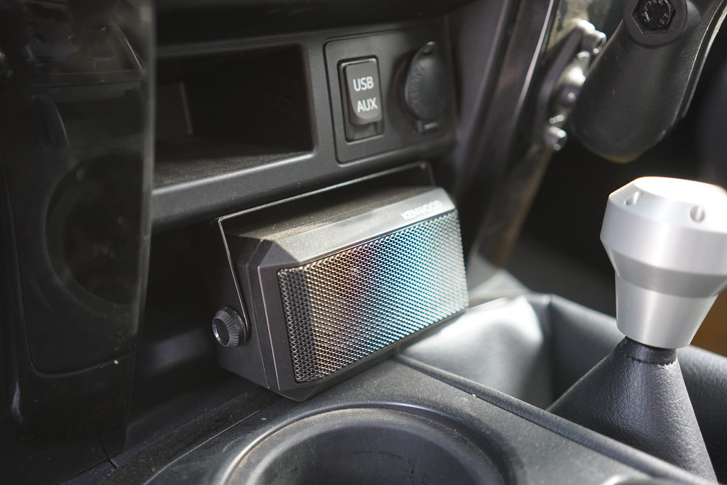

I wanted it to be in a place where I could easily see the screen, and adjust volumes/squelches without diverting my eyes from the road or the trail too much. Looking down is never a good idea, so I started looking at the top layer of the dash. To the left of the instrument panel would have meant fabbing a mount, and then having the unit be closer to a window (more of an attention grabber for would be thieves). Centered on the instrument panel, or mounted on the steering column would have been a good option if adjusting anything or pushing any of the buttons wouldn’t have required me to reach through the steering wheel, so that was out. I settled on the center of the dash, covering the clock. It’s a flat space, and with the height profile of the faceplate, it barely rises above the upper dash. I used a standard cat5e cable to extend the faceplate to it’s location, and then a female to female adapter to allow for the extension cable to connect to the provided cable which plugs into the faceplate. A pretty easy solution to extend the faceplate wherever you like!

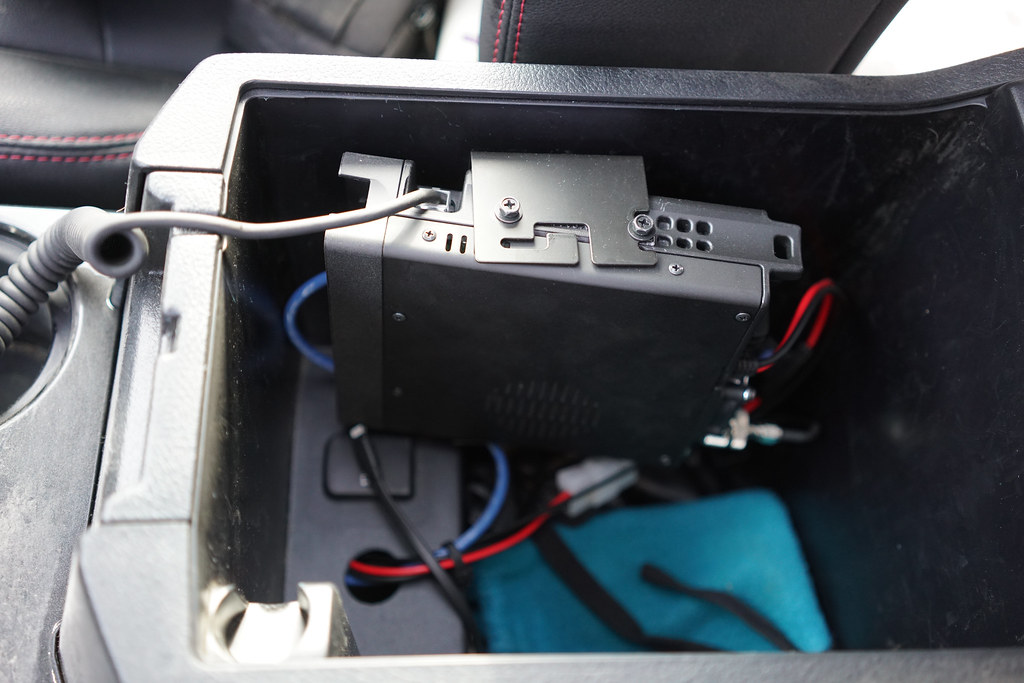

I mounted the main unit of the radio in the center console for a few reasons. First, it needed to be close enough that I could plug the microphone into and still have it conveniently reach me in the driver’s seat. Kenwood does offer a “remote kit” for their radio that includes cords to extend the faceplate, and the microphone jack. But this kit is rather expensive, so I used cat5e cable to extend the faceplate, but I didn’t want to use a non-shielded wiring setup to extend the microphone jack because the internets told me that it might effect my sound quality in the 4R and to others listening. Below the driver’s seat is the most common place to install the main unit of the radio, but with the microphone reach being an issue, that location was ruled out. So, in the center console it went. This location ended up being a great place to place the brain as it is out of view, more dust/water protected than under the seat, allows for the mic to plug in and come through the factory cord grommet in the center console, and in general it is a much cleaner installation. I used the stock mounting bracket, drilled some new holes to bring it as close to the side as possible and mounted it with 3M extreme fasteners meaning I can remove it easily if needed, and no drilling into the console aside from the grommet hole I drilled at the bottom to bring the wires through. If I were to sell the 4R, a quick plastic plug would make the hole disappear to a new owner.

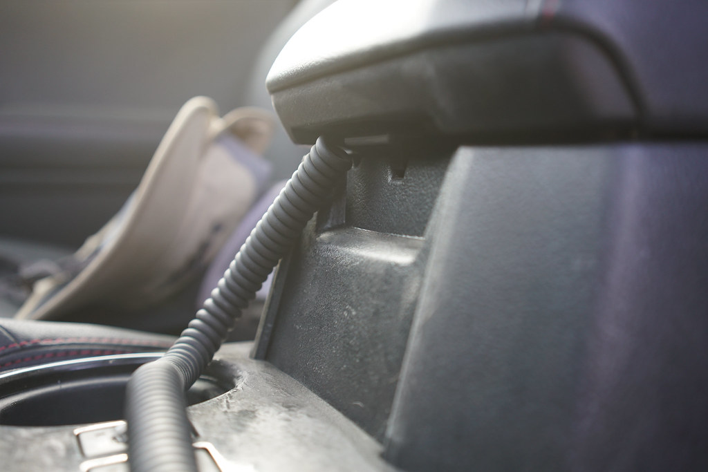

The Mic:

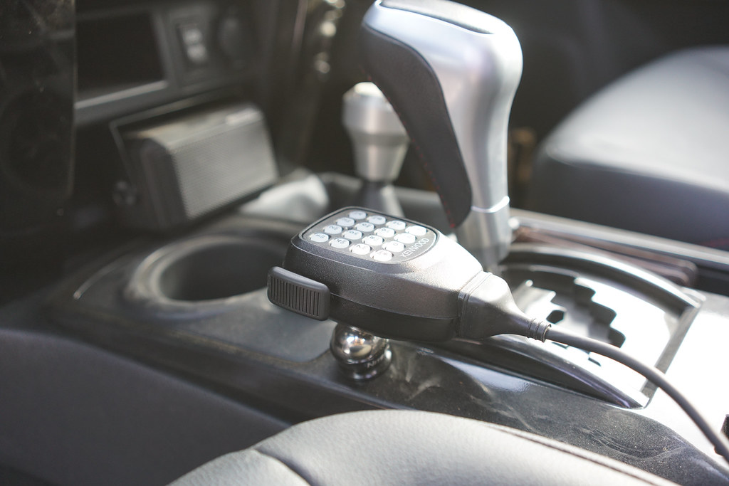

The microphone plugs into the main unit in the center console and runs through the factory grommet under the lid. I mounted the mic to a Nite-Ize Steelie mount to the left of the shifter. This allows for an easy reach to the mic, and it makes it really simple to grab and put back as there is no physical clip to slide into like the one provided with the radio. I highly recommend this mounting option because it’s so simple and convenient. When the radio isn’t in use, it fits perfectly in the kleenex holder on the lid. Incognito.

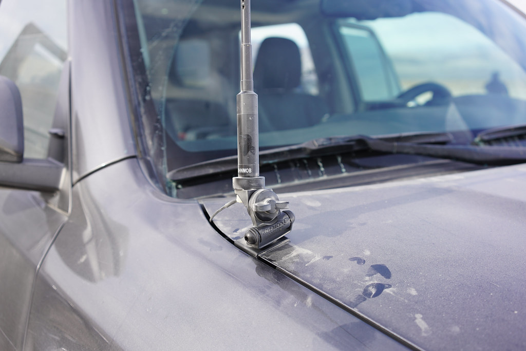

The Antenna:
I used a Diamond trunk mount to mount the antenna to the passenger side edge of the hood. This will keep the antenna in my sights as I navigate trails and trees, so I can lower or remove the antenna to avoid damage to it on the trail. My trip antenna is a 38” Diamond NMO antenna, and my everyday antenna in and around the Bay Area is a 16” Comet NMO antenna. Both have performed well and have shown good feedback on the trail and on the road.

I mounted a short antenna on the hatch door (link) because I think it looks better than on the hood. I store a longer antenna in the back for use if I need it. But if I get a lift, that hatch location might not work anymore, even with the shorter antenna. Don't want to hit in on the garage door every time!

I like the look of the hatch mount, hands down. But for me, I wanted to see the antenna to avoid trail damage. Now I get to look at a dorkey antenna. I positioned it so that from the passenger seat, my girlfriend can't see the antenna, so she makes fun of me less... :nerd:

You should mount the head unit up by the steering column so as not to loose the center console.
All I lose with the faceplate there is the clock, I don't have any of the fancy info that some of the '14's do. That's all on the screen between the tach and the speedo. And seeing as I have the iPad and the iPhone mounted in that vicinity, I don't really need the clock there. Although, I do still catch myself looking there for the time, ha!
I am talking about the brains part. Nothing wrong with your face plate mounting option.
Not sure I agree, under the seat makes far more sense. But frankly mounting it in the center console box...eh...just kind of a crappy use of space there, Max.
Under the seat with the speaker is space you weren't using anyways.
Derp. I read it the first time and thought you were talking about the faceplate... Read it again, realized what you meant, and then promptly forgot what I realized by the time I responded to the other thread quotes...
The console space isn't that bad. I really don't use that space that much. But I still have space for everything I had in there. All it would take would be to remove the fasteners if I wanted to move it :thumb3:
I have mine mounted up there. Can hear it just fine, plus I have a first aide kit under the seat. I also found R45 and R11 jacks so I don't have cords dangling out from under the dash.
I'll need to check that out next time we hit the trail... It wouldn't be hard to move it, but I would need a Mic extender.
I would have preferred it somewhere else, but I didn't want to shell out more $ for adapters and shielded cables. I'm not a huge center console person myself, I tend to fill it with crap over time, so it wasn't a huge loss for me. Who knows though, I might change it up down the line.
A first aid kit under the seat? That sounds...inaccessible...but uh...okay.
Frankly I'd put the HAM under the seat with a speaker, you still have room to spare. The center console is incredibly useful if you actually organize it.
About as inaccessible as a spare tire on a swing out bumper with a bad back, but hey, it works for me. We're not all perfect.

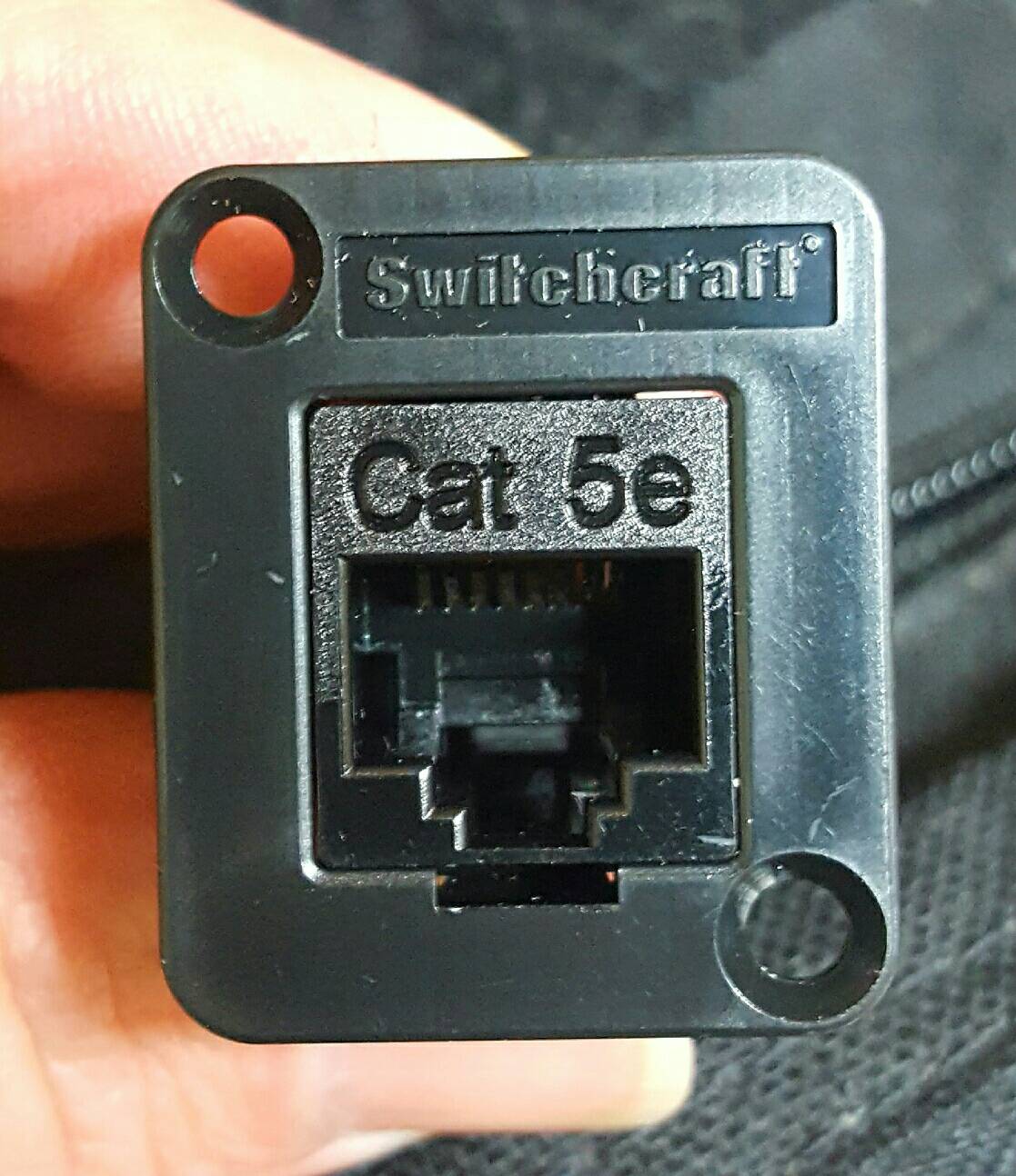

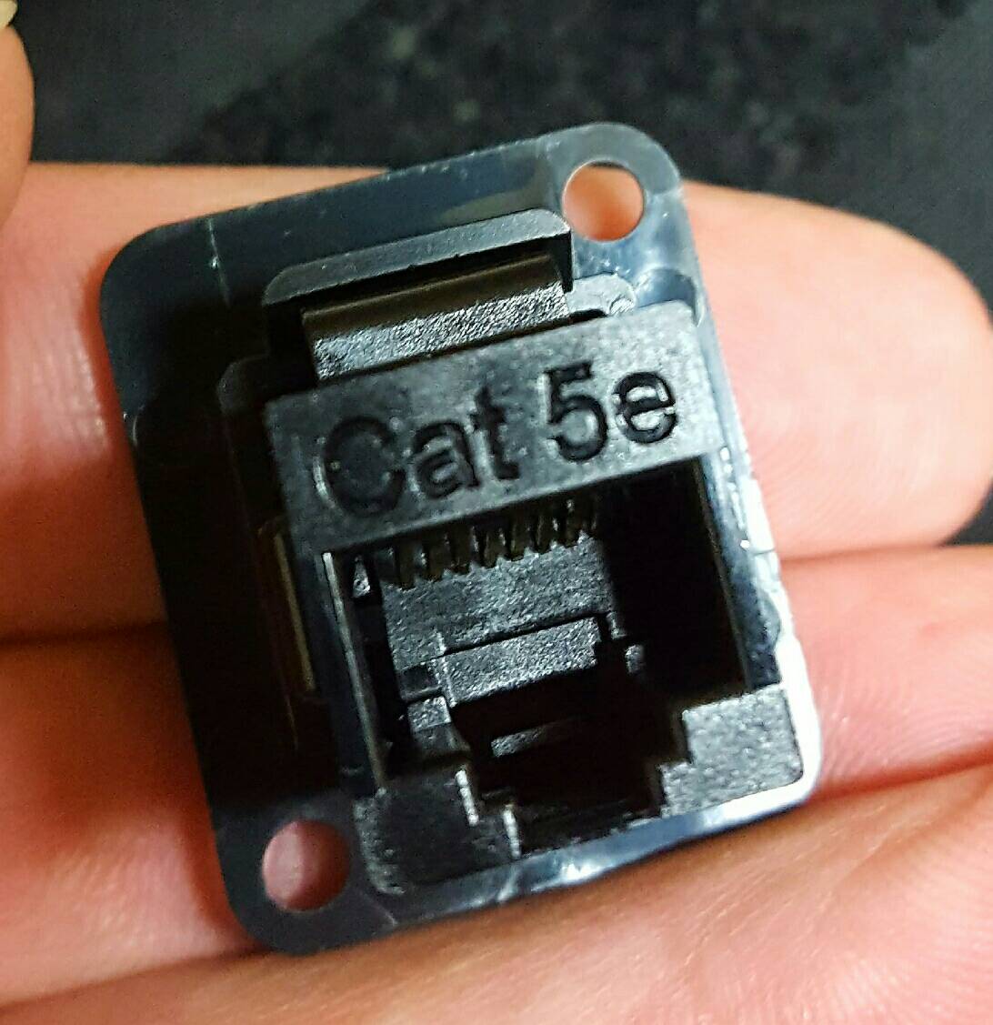

No matter where you decide to mount the the head unit, these are handy for a remote jack. Just need a patch cable from the unit to the jack. This one is for the mic, and RJ45 CAT5 connector surface mounted where you choose.
