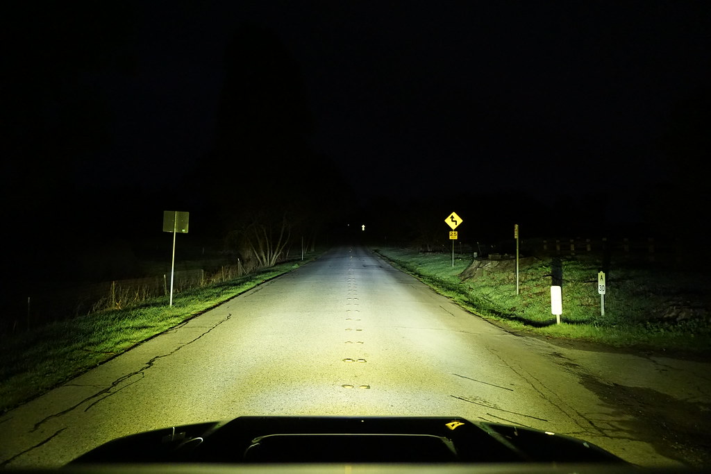

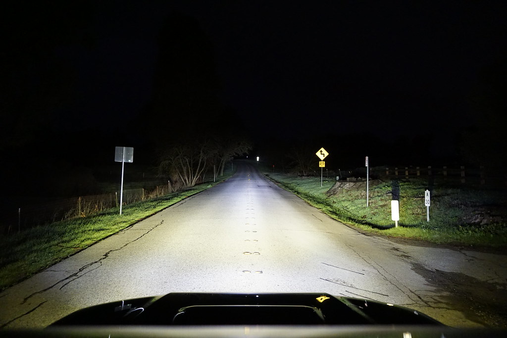

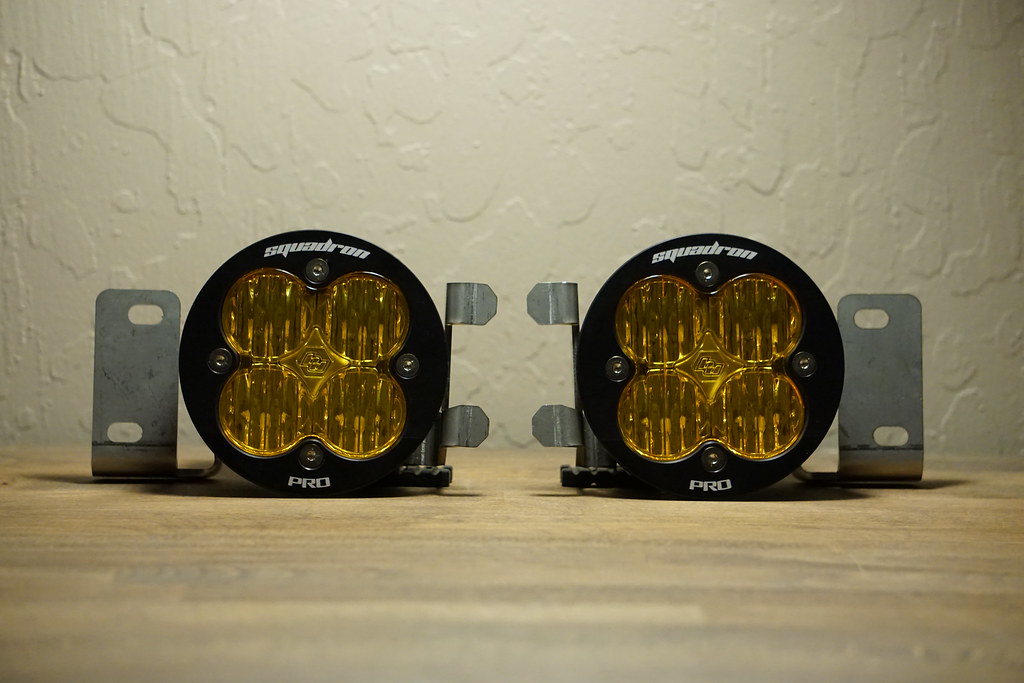

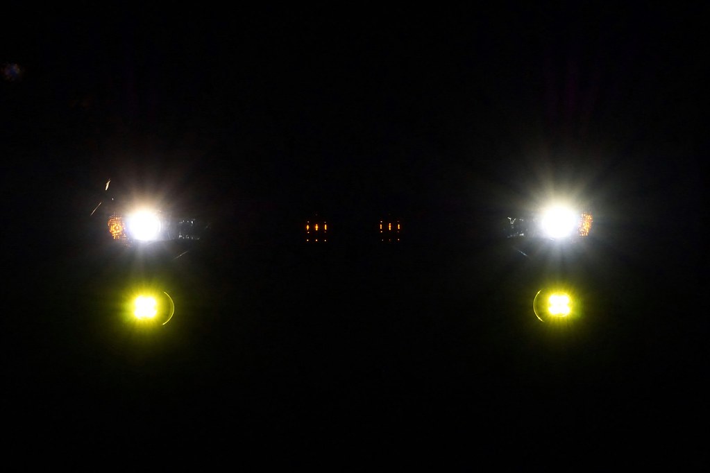

After a weekend of driving in the mountains in bad/wet/snowy weather I decided that it was time to upgrade my fog lights with something that would cut through the dust/snow/rain/whatever as well as provide a wider field of vision for dark two lane roads. I went to [MENTION=87816]Baja Designs[/MENTION] with my requirements and we came back with the Squadron Pros with the wide/cornering amber lens. They have their 4Runner fog kit that we added on to the order for a seamless installation. Plug and play.
The Install:
The install was simple as I followed the instructions. I used a jack to lift the front end so the suspension was fully extended. I also turned the wheels to driver's lock to give me the most room to work. The driver's side was really straight forward. Two screws out, OEM fog out, Squadron with bracket in, screws in, wires, DONE. That easy. The Passenger side was a bit trickier. I removed the lower five screws holding the inner fender plastics in and pulled it back just enough to be able to get my hands in there. There is a plastic shroud around the stock fog that needed to be removed. There were 2 push clips, one on each side. With some patience I removed the shroud and set it aside. The Baja Designs mount doesn't allow for the clip to go back in, so the shroud becomes useless. After removing the shroud, its the same process as the other side; two screws out, OEM fog out, Squadron with bracket in, screws in, wires, DONE. I screwed the fender liner back in and the install was done.

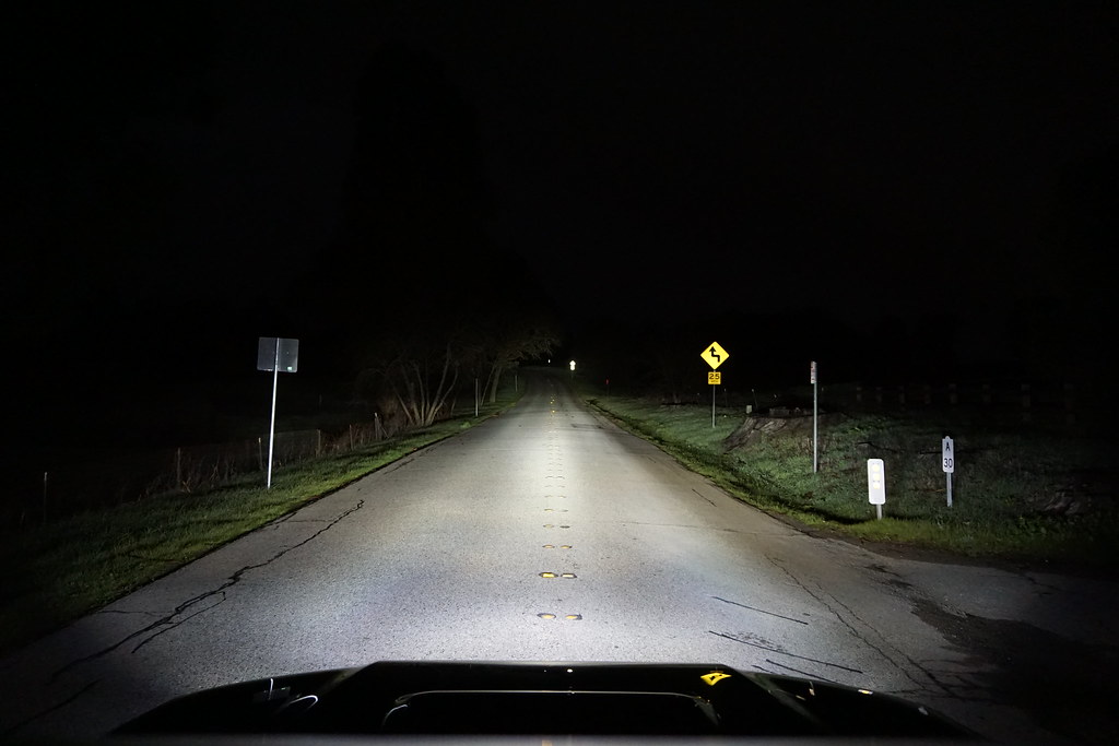

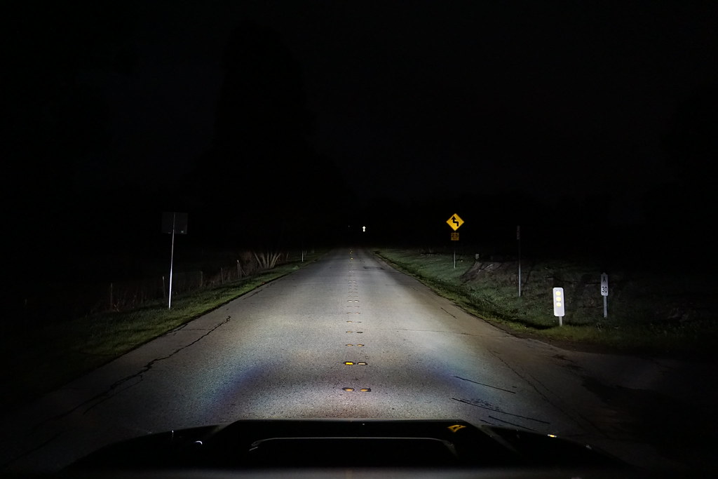

The Results:
I will let the photos speak for themselves. I will report back when I have had more time to use them in various conditions. But both the Squadrons and the previously installed S8 fill in and add to the beam pattern of the HID's I have installed. Overall the lighting field in front of the 4R is very complete with the exceptions of the far sides which may be fixed with ditch lights later on.
Low Beam HID's
Low Beam HID's + Squadron Pros
Low Beam HID's + 20" S8
Low Beam HID's + Squadron Pros + 20" S8
The Install:
The Results:
I love how the amber and white mix and the lumens become useful. I find the pure white of lightbars can add lumens but washes out the view. I approve of this message.:boink:​
Yep! I am excited to try the combo. That's why they offer some of their light bars with both the amber and white lenses. The close range output is a really nice mix. Now I just need to find some bad weather :thumb3:
Based on your experiences so far with the beam pattern, are these back road only options or could they be used in general traffic without blinding those oncoming?
EDIT: Just read your reply on the Baja Designs general thread. Good notes. Thanks!
Based on the photos above, I think it's safe to say they will be exceptionally blinding for oncoming traffic.
They are absolutely NOT road legal. That said during a blizzard in Bend, OR I ran them just so people could see me. But for around the town they're too intense.
