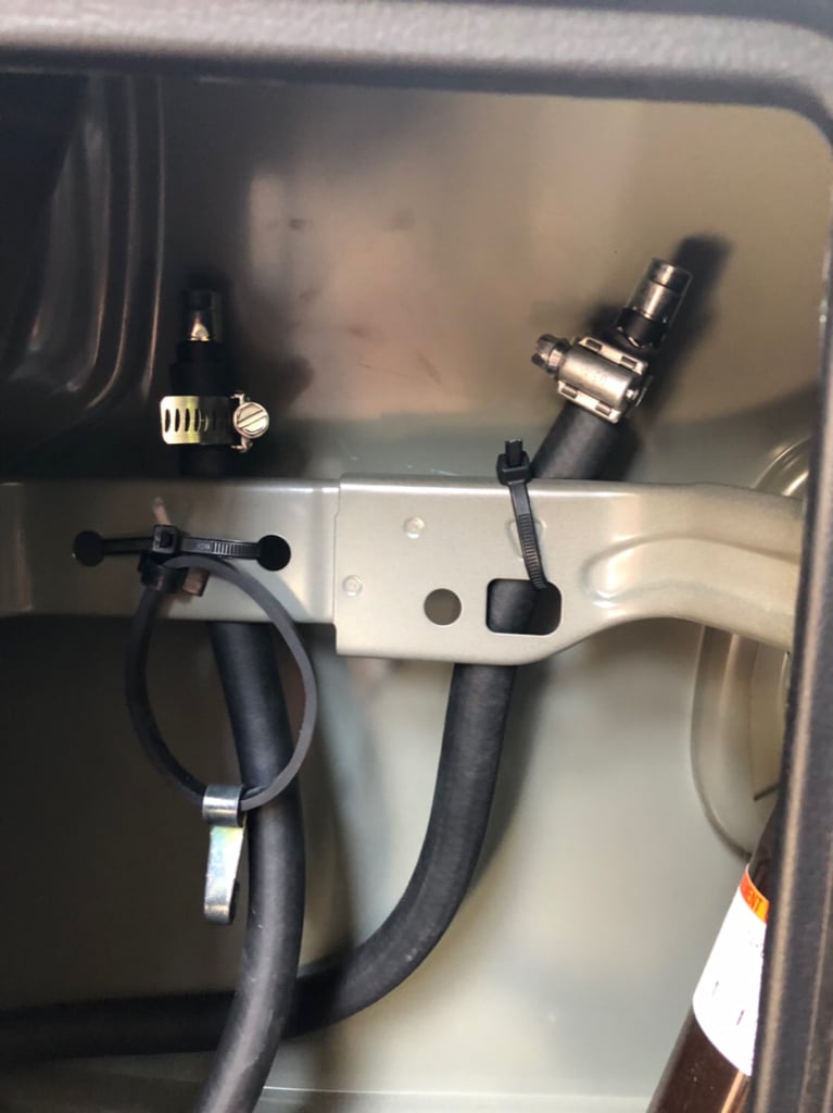

I just did this mod this morning over a cool, refreshing Sierra Nevada Summer Fest and I’m now ready for some water crossings! I also may have just opened a second one... oops!
My plan was to run it into the engine bay in case any diff fumes decided to filter their way up the hose, but in playing with the idea of your install I accidentally pushed the rubber grommet out while poking around in the tire jack storage.... so I just went with that, instead.
I popped the bumper off just enough to get access to the hole and slathered the tubes with electrical wire lube and it all went in fairly easy. I didn’t replace the grommet, but I will probably shoot a layer of mastic around the tubes from the inside to seal everything up.
The hardest part for me was getting the hose length correct for the locker. I cut the damn thing about 10 times before I finally felt comfortable with the end result (the attached pic shows how it was bending the locker tube). Before that, it was either too close to the heat shield or it was bending the existing hose over and possibly pinching it closed. No buneo! I finally got it just right, so I’m content.
Cheers to a fun, cheap mod!

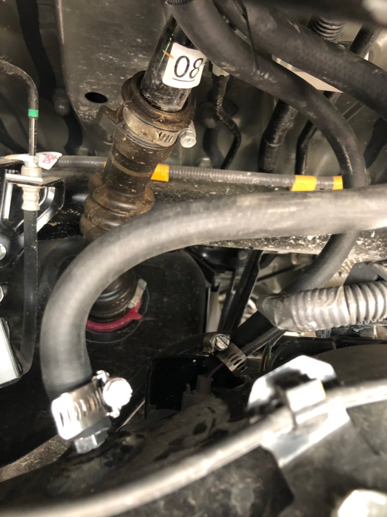

Excellent! You might notice some minor gear oil fumes in specific scenarios, but it's usually pretty quick to dissipate. And the measuring skills tend to diminish with the amount of beer consumed :thumb3:
