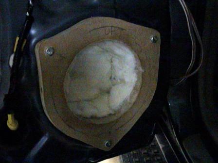

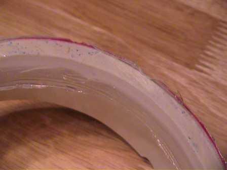

Pic1
Looking at the front door enclosure from the back. Two 3/4" wooden boards (since I ran out of scrape mdf) sandwiched (the PVC pipe is 2 1/4" long). The back cover is 1/16" plexiglass. The best way I found to cut the pvc was to mark it and run tape all around the exterior wall. then drill a 1/4" hole close to the taped edge. Cut the PVC with a jig saw as you rotate the pipe....simple. Sand the ends to give you a rough surface for bonding and to clean any imperfections. I found that it dosn't have to be a perfectly straight cut sinse you will be caulking the pieces together.

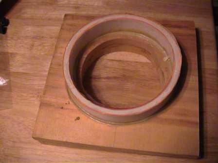

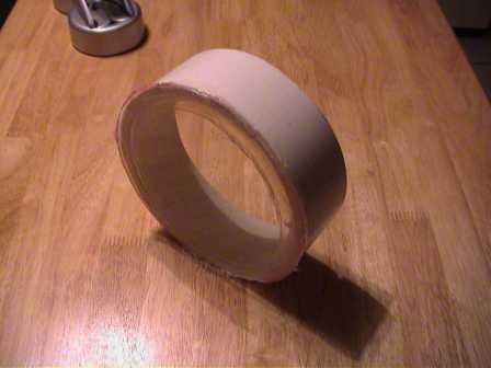

Pic2
Close up of the sealed plastic cover. I used regular builders silicon sealer. One tube will do all 4 enclosures.

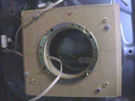

Pic3
Enclosure portion that is in the door. This is used in 2 ways. I will explain with pics as I go....

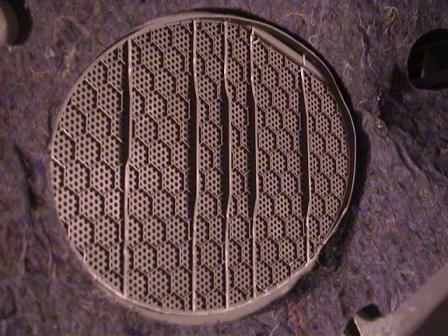

Pic4
Rear door close up of the PVC part of the enclosure installed. The tolerance was unreal!!!!! as noted by the overlap. Drill holes for small screws to screw the enclosure onto the door....I DRILLED HOLES IN MY BRAND NEW 4RUNNER!!!!!!! %^&**%^$!!!! :)

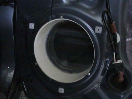

Pic6
Full shot of the rear enclosure. I had to install it through the hand hole covered by plastic (you can see it on the right of the pic). The rear enclosure can be screwed to the door. Silicon calk the seam between the door and the PVC pipe section to make it moisture proof. The mdf is then screwed into place using the 3 original speaker attachment holes.
Pic7
This is the rear enclosure with the mdf and polyfill installed in the enclosure. I used a spray glue to keep the polyfill in place. FYI this is the actual factory speaker bracket shape which is built onto the factory speaker. So no matter what your thinking...you will have to custom fit the speakers....

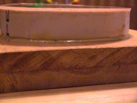

Pic8
Side view of front enclosure with additional gluing to the wood.

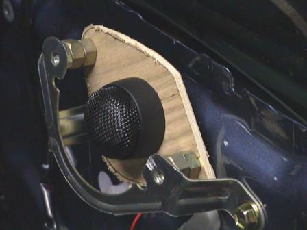

Pic9
The tweeter had to be reassessed because of the actual depth of the Infinity tweeter
