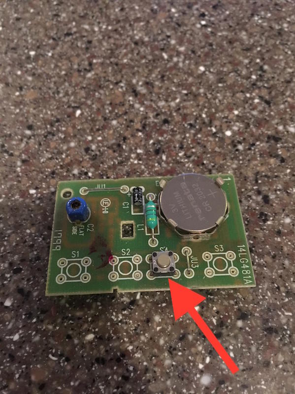

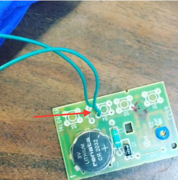

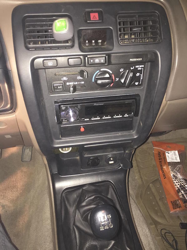

Wanted to share this little project I did. Just bought my 2000 runner and wanted to have my garage door opener built in. I rewired the button with a $4 switch from Radio Shack. Placed the button in the false plate just below the aftermarket radio. Easy to do with some simple soldering if anyone is interested in this. Been seeing alot of homelink posts and thought I would share. Here is a video of it working: https://www.youtube.com/watch?v=yD8l0IgzrXI

That's pretty neat. I wouldn't doing something similar to this myself. I think I would want it someone a little more hidden or subtle though.

I thought about hiding it and also using the black button but I keep it garaged and not to worried about security of it. Plus I like looking at buttons and switches. James Bond style.
