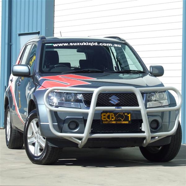

Are you talking about a "push bar", which is the inbred underbite looking thing, or a "brush guard" ("grill guard") which has bars that extend over the headlights?
If the underbite, well, beauty is in the eye of the beholder. Some people like them, some don't. Your rig, your choice.
If the grill guard, run a Google image search for "brush guard damage multiplier", or go here:
http://www.toyota-4runner.org/class...me-4runner-owner-need-advice.html#post1616780
Either of the above could help in light parking-lot bumps (parallel parking) and such, but if you hit anything big they really are damage multipliers. In a moderate hit (where the OEM bumper & crush cans would normally take all the impact), a push bar will fold back and destroy your radiator while the grill guard will fold back and destroy everything (lights, radiator, grill, hood, etc.).
Real structural bumpers cost more because they are more. A "lights and looks" contraption will be from $200-$300. You won't get a real bumper for less than 2-3 times that, with really nice ones at 8x or more. They are designed to take the forces from a snatch strap or a winch.
Most wenches I know aren't that strong unless really pissed off.
Why is that cosmetic hunk of aluminum being presented as a bull bar?
When I hear bull bar, I instantly revert to the ARB bullbar or the AEV front end on Jeeps.
