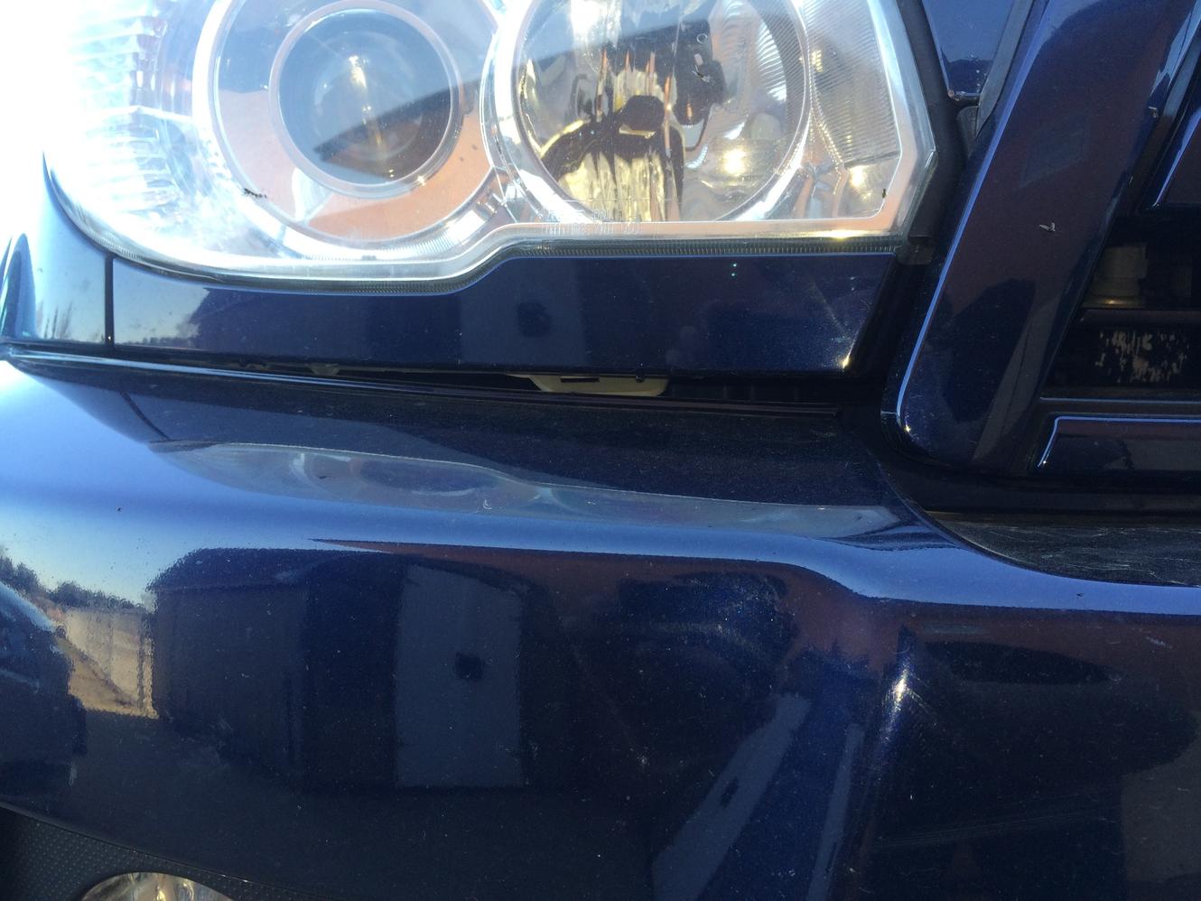

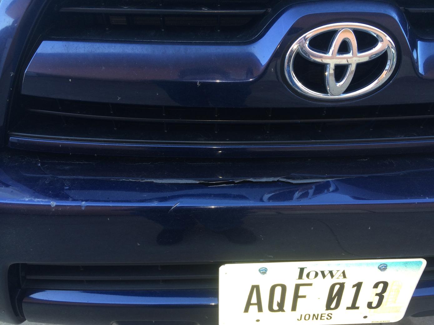

Had a minor crack up with a Honda CRV, (low speed, like foot off the brake) popped the bumper cover, and bent one of the bumper cover supports, (1/4 inch separation from the passenger head lamp) the damage is on the TOP of the bumper cover just in front of the grill, just >12-14" in length (from a distance you really can't tell).
Now that you know what I've got to deal with, I have 2 options for dealing with the problem:
Replace the bumper cover/support & Add a grill guard (WAAG center)
$600 ($100 for the BumpCover, $500 to paint and install) + $500@Andy'sAutosport (WAAG) + $100-150 ancillaries.
or
install ARB/CBI/Shrockworks/Other Bumper
~$1000+
not going rock crawling, biggest concerns are future vehicle contact/deer contact. Don't really want to reduce my MPG's much more than the V8 already has which is a concern with the Armor.

Is this being done via insurance or are you paying out of pocket? If out of pocket you might want to find another 4Runner owner who's done the armor swap and has their cover sitting around collecting dust and install it yourself. I know if I were in a situation where replacing my front bumper cover were necessary I'd go armor without the grill guard since deer strikes are pretty rare where I drive (sure wish there were more deer here) and I don't want the hit to highway MPG unless it buys me something useful. YMMV.

yeah I'll be footing the bill on this one. AFAIK there isn't a lot of 4 wheeling in this farm country, and even fewer rocks/trails. the getting of the Bumper cover isn't expensive $80ish. its the install that adds a chunk, my Shop said he'd paint it for 200, install is 300. I just don't know how much of a pain it is to get it on and installed.
So you're looking at 280 for the painted PART? That's not bad, quite frankly. If you aren't offroad often enough to need it, and want best MPG, just get the cover and get it painted, install is REALLY easy. You get the cover on the actual bumper, eyeball to line it up, push back, force the fender liner clips onto the little holes for em, and bolt it in. It'll take you probably 30 minutes being your first time removing/reinstalling.
Given that you don't need a heavy bumper for off roading I would probably just recommend fixing your existing bumper. Any bumper that attaches to the frame is going to have some gaps between the bumper and the body - there's no way of avoiding it.
Those of us who off-road just suck it up and live with it, but if I didn't derive some benefit from the bumper (increased front end protection when off-roading, increased approach angle and ability to fit bigger tires in front without rubbing the fender liners) I would have just kept my stock bumper.
