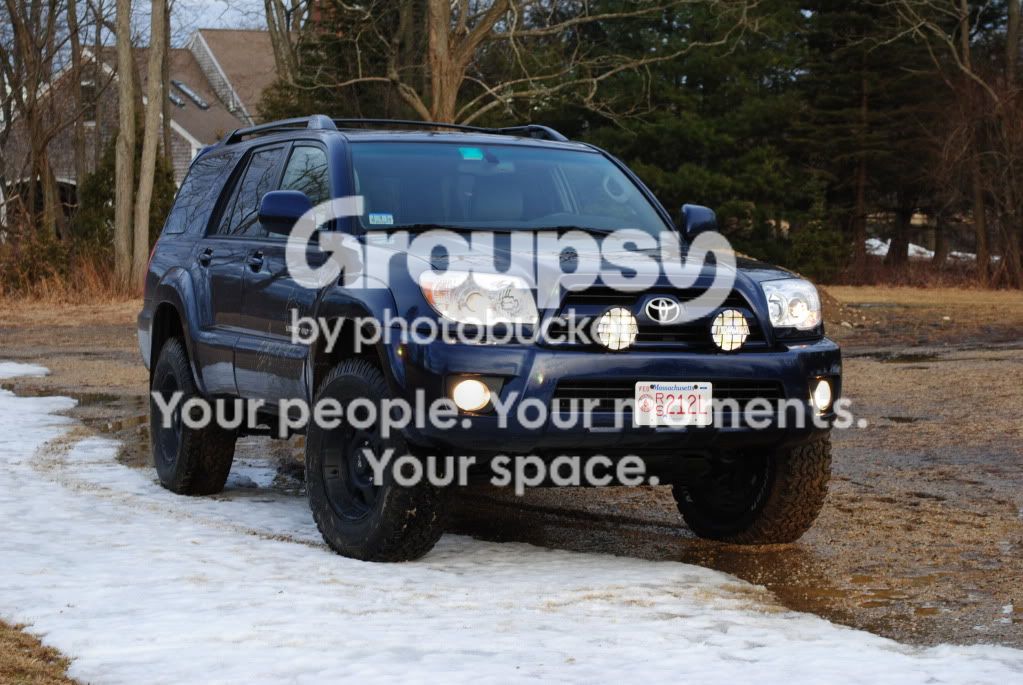

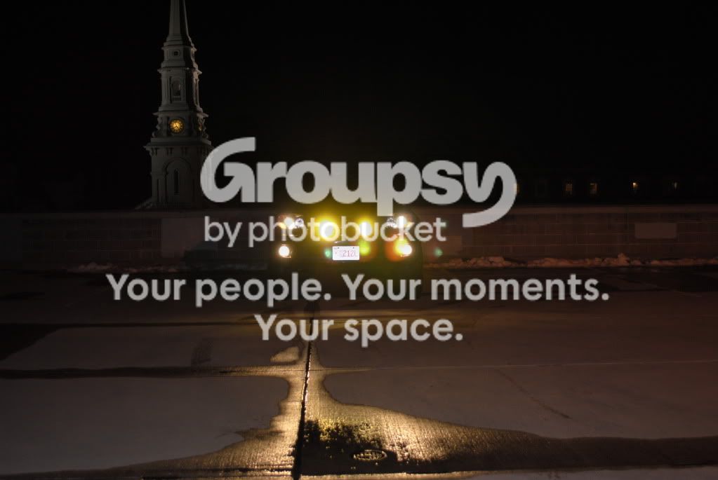

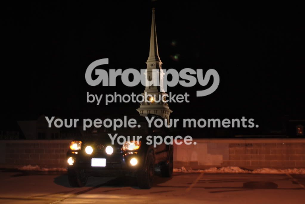

Here are some pictures of the PIAA 520's installed. I'll try and get some pictures of them on tonight.
DSC_0034.jpg~original
DSC_0033.jpg~original
i've always wanted to do this, but how did you secure the lights? metal bar inside of the bumper?
Ya, I went to Home Depot and bought a 6"x6" metal L bracket. There is a metal support beam under the bumper, but the lights need to go forward to avoid the hood and the bar isn't directly under where the lights need to be mounted. So I cut the L bracket so it fit between the support beam and the bumper and drilled the lights into the bracket and drilled the bracket into the beam, making the lights very sturdy. Once you take a look and feel around under the bumper you'll know what I mean.

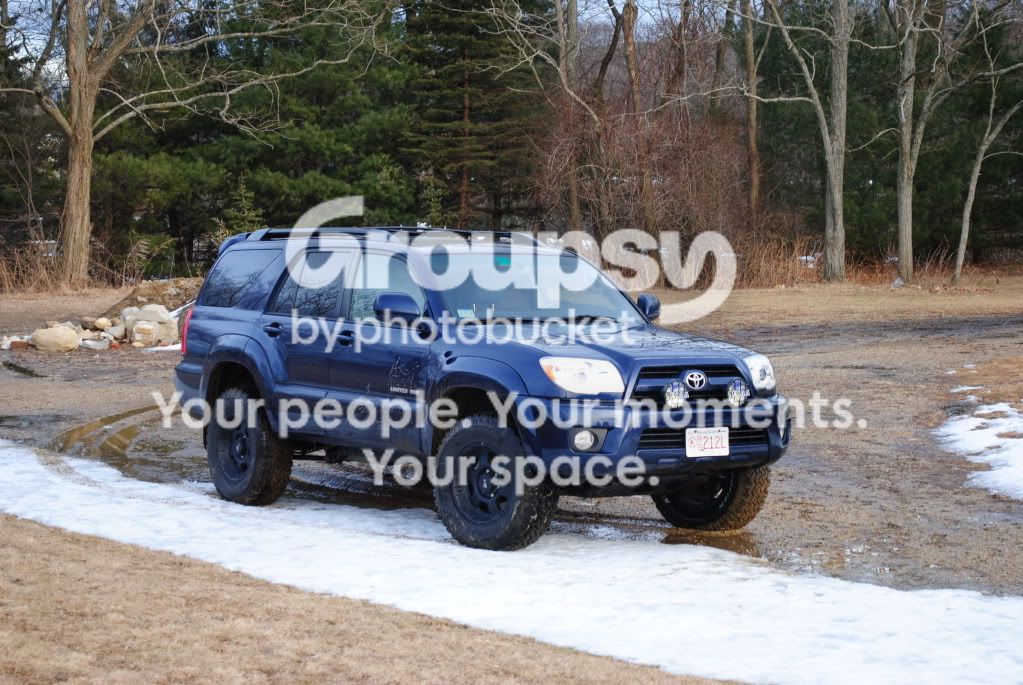

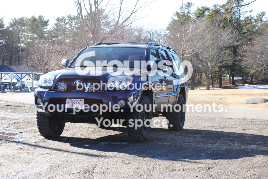

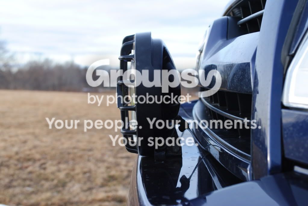

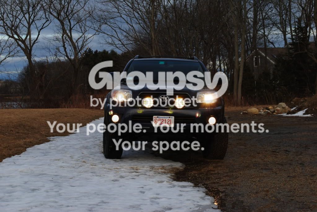

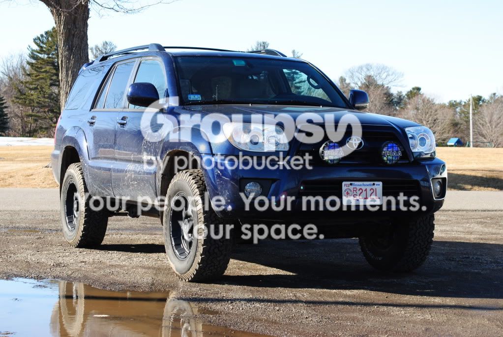

Here are some more pictures.
