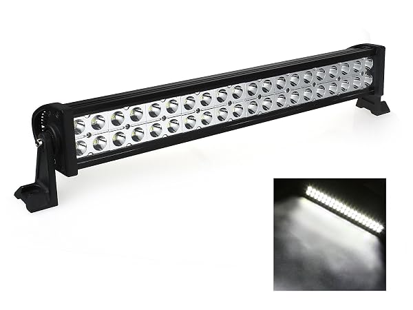

TaoTronics® 10-30V 21.5'' 120W Whole New Upgraded Led off road SUV Jeep off road Truck ATV High Power Light Bar Work Lamp 8000 Lm White FLOOD
Lights IP65 Waterproof
I purchased this one from Amazon and I'm waiting for it to come in.
That said, it was $157 with free shipping. Out of the 14 reviews it has, all are 5 stars except one, and it's 4 stars with the complaint only being that it did not state where the light was shipping from.
When I get it all plugged in, I'll take some before and after pictures and post them up.
