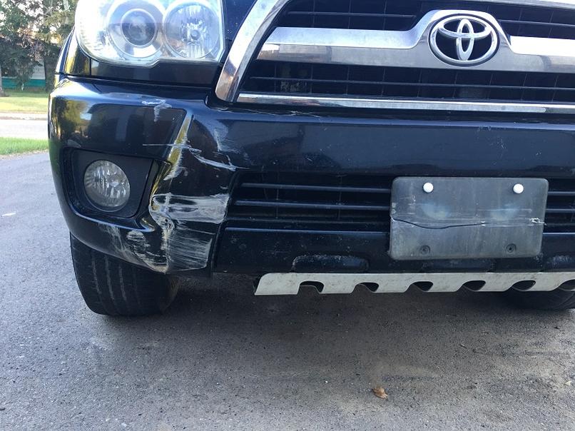

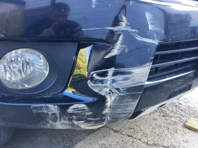

So the 4Runner got hit at the parking lot today. At the least, the bumper cover has to be replaced. This got me thinking.
First thing to mention is this 4Runner has no lift and no plans for one at this time. I recently installed Bilstein 4600 shocks on it. Everything else is stock, including the springs (or coils, if you like). It is a daily driver for my wife, yet I get to have fun with it and comes a hunting season, this becomes my vehicle.
I was planning to install a "hidden" winch on it before the next hunting season (more or less September). Now that the bumper (cover) has to be replaced and the person that caused the accident is going to eat up the cost (for the original bumper replacement) and will pay cash, it got me thinking about other options. Thinking of an aluminum bumper that can be installed with no lift on the vehicle and that can be handled by the 4600 Bilsteins.
Any thoughts on that?
Another question. From what I understood, the vehicle was hit from the passenger's side and actually slid some distance sideways (well, the front of the vehicle did anyway). So it was a pretty hard hit it seems. Looking at the damage though, it seems like the hit was not all that bad at all and most likely the bumper cover is the only thing that needs to be replaced. The weird thing is that my wife said that she could not start the vehicle after the hit. After a few tries it started and she drove home. I drove it twice today since (once on a highway) and it seems totally fine. Any ideas about the no starting after the hit part?

Also, I doubt any of it will buff out, really. It definitely needs a new cover, at least.
I know it might be crazy, but has anyone else installed any other bumper on a vehicle that is not lifted?
This is a long shot but I have more time than money and the process worked for a plastic bumper that got dented in on a vehicle of mine. Heat up the affected area with a heat gun evenly and slowly then have someone push affected area outward from behind. Depending on how much room you have to work with , the head of a rubber mallet is a good one because it's pliable and smooth. If not, then pick something that's smooth or simply use your fist. Then, you can buff it out. It won't be perfect but an hour of your time might be worth it. Youtube has lots of vids on this.
