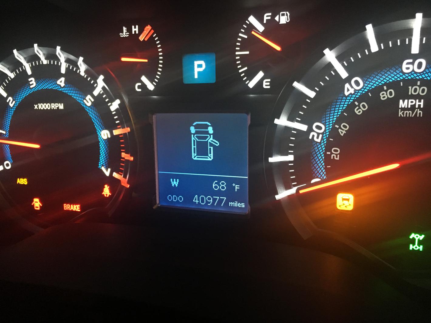

So I took off my icon stage 1 coilovers to get them re-built/re-charged. All is good there. Fixed. Got them back on. As I turn truck on I notice I'm getting a constant ABS light. Constant traction control light and a blinking green 4wheel drive icon. I've driven truck and it drives fine but not sure why all these lights are on and I can't get them off. Did I blow a fuse while swapping the suspension? But the weird part is I hooked up a code reader to my truck and it says there are no faulty codes. Says it's good. Maybe I have a faulty code reader but used it recently and it worked well. What's your take???

Same thing happened to me. I did a search and found out it has also happened to a million other people, all with 100% identical results. Broken ABS wire every. single. time.
Thanks for the quick help. Any one have a good link to where I can get some replacement ABS wires so i can get it fixed this weekend? Or if someone has a video link handy on the replacement. Gonna try and complete the thread for the next guy looking.

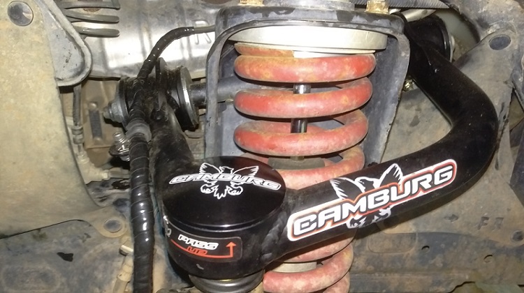

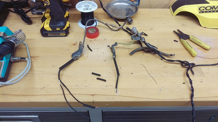

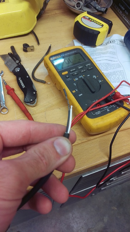

Definitely an ABS Sensor wire. Broke mine earlier this year while installing Camburgs. With a hard departure deadline to Colorado two days out, I didn't have time to source them online. The local dealer wanted $180 for the sensor harness. I actually asked the guy on the phone if he was fu**ing with me.
So I cut out the broken section and soldered in some fresh wire, heat shrinked everything, then covered in scotch coat/vulcanized tape. Working like a champ, and I've seen some pretty severe conditions with the truck since.
