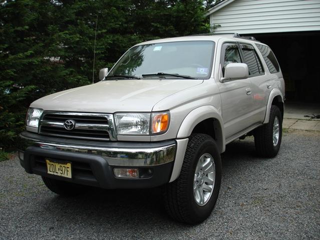

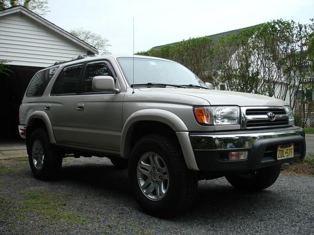

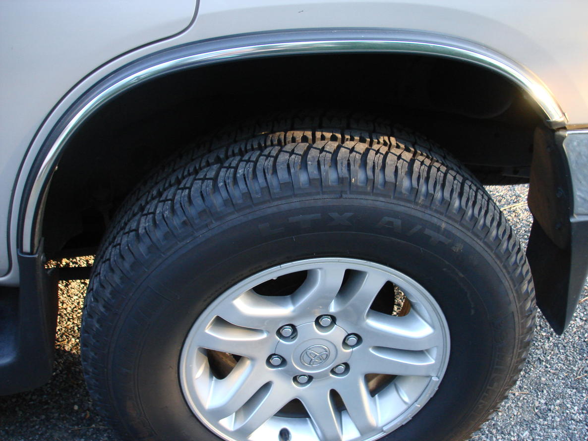

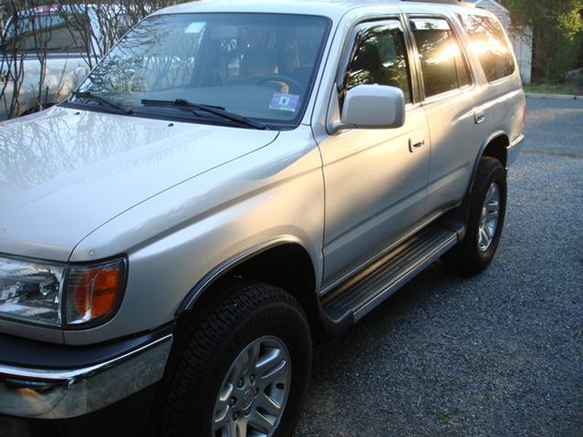

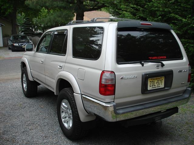

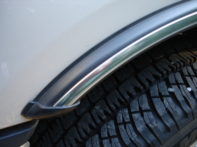

It took me two weekends to start and finish installation of the Bushwacker fender Flares. It wasn't too easy as other members reported but I wanted to do it well.
Be my judges.
Running boards have been removed as well but I am not sure if I like how my truck looks without them. I think the T4R Sport step bars would be a good addition to this setup. Anyone have them for sale, please?
Before and after:

those flares look great on your truck i really like them! also i love the tundra rims, always a good addition, its coming along good, also keep the running boards off looks better without and when it comes down to it, who really uses the running boards anyways
those turned out great-nicely done on the painting them ahead of install.
I'm sure you must know what you could have done better-but nothing is showing up on the pics. Better to take it slow and do it right. Looks like you did just that.
Well done!
By the way you should be able to recover some of your cost by selling off your old chrome trim. Might be guys on here or Yota Tech looking for just those pieces.
And if you find a good front mudflap for us Bushwacker guys to be using I would love to hear about it.
The flares look good, like factory. Good job :thumb3:
I'm like you though, I keep toying with the idea of running boards, or bars or something, but I always talk myself out of the idea. Primarily because I know that I probably won't use them 90% of the time, and in inclement weather they really can play havoc on a pair of dress pants.
Looks great man! I really like how that looks!

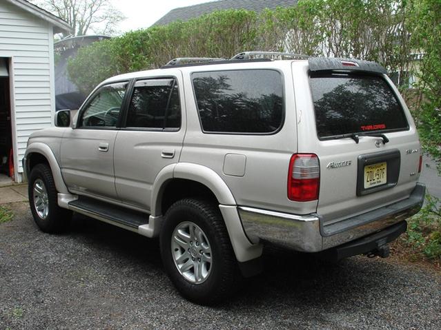

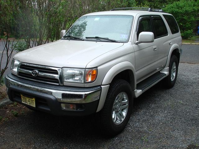

Today I put the running boards back. I have also installed end caps ( thanks jtanner!). Honestly speaking I like this look better. Without boards the truck looked too boyish for a 55 years old 4Runner enthusiast who will probably never take it off road. Well, who knows...:)

Flares look awesome. Running boards are 6 to one for me. I think it looks good with the setup you have going on right now, but if you ever got beefier tires that filled out the wheel wells a bit more, I think they would look better off.
