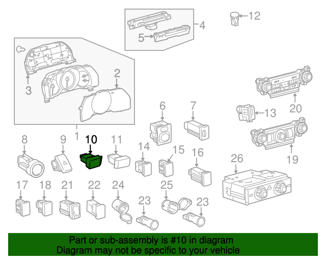

Is it physically broken, or does it just not work?
Looks like part number 83253-35110 if you're lucky or 83290-35110 (which also includes 83253-35110). If it is in fact either of those options, you're looking at a max of about $70 for the part. That being said, you'll save a ton of money if you do it yourself, and there are a number of good tutorials here on how to remove the radio.
Parts 4 and 5 here?:
How does a dealer come back with being unable to find a replacement on a vehicle a little over 2 years old on a product they both sell and service? This doesn't make sense. I'm curious as to why they would say that.
