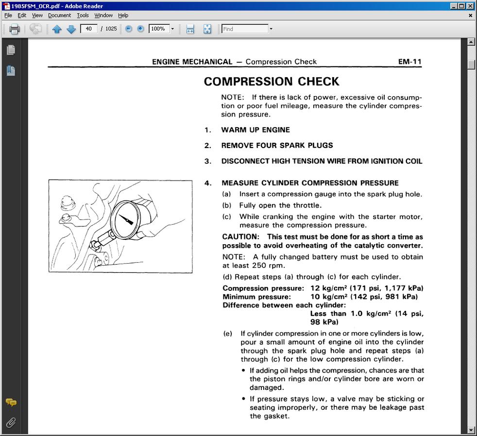

Did a compression test on one vehicle.
Cylinder 1,2,3 180psi
cylinder 4 150psi
Plugs were fouled pretty badly and had white build up on them on cylinders 1,2,3. cylinder 4 plug looked more or less normal.
So i'm thinking carbon buildup on cylinders 1,2,3. and less build up/leak of some sort on number 4? Seems to pass smog though so i was kind of surprised.
What do you guys think?
thanks,
Spetz
180? I think there was 170-ish from the factory, that's pretty good :). The 150 is too far out of variance, which indicates a problem on that cylinder. It could be a gasket starting to go, it could be a bad valve, or it could be a bad ring. Did you drop a half-glug of oil in there, and did that number come up?
compression.
No forgot to do the oil but I think I read compression should be 140 or 150psi in some manual I found I'll double check...
Here ya go.
