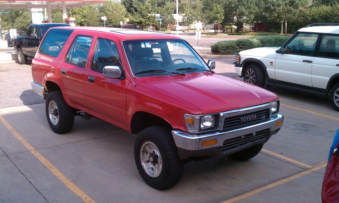

Newest addition!
Thank you all for your help, I have here my new 1991 SR5 4Runner! 195K miles and mechanically everything is working great, picked it up for $2300.
