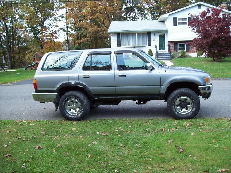

I'm new to this forum. I've had a FJ Cruiser for the last 3.5 years but just recently had to get rid of it cuz of this crappy economy. (I work at a Toyota dealership for the last 7.5 years selling cars)
I just purchased a '93 4Runner 22RE 5 speed w/ 162k and got lucky on Craig's List & it was a few blocks from where I grew up. It took about three weeks of looking for one everywhere, local papers, online, eBay, Craiglist, Auto Locator (NE US thing, PA,DE, MD, WV, VA, NY, & NJ).

But, it's going to be nice not making that payment every month & it will allow me to pay some crap off and save some $$. I can build this '93 up to make it a lot of fun for not a whole lot of money it seems like. Plus, I really like the Army Green in the '10 FJ's but need to see it in person to be sure. That will be a goal to save $ towards so I don't have to finance the whole amount like I did with the '07. So until then, this 4Runner's my new toy!

Umm imo, no car payment says it all! Woot on that one. That's how I live. I think the 2nd Gen are classy. Just have to work around the few issues mentioned above. You can find good bumpers and tailgates if you keep an eye out for them. Be patient. Also, strike up a good relationship with a junkyard nearby. Tell em to let you know when they pick up some wrecks that fit the bill. If you sell cars it should be easy to find someone maybe back in the shop who can do an intro for you. Good luck and enjoy the project.
As a previous owner of two LCs (FJ60 4 liter turbo deisel & a V-8 FJ 80) I'd say you made a wise choice...and will save money as well. The new LCs look horrid in my opinion... they really strayed away from the LC tradition and made this alien looking space bubble of a truck.
