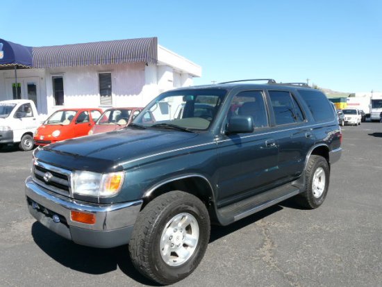

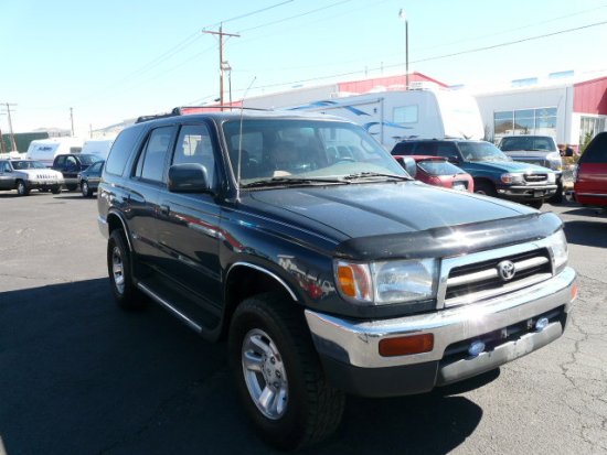

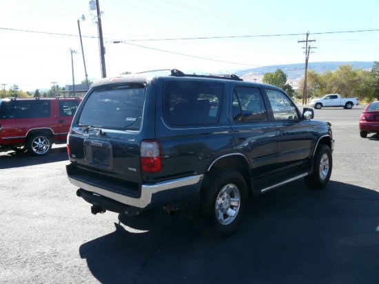

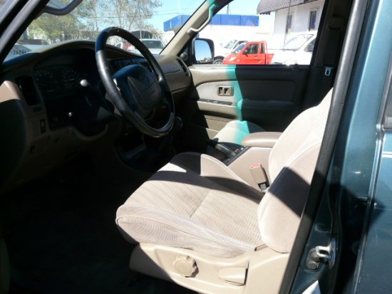

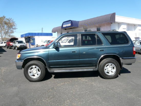

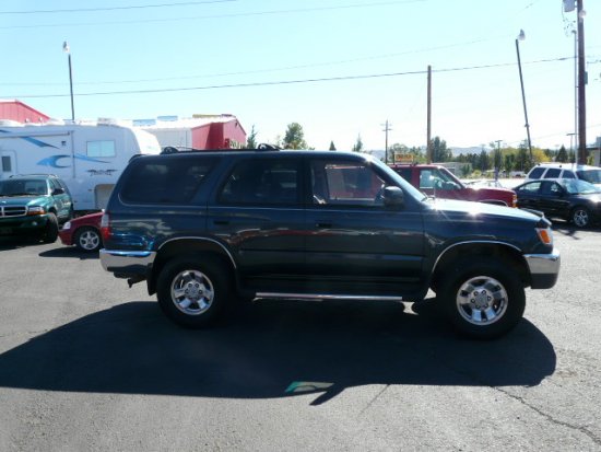

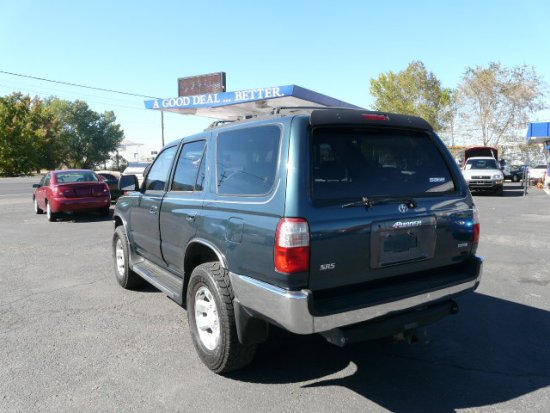

New to the forum here, and looking for some advice. I've been looking into buying a 3rd gen t4r and after a few months of searching I've found one that I think might be the one. I found a 5 speed, 4x4, 97, sr5, with 205k miles and they are asking $5999. I don't know about any service records, or how well it was maintained. So I'm wondering if this is a good price? and are these too many miles? Also I know that ideally I should take it to a mechanic to have it checked out, but I can't really afford that right now, so are there anythings that I should look out for? Thank you all for your input.

Is this at a used car lot off of south virginia st by the Les schwab? Looks like it from the photos. I've got a very similar 4runner; 1998 now with 205k on it, I paid $4000 for it back in May so $6k sounds high to me.

That's too much for a 97. Drive 2hrs to Sacramento and you'll save $2k+.
You can get a 99-2000 for that kind of money.

Yeah, that's the one right next to les schwab.
Thanks all for the great input. I thought it was a little high myslef, but i thought a second opion wouldn't hurt. But, what would be a good price for this one? I'll keep looking, but if i can't find anything by tax time, I might make an offer on this.
I paid 4k for my 2000 sr5 with 203k miles in pristine condition. Im in MN too where anything 4wd goes for a premium...
I would say 4k ish would be a decent price if it is in good condition.
Thanks all. I went to go check it out last week, before we started it we talked and he dropped the price to 4950 out the door(taxes doc fees and smog check included). Then when we went to start it the battery was completely dead. He put a new battery in it and it started right up. The engine sounded great, but it did start to blow a bunch of white smoke from the tailpipe, and I saw it was leaking a bit of coolant, but couldn't figure out from where. Took it for a test drive and after about 10-15 mins of driving, the smoke stopped. Clutch felt nice, 4hi and 4lo worked great, all the windows rolled down. But I can't figure out the white smoke. I know for a fact that it had been sitting in the same spot for at least two months, so could this just be condensation that built up over the winter, or is it something more serious; head gasket, cracked heads, or cracked block. I'm supposed to go back tomorrow and check it out again but I don't want to commit if it like that. Again thanks for all the great advice.
White smoke out the tail pipe = leaking water into combustion chamber, ie blown head gasket..... I'd pass, you know the dealer is always making 3k minimum on anything they sell....
I wouldn't touch that with a 10 foot pole.
Dead battery, white smoke, someone else is telling you to turn away
I'd keep looking elsewhere also. In January 2009 I paid $3000 cash private owner for my 97 2wd, with 212,000 miles on it. She has needed lots of loving, and I have dumped a lot of cash into her. So much so, I could never sell her and make anything decent. Though, after putting 2500 into having the motor completely rebuilt, at 270,000 miles, due to a spit plug, she runs strong as can be. But it costs. End of next year, I'll take her off the frame and dump a ton of money into her.
I say all this, because you said you couldn't afford to take the truck to the garage to check it out. Buyer beware. Buyer prepare. I say keep looking.

My opinion:
* if it has white smoke then avoid it (see next sentence)
* you really should have a simple compression test done before buying it; my Dad taught me that
* heed this warning ----> at 200,000 miles a major engine failure eg. a cracked head is perfectly plausible so beware
* the 5 speed is not special and does not make it worth more than an automatic; the 96-02 Auto is a great trans, mine has 212+ miles on it
* if you find a really clean 4Runner with 200k, it might run fine until 250k - maybe. But it will not run forever.
* you are better off with either a 4WD Auto with 150k or less for your $5500. 150k miles is a lot less than 200k on these trucks.
Good luck.

Thanks to all the members that posted their 2 cents. I ended up taking to a shop of my wife's friend, and turns out that the suspension was all shot. Break lines were cracked, front brakes were wearing unevenly, needed new rotors, calipers and complete rack and pinion system, and tires, although they had about 75% tread, were dry rotting from the inside. After all the parts and labor, the shop quoted me between $2,200 and $3,000. I took this back to the dealer who was selling the Runner and he was unwilling to drop the price, he still wanted $4,750 for it. I was willing to give him $3,300 he still refused. I ended up just walking away. I figure I'll just keep looking and hope to find a gem out there like so many of you have. I think I just had really bad car fever.:doh: Again thanks for all the great input. This place is great.
