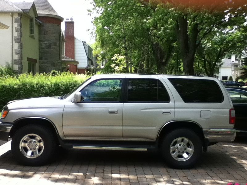

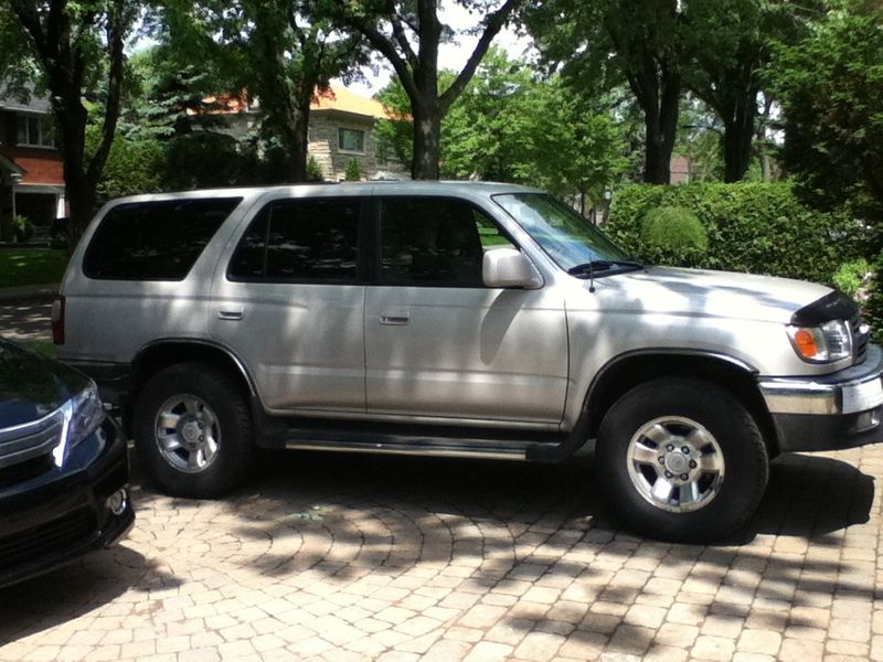

yes its 4wd, I will post pic of the car once I have it in my parking lot. I have a few of it here the white tape on the front bumper is to cover some rust due to parking lot incident ( ppl backing into the car and stuff)

Looks pretty clean. Does it feel like it was well taken care of? I think your gut can go a long way.

The antenna does not go all the way down on the one in the pic. The badges between the rear window and rear door window are missing. Whomever mounted the wheels did not do it correctly (hub vs lug centric).
I'd just look it over REALLY well. The back door and front door look like they're different colors to me. (may just be the picture).
Does it not had a roof rack or am I just missing it in the pictures? It appears to be a base model SR5 since it has the mini-flares. What kind of seats are in it? For the mileage and the money its probably a good deal. If it drives well and has no unusal noises or issues I would say go for it.
Looks like the rails or there - just no crossbars.

I'd be really careful on this one. Not trying to rain on your parade but even just from the pictures it doesn't look that clean to me. Panel fit looks off, the front and rear look like they're two different colors.
Do you have any kind of vehicle history report on it? (Carfax) I wouldn't rely solely on that but it might be a good start. Every panel should have a VIN sticker on it, check them to see if they match. If they're missing, tell tale sign it's an aftermarket part.
Again, not trying to spoil this for you at all, I hope I'm wrong but I've bought and sold too many cars to count. Ask member TomP. I helped him avoid a train wreck of a 4Runner just by looking closely at the pics of it he sent me that was 1,000 miles away from me.
i dont see where it doesnt seem to fit, i saw it in person and didnt notice any color difference next time i go see it ill look at the vin numbers and see if they match
