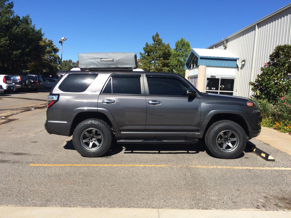

I bought my 2014 LE in Arlington, TX in March 2017 and it did not have the auto running boards. With my previous experience in Lincoln Navigators, I wanted to avoid them at all costs. I ended up selling the stock mounted running boards and bought the Iconic 3" tube running boards. My T4R was Toyota Certified Pre-Owned with less than 41K miles and significantly cheaper than buying one new.
In regards to the lift, I looked on this forum for months before I really was able to make a comfortable decision. My off-roading and trail riding is limited to hunting roads, lease roads, and occasionally some backroad red dirt muck here in Oklahoma. I figured without scrapping a perfectly working XREAS system, the Daystar spacer lift was plenty for my needs. The ground clearance of course is better, my tire options are significantly better, and it looks way better and more aggressive all around.
There are plenty of others mods available and a great opportunity to get creative. This forum is a huge resource and will help you a ton.
