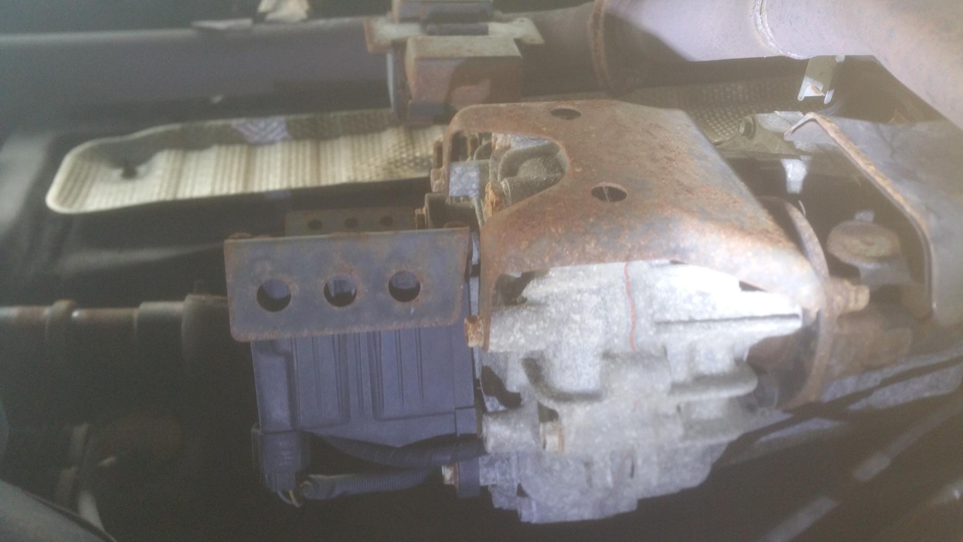

It drove fine as well, I did many take offs, reverse, engaged/disengaged 4H, 4Lo, tested all windows, sunroof. I crawled under on all four sides, no leaks underneath or around Tcase/pumpkin, no tears in cv boots.

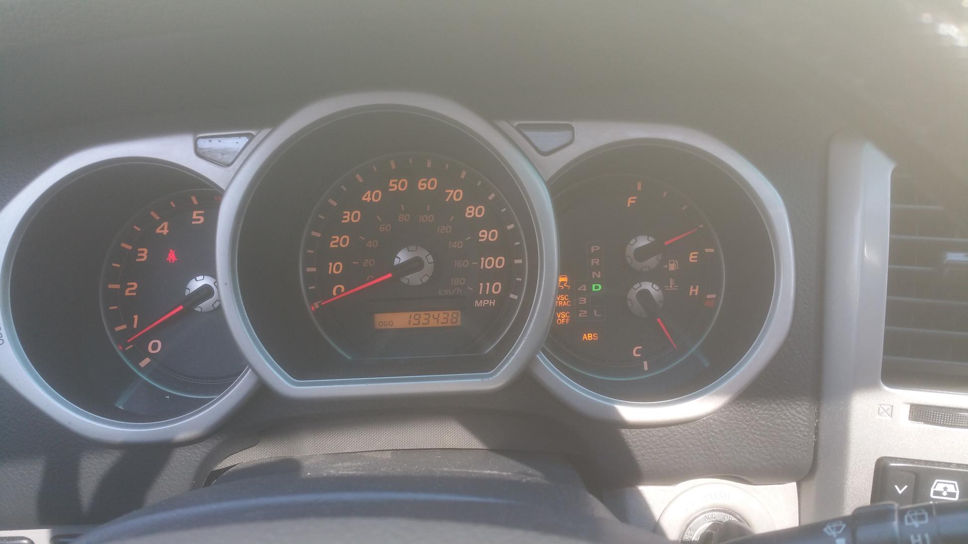

**VS, Trac/off and ABS lights are on the dash and mine and his obd gave communication error...if it is something that can be easily fixed at home then I can use it to negotiate the price down further?
He posted for 6500 and with the OBD he was already down to 6200, I think he will go lower if he cannot resolve it and get emissions done, it cannot be registered. So it is a bit risky if it is something big but as compared to the two others I looked at this is a much better deal

That isn't usually a big deal, just annoying. On mine I just had to push the wheel speed sensor wire back into the hub further (it got pulled a bit during either my brake job or suspension swap). What should be a bigger concern is the 2005 and earlier V6's are known to have head gasket issues.

Where those ABS VSC TRAC lights already on when you got there?
Not sure on the 2005, but on the 2004 it uses the ISO protocol not CAN or CANSF for the OBDII.
Because of that my scanner bugged up my Zero Point Calibration when doing the protocol negotiation. You get same/similar lights on the dash when you clear your zero point cal.
May or may not be your problem, buts something to look into and understand.

and then you also have the warnings lights which it's very possible that it's one of the ABS sensors/wires.

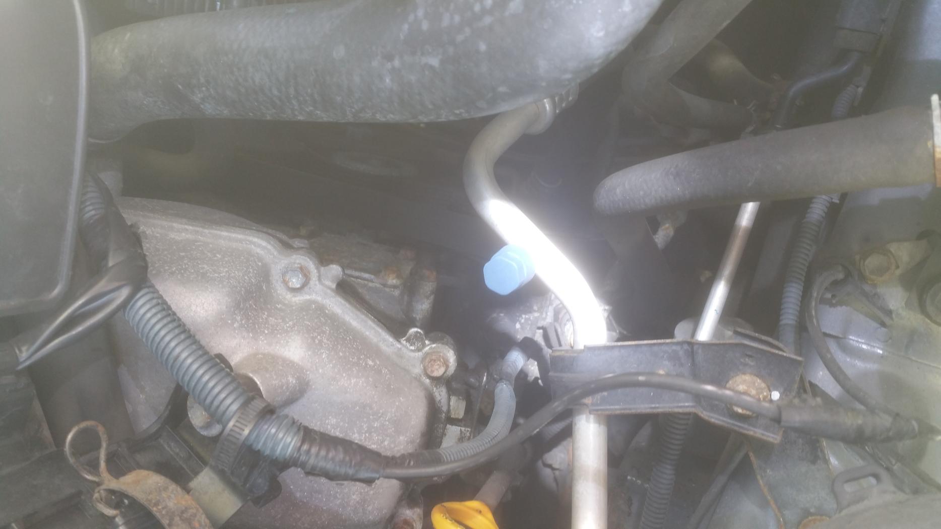

On the 04 V8, if you look somewhere under the hood they should of place a sticker showing that the timming belt has been replaced,
when I bought mine I couldn't confirm if the timming belt has been replaced via records,
but read somewhere about the sticker and looked and sure enough I found the sticker on the underside of the hood.
Also the water pump should be replaced while doing the timming belt, especially if it hasn't ever been done, the cost is minimal if done at the same time.

I need to look at odd places for TB sticker, I did one two years ago on my v6 3rd gen, is the v8 about same level of difficulty?(posted here on forums).
