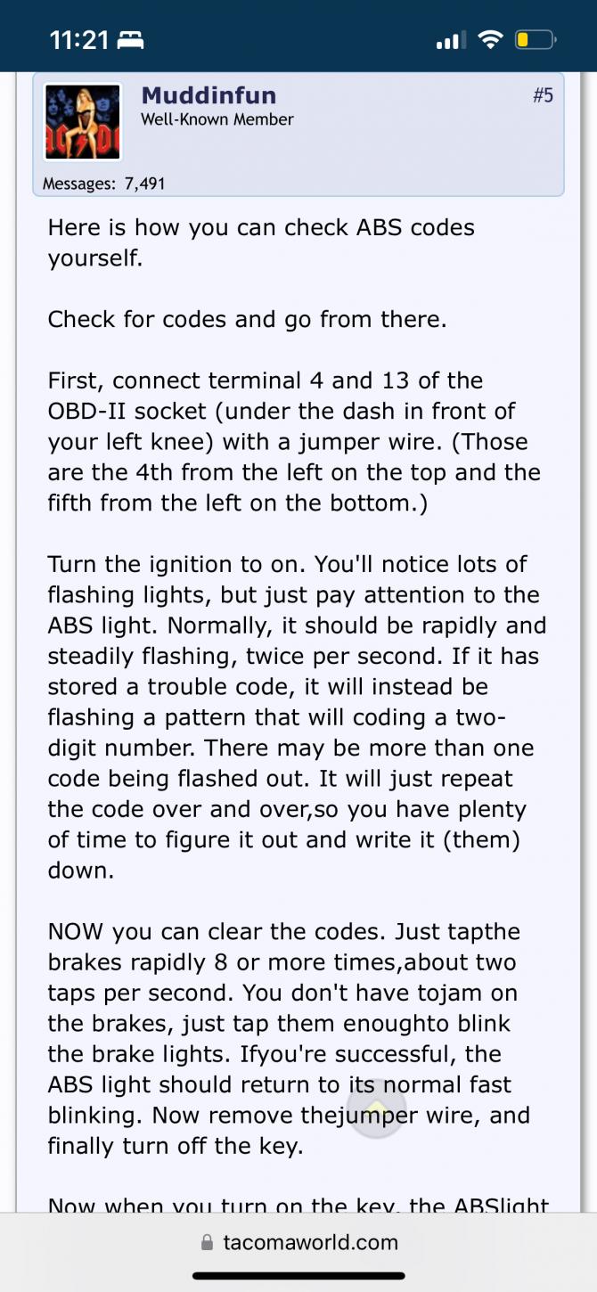

I remember there was a TSB or similar years ago that you can get ABS codes by jumping the OBD connector with paper clips. I even posted about it and got a code (RT Front Wheel Speed Sensor)
I cannot find that document, even though mulitple threads speak of it. So can someone lead me to it?
Or can someone give me an OBD scanner that will currently pull abs codes out of a 2004 Sport 4x4 V6, please?
My memory is pre 2006 models don't play well with some scanners, so the paperclip method is preferred. I have a bunch of DTCs from Techstream, but I am unsure if I did the code retrieval correctly.

I found a post on tacomaworld, see the attached pic.
I cleared the lights. They came back.
Not a gas cap. Haha
Not a brake switch. Hahahah
Not one of the 14 DTCs. Ha
It was:
ABS 31 (Right front wheel speed sensor fail)
Vsc 43 (ABS Malfunction)
Fortunately, while digging, I found an excellent video on YouTube of how to diagnose and fix that exact issue:
ABS Diagnosis Tips from a Toyota Mechanic. Fix It Right The First Time - YouTube
This screenshot shows how to pull ABS codes with two paper clips.
I’m posting this for myself and anyone in the future that needs to get these codes for a real diagnosis, and who doesn’t want to guess by changing gas caps and brake switches.
