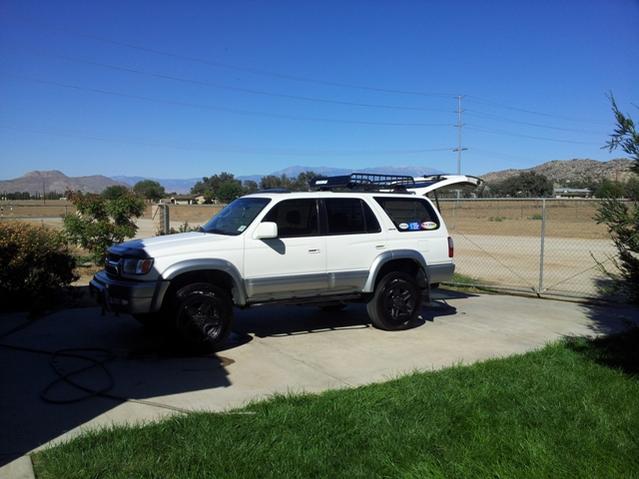

You might end up with something like this at the end of the day.
My 99 LTD 4Runner.
Blue
PS- She dose snow really well in the Ozarks.
