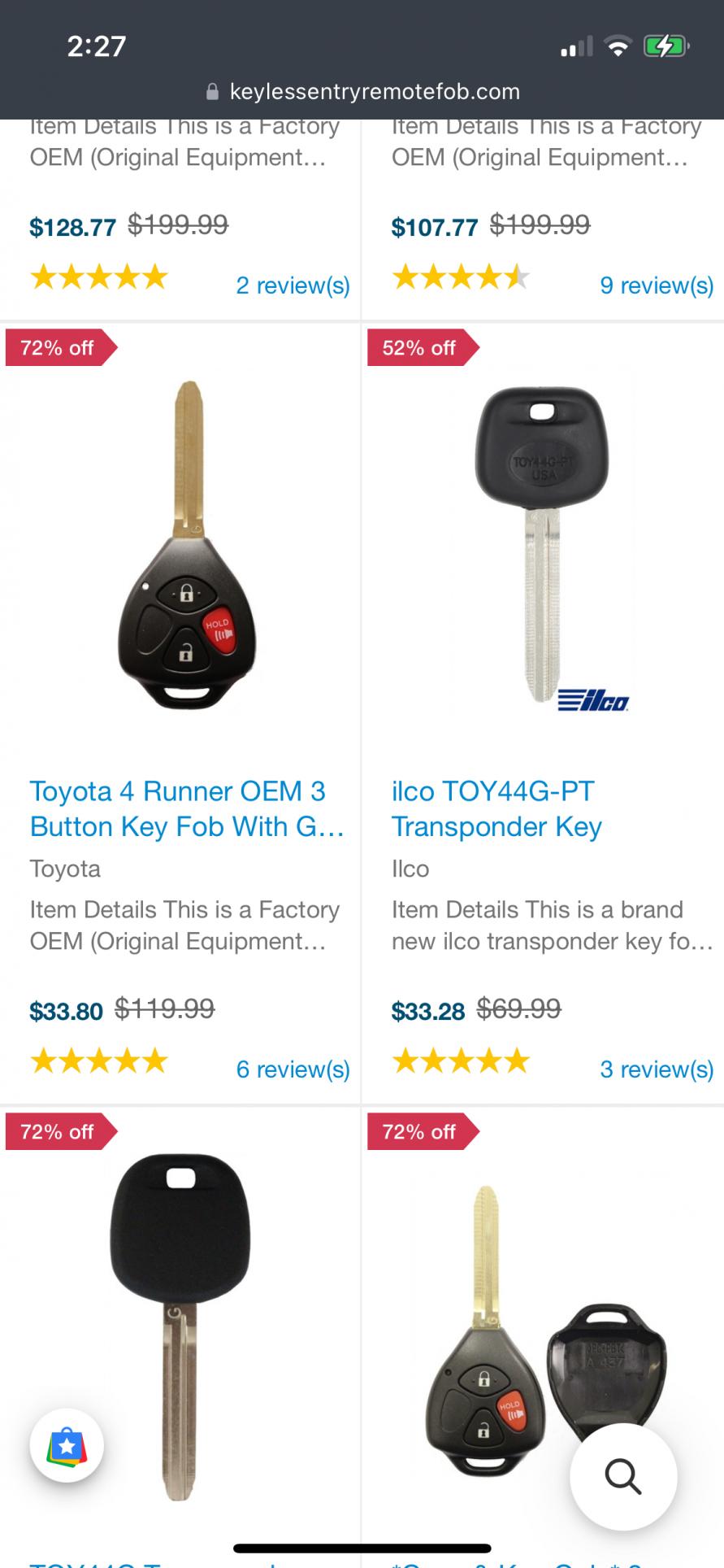

I do not have personal experience with this on line seller. But maybe can be of use to you.
