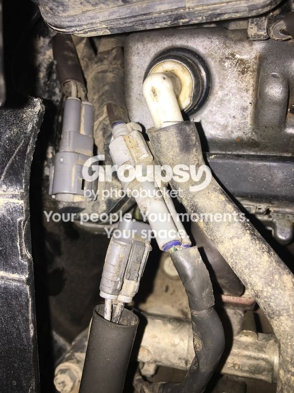

Welp, no issues sitting in my driveway, but 2 mins down the road and I threw a CEL. P0325 Knock Sensor 1 Circuit Bank 1, P0330 Knock Sensor 2 Circuit bank 2, and P0340 Camshaft Position Sensor "A" Circuit Bank 1 or single sensor.
Did I miss a plug somewhere? Any thoughts?

I did. I just got back from lunch. I unplugged and replugged it to make sure it' was in there good. Cleared the codes, ran down the road, both knock sensor codes popped back up, but the timing code didn't. I drove a few miles down the road and the cam sensor stayed cleared.
So it seems as though it's just the knock sensors. I'm going to take the manifold back off and visually inspect everything. I do remember now that when I took everything off before doing the valve cover gaskets, the plastic cover over the harness broke off in a couple places (it was really brittle). I'm going to inspect it too and make sure I don't see any cuts or pinches in the harness.

It's possible the wires to the knock sensors got distrubed while you were in there and broke since they can get brittle due to age and heat. Looks like you can get a new OEM harness for them if that is the case. [MENTION=116467]Rock_Rat[/MENTION] has a good thread on the subject.

I was thinking along the same lines, for both sensors to go bad simultaneously seems more like it'd be that harness. Turns out if you don't plug the harness back in, you'll throw two knock sensor codes.
Apparently when I was moving the harness around to get the valve covers out, the plugs tucked up under the lip of the timing cover and I didn't plug them in... Plugged it back in and everything went to working like normal!

Good thing that was an easy fix too. Now you should be set for awhile on maintenance. When I did my valve cover gaskets I missed one of the plugs on the back of the throttle body. Happens to everyone haha.
