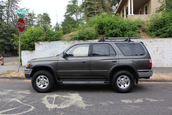

I recently bought a 1997, SR5, 5-speed, anthracite 4Runner. CoCo or Co^2
Front end pushes to the right on acceleration and from the looks of the bushings, I think they need replacing. Curious about the cost of having someone replace all of them and what brand to go with or could be available to being coached in the right direction.
Drivers side view mirror does not adjust side to side but works top to bottom. Seems like and easy fix and honestly doesn't bother me since it is adjusted to my liking and won't change.
The headlights are definitely not bright enough for my 30 year old eyes. Emailed [email protected] to see about upgrading.
Newer tires, BFG AT KOE2 LT265/70R16D1.
Clutch pressure plate, timing belt and water pump replaced at 163k.

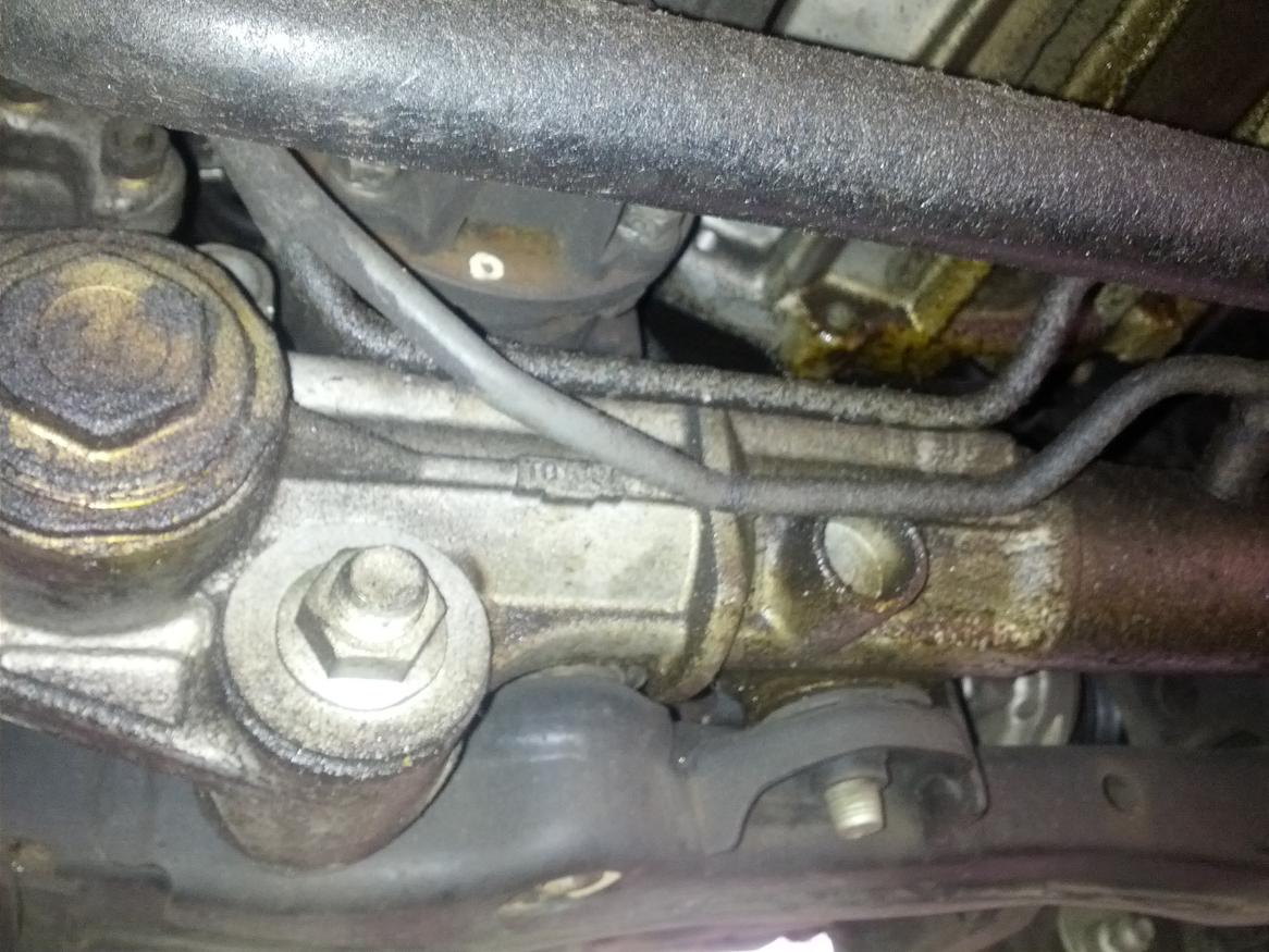

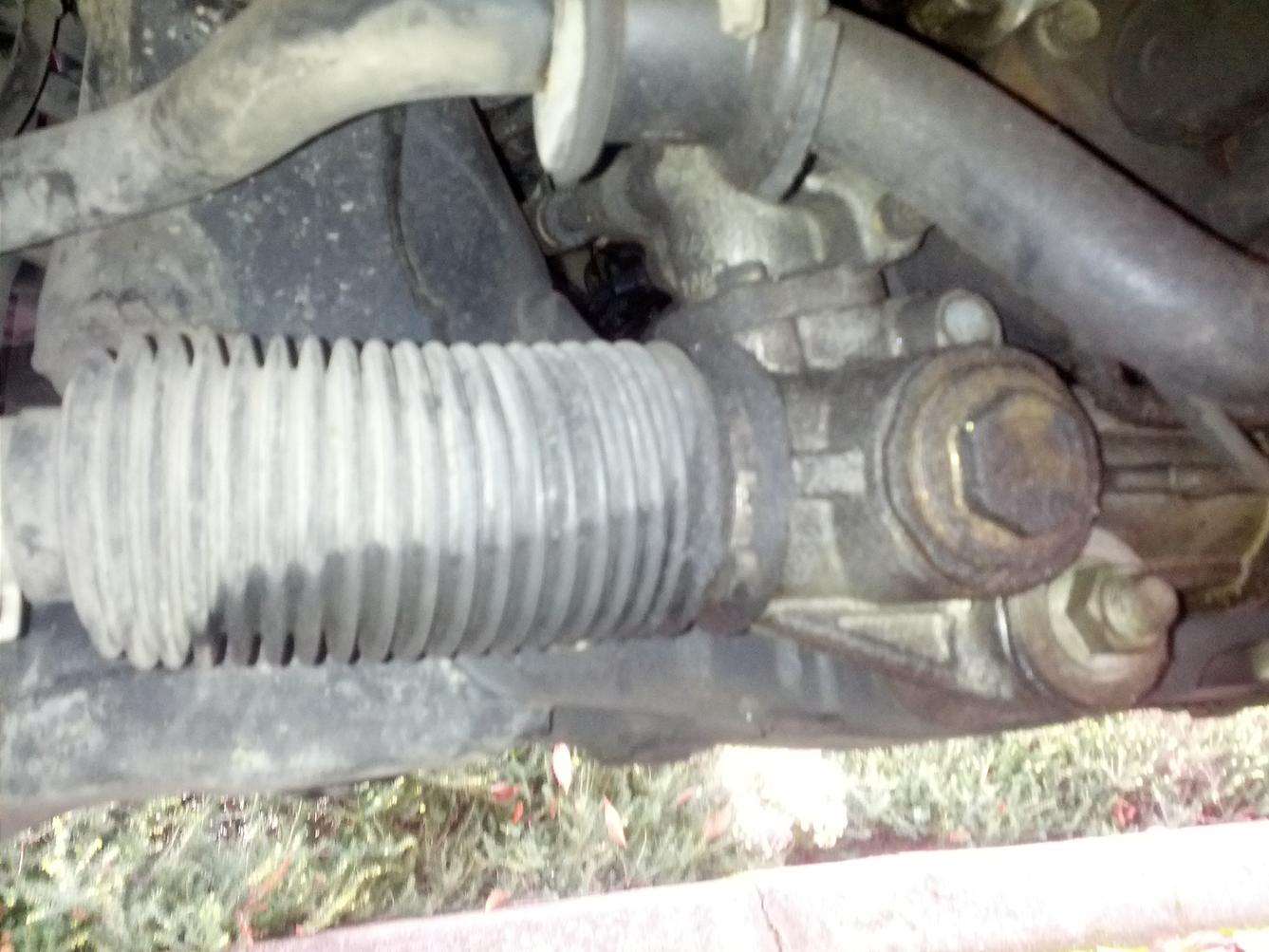

Drivers side - wheels where straight and not lifted off the ground, just parked.
Steering rack, bushings (oil on the underside of the covers?)
Tie Rod Ends
Sway bar bushings
If you seen anything I should look at or take a better picture of, please let me know. Thanks!

A few things that can cause the front end to wander/push/pull:
*Bad Ball joints (lowers are known to fail at 180-200,000 miles)
*Bad steering rack bushings, replace with poly
*Bad front control arm bushings
*alignment off

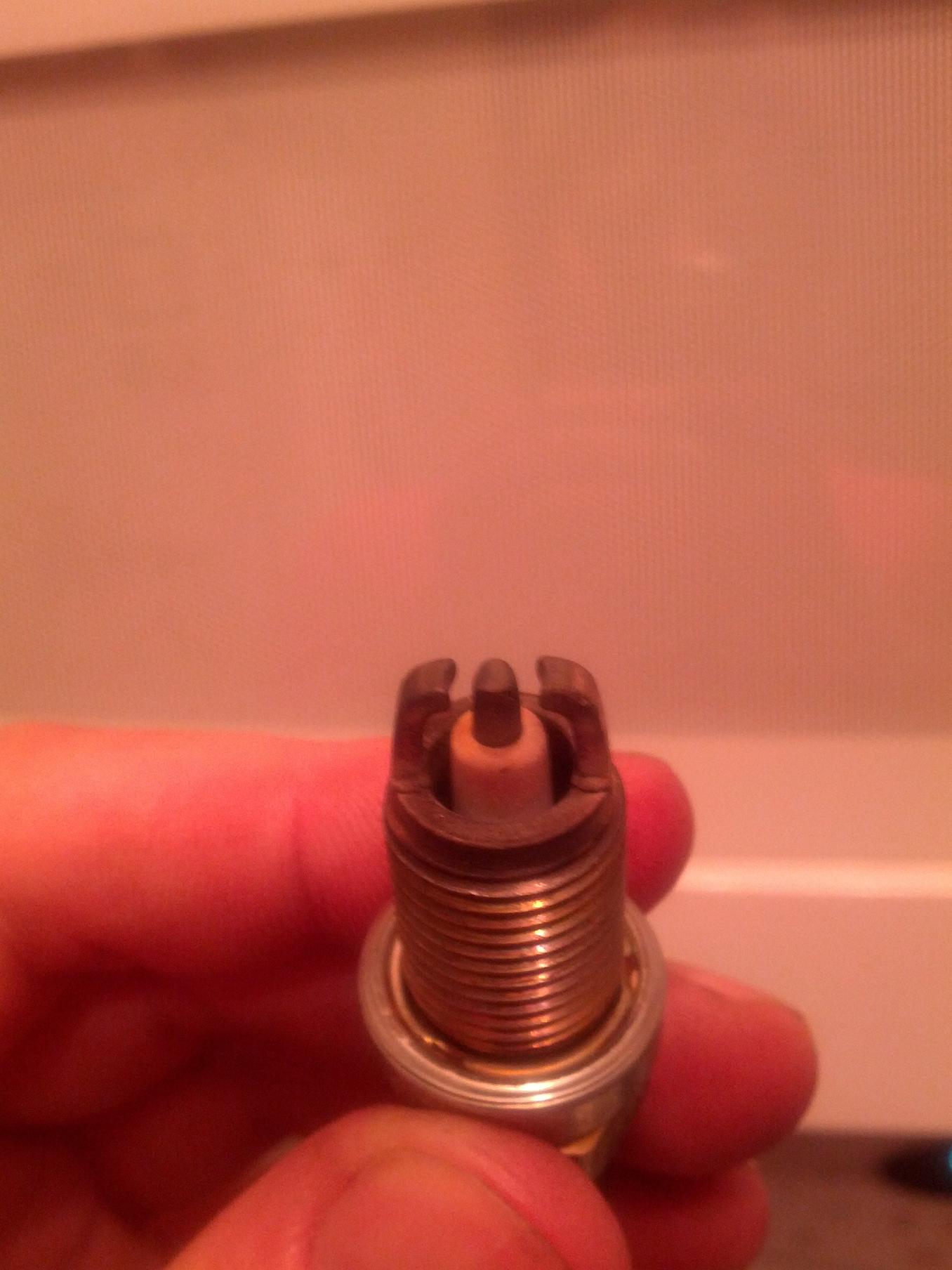

Changed out the spark plugs. Here is a picture from the old ones.
Looks like the rear main seal might be leaking :(
Plug looks normal.
(Joe Dirt) Oh dang!
What would give the indication that the rear main seal is leaking?
Wold the rear main seal leak onto the steering rack? Searching has found that it might be.
In the pic of the steering rack you can see oil around the front of the transmission on the bottom. Yeah it appears to be getting on the rack too.
Try to pinpoint the source of that mess.
Honestly man, the poly bushings are not something I'd tackle without much experience. It'd be hard to mess anything up, but when my buddy and I did mine I was blessed to have him there. It would have taken me all day. He knew what he was doing, and still had a few issues.

As per your pics:
Looks like the main seal is leaking.... mine is similar. My valve covers were also seeping, so I re-torqued. I'm just keeping an eye on the oil levels---- I'm using less than a 1/3 a litre a month....
I plan on replacing my ball joints, tie rod ends and next spring, struts/springs. As per your vid, your rack bushings are done. I also have noticed some wandering on mine, but it is not pronounced--- yet. A condition of my purchase was replacement of the inner tie rods ends (PITA) and 4w alignment..
You may want to consider checking the rear diff breather... this is a common cause of seal failure. I had a rear axle seal fail within 6 mo. of purchase, after a long road trip(pressure/heat buildup in diff??) (failed at approx. 120k miles) and lots of others here have experienced the same. Its a known weakness of 3rd gens. Still, 14 yrs on an axle seal is still great!

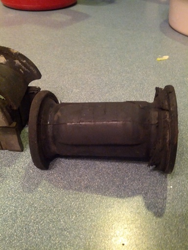

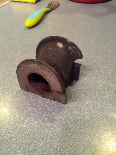

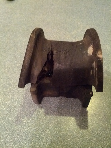

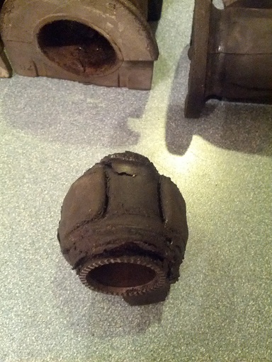

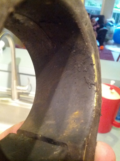

Steering Rack and Sway Bar bushings replaced
Here are some pictures of the old bushings. :gun5:
Steering feels very nice. Still feels like I am driving a boat and still pushes to the right but it doesn't have the extra slop in it. I'm bringing it into a mechanic on Wednesday to look at the lower ball joints, lower control arms, and general suspension. See what they think and go from there.
