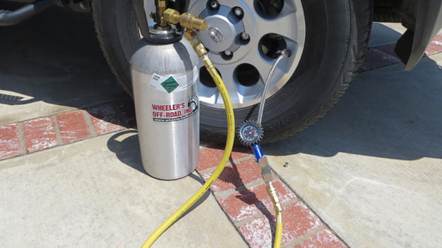

I started with a small compressor and got tired of 5+ minutes waiting by each tire. I made a home brew CO2 system for half the price of a Powertank and now my fill times are 30 seconds per tire from 15 to 38 psi. It's funny to see frost on the regulator and hose fittings on a hot day. The tank does not get hot in the T4 when driving due to using the A/C. When parked I keep it shaded or covered and have not had any problem even in the Arizona desert. If the relief valve blows, just open all the windows and get out to let the CO2 clear out.
I have had a nuisance with the CO2 slowly leaking out and have to check my tire pressure every few weeks to keep it correct. Without CO2 I have had no pressure loss. Due to this I may want to go back to a compressor but with a big ARB or VAIR for shorter fill times. It will still be way longer than a CO2 system, maybe 2 minutes per tire.
