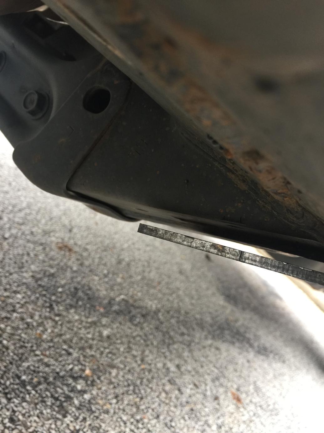

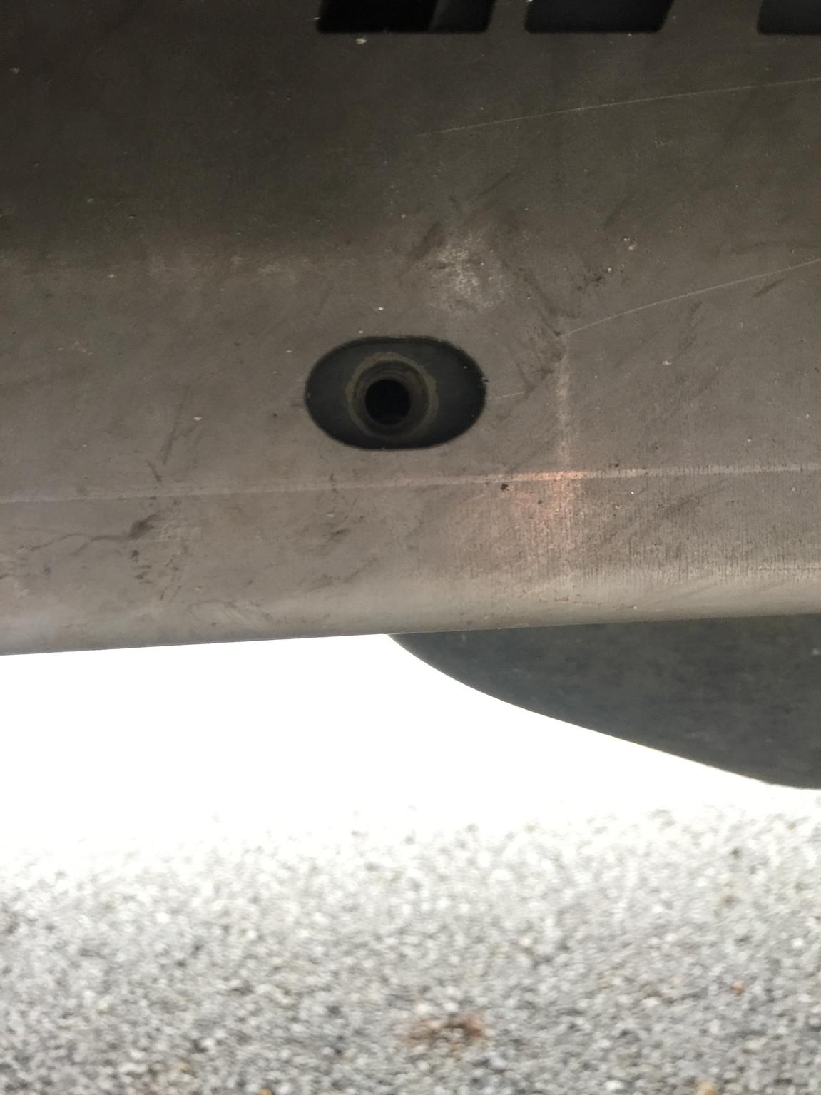

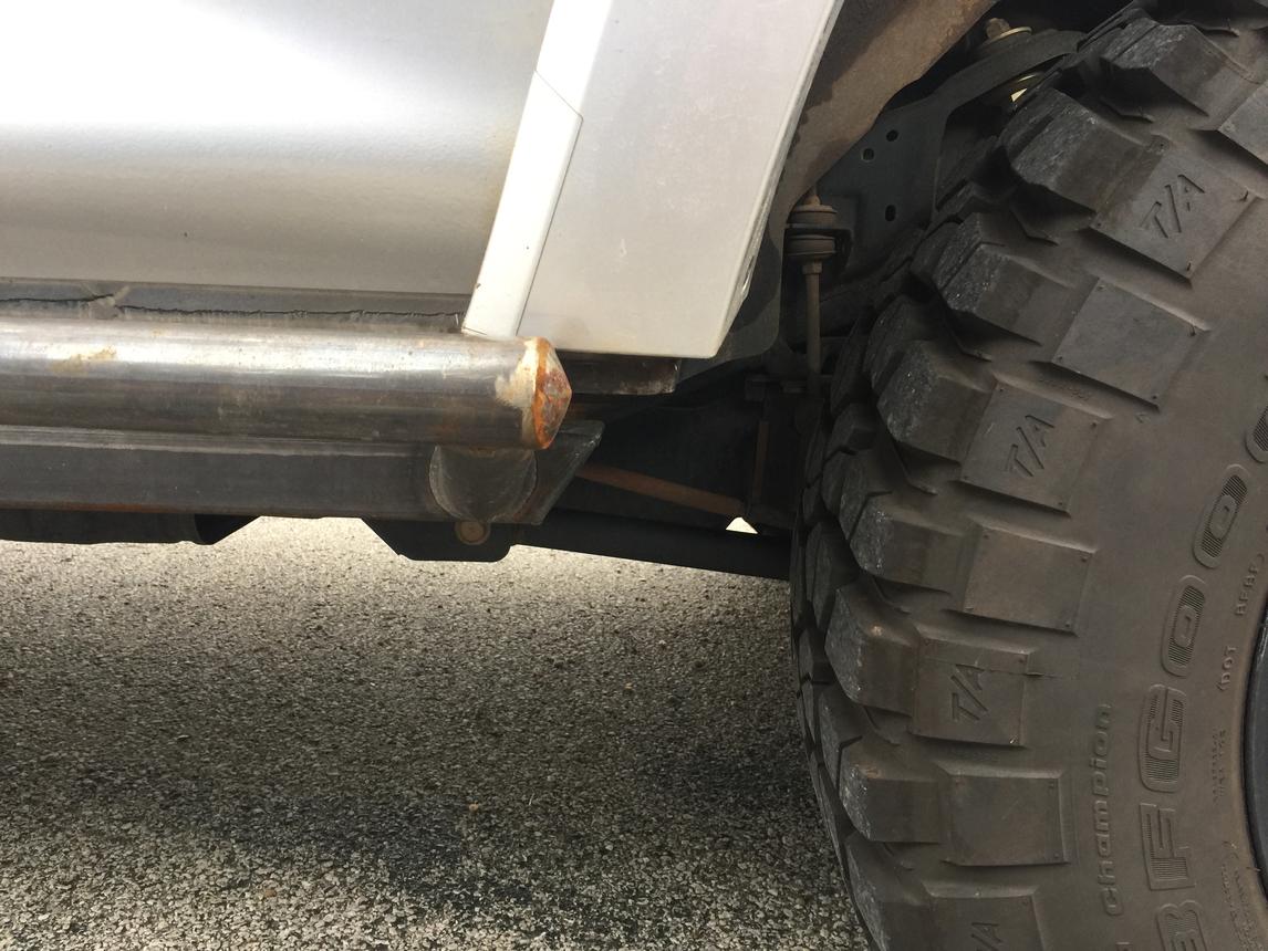

I have my driver's side bolted on with only a couple of bolts, but it looks like I'm going to have to trim my rear door trim in order to open the door. I didn't see anything mentioned about this for SR5's?

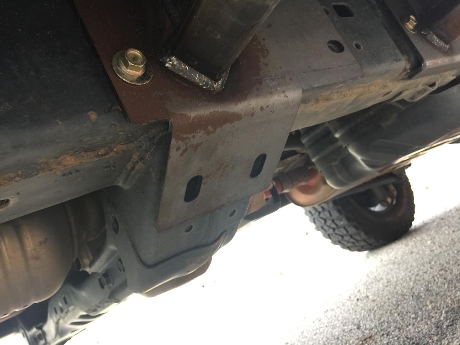

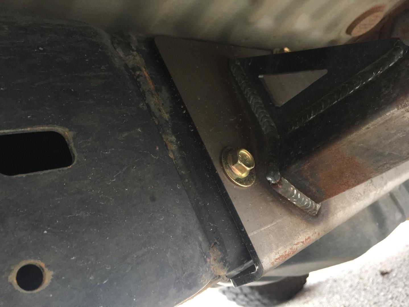

Also, it looks like at least on my driver's side so far, there's a pretty large gap between 45-ish degree angle and the cross member. Is that typical as well?

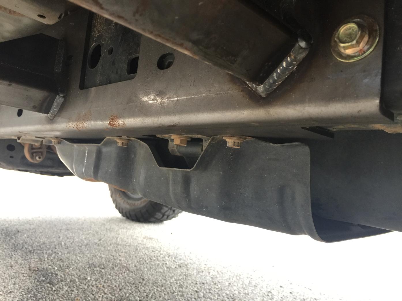

you need to drop the 3 bolts on the gas tank skid per the directions so it will allow the slider to drop into place.
and the slider is above the skid - sandwiched in between? Pics would help too.
Here's the overlap. It's actually not impossible to open the door (found out the hard, accidental, way), but for a permanent mounting, I'll need to trim it.
Gas tank skid. Looking at that one frame hole, it could probably come down some to make it fit, but then there would be a gap between the skid/slider and frame at the bottom?
Gap up front by cross-member.
This is the bottom second hole from the front. Looks pretty centered, but I have the gap by the cross member.

The only answer I have is to unbolt all but 2 screws and move it around until it is square and close to the frame. I had the same issue and it took a few mins of moving around until it aligned. I also choose two screw holes that would not impede lining it up correctly. Try getting a couple friends to hold it in place before bolting as it would be really hard to think these were welded out of spec.
Installed my sliders finally. Powder coated the main part of the slider matte black and the top plate with a wrinkle finish.
Since I was the only other V8 4th gen to order a set and there is apparently a difference in cross member placement from the V6. Not a huge deal.
Caleb @ C4 was awesome and more than willing to accommodate any solution I wanted to fix this problem. Since my sliders will actually bounce off of rocks every once in awhile I chose to weld the front part to the frame. TaDa! Problem fixed with no extra cost to anyone.
